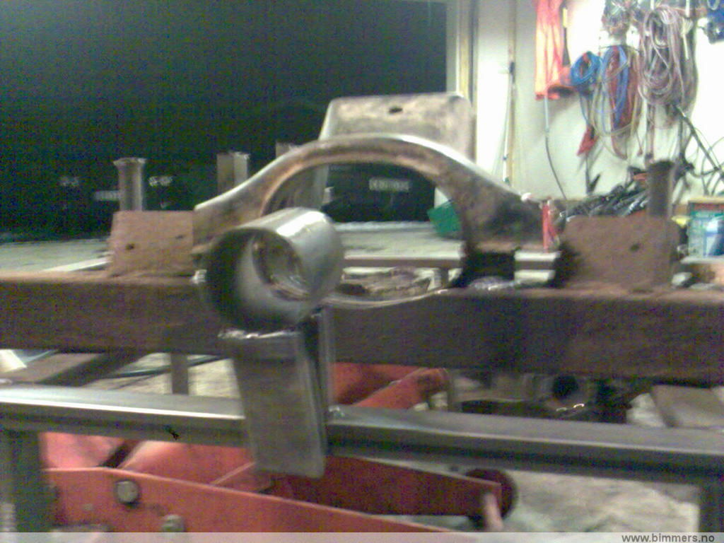

This e30 conversion i finished long time ago,i start making another one today. I just have go get a hand on an e30 subframe to fit in the e21 sub.
I have made this conversion on 4 cars now. All of them here in Norway.
I ran 380 bhp on my old blue e21 with m20b25 turbo with this conversion,works perfect. But with that amount of hp i use an e30 m3 lsd 3,45. Never had any problems around the course or streetdriving,drag etc.
I will take more pics this time then,there`s many wondering about this conversion. It`s no problem doing this at all. It is maybe a little problem when fitting the car. But i can take pics of this as well,it is not me who`s mounting this. My own car is finished,a friend is finished,and another friend is now gonna mount it on his car with my help. And the one i`m making now is to be sent away along with driveshafts.
