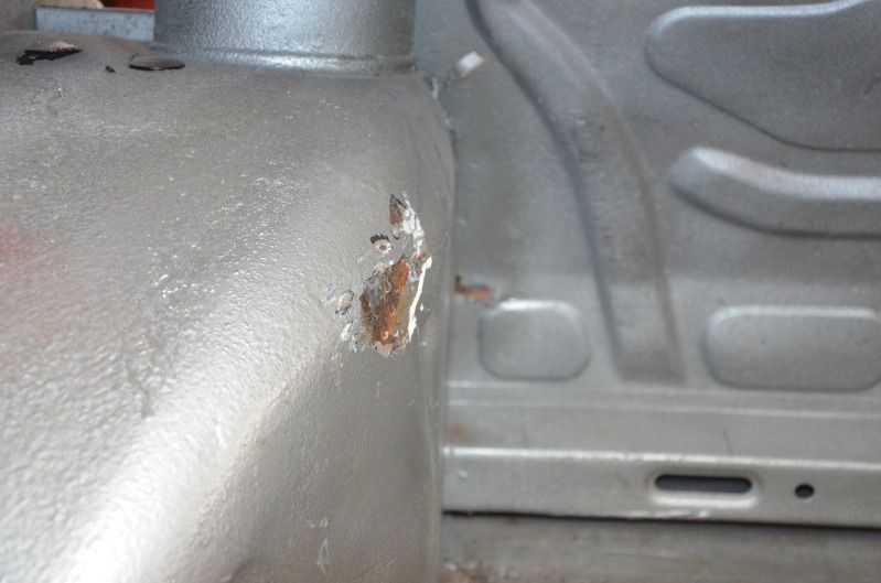

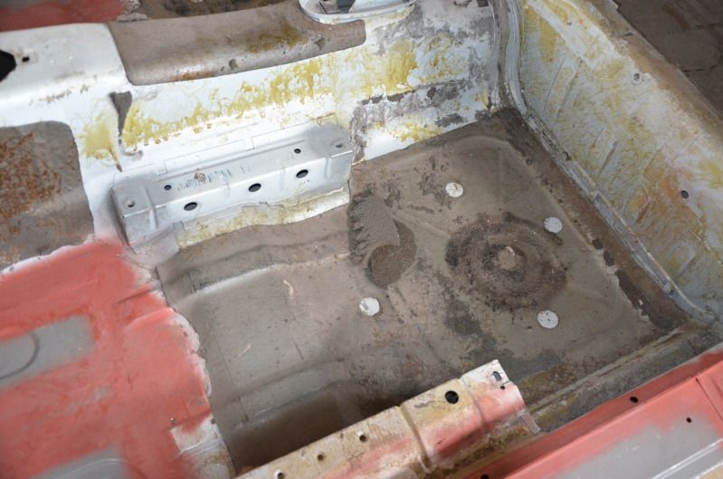

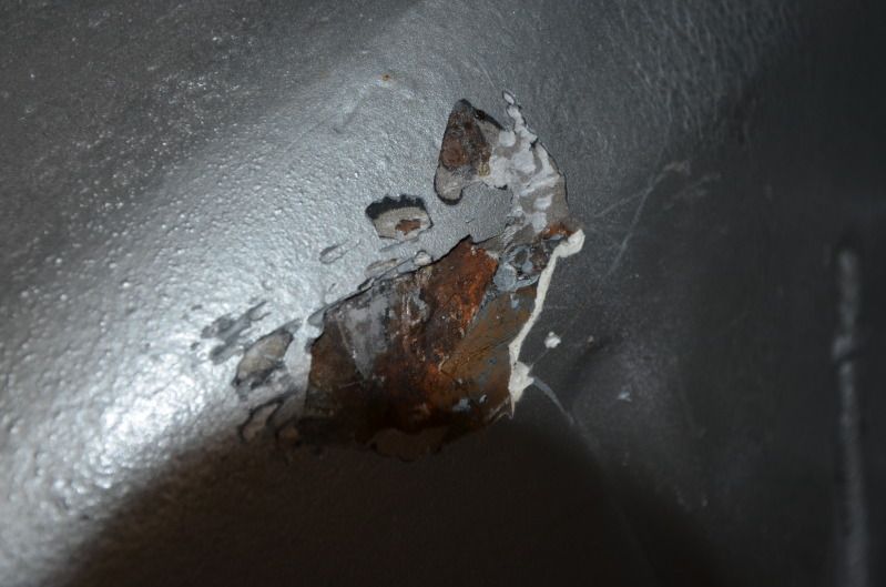

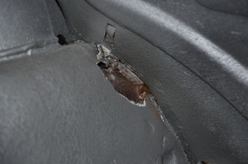

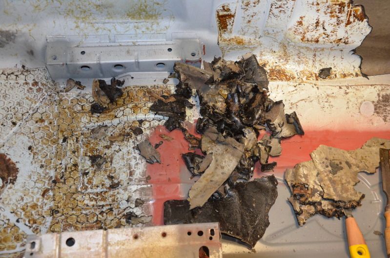

I finally made a start on cleaning the shell. Started to get all the insulation out, and I am bound to find some rust and holes, I think. The more I can find and repair before sandblasting, the better it is. After the cleaning up, getting rid of filler and putty and crap like that. I will have the shell sandblasted and coated in epoxy.
So what did I find on the first cleanup?

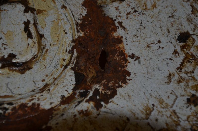

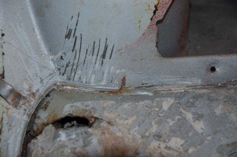

Rust! Under and around the floor caps. I expected that already, so got the donormaterial already!
In the enginebay it looks like a big, thick layer of filler. From a distance it looks all nice, but on a closer look…. Oh ooo….
And some junctions, seams.…
I will carry on, but, sandblasting is very much needed…

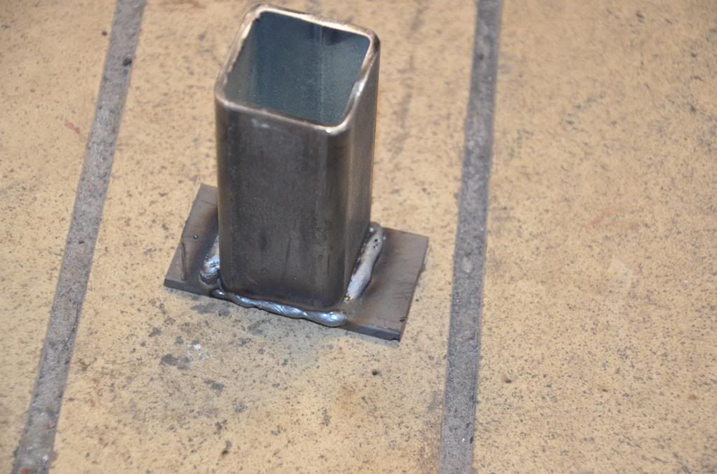

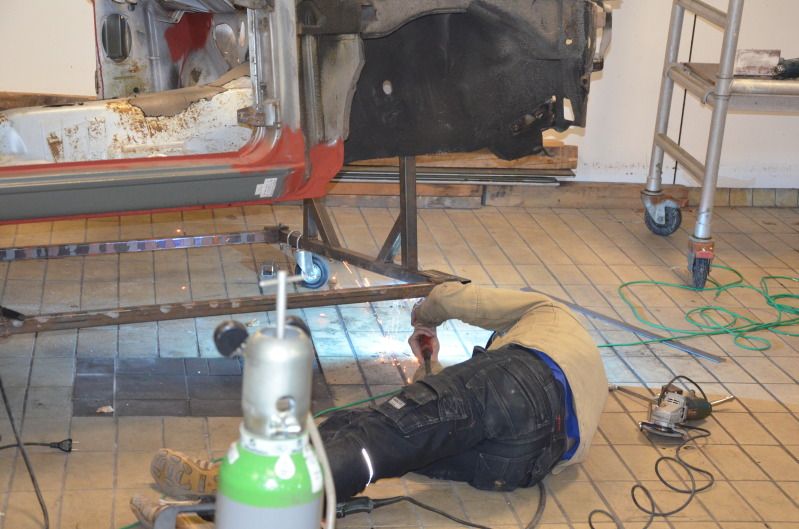

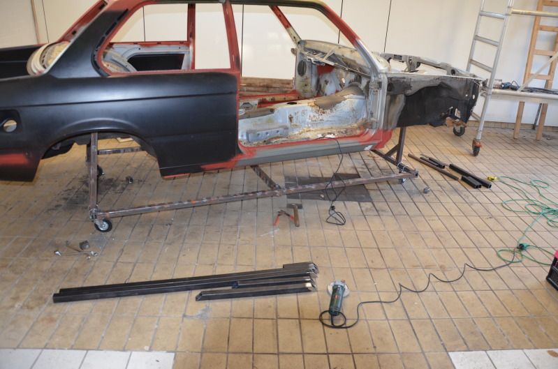

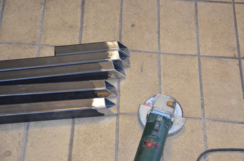

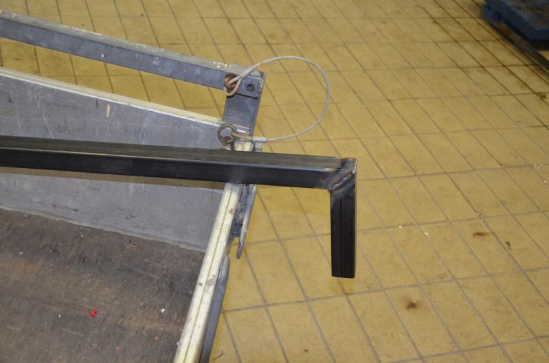

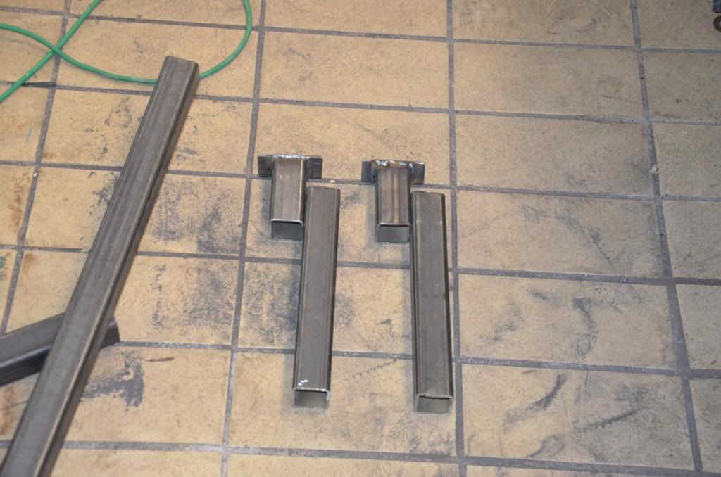

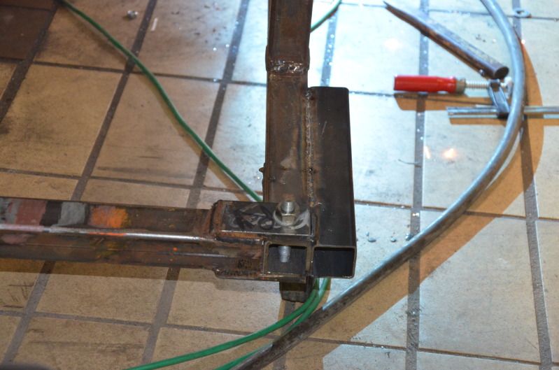

Last week I collected some steel bars to fabricate the turning supports for the chassisframe. Arnold D. helped to weld.
First I cutted the parts to size:
I want to flip the frame both ways, so left and right on the supportframe adapters need to be welded.
Welding laying down...

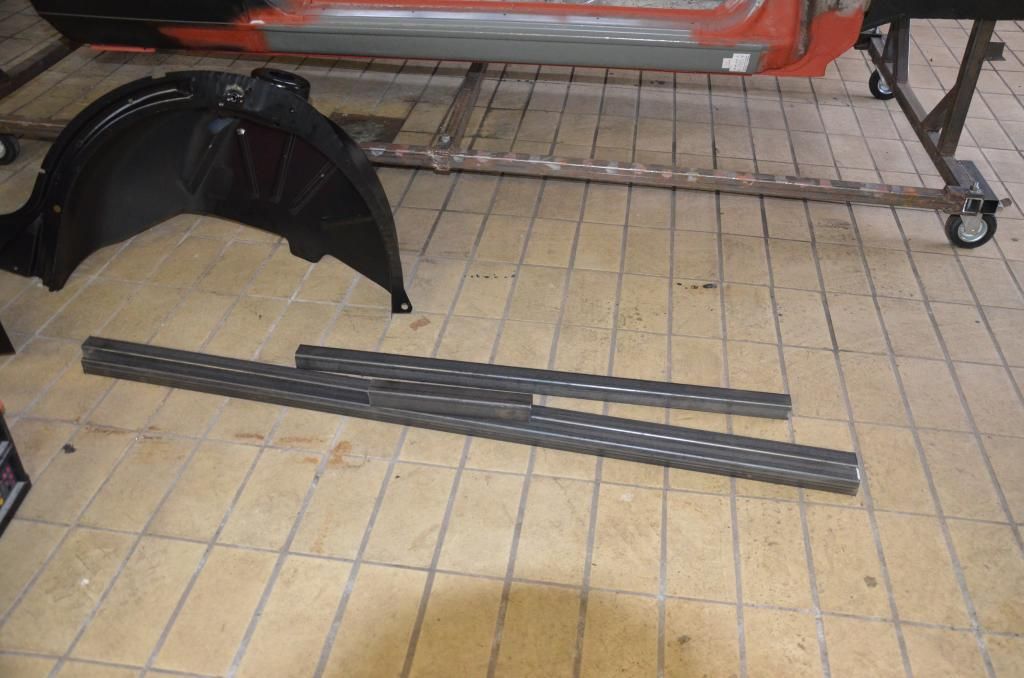

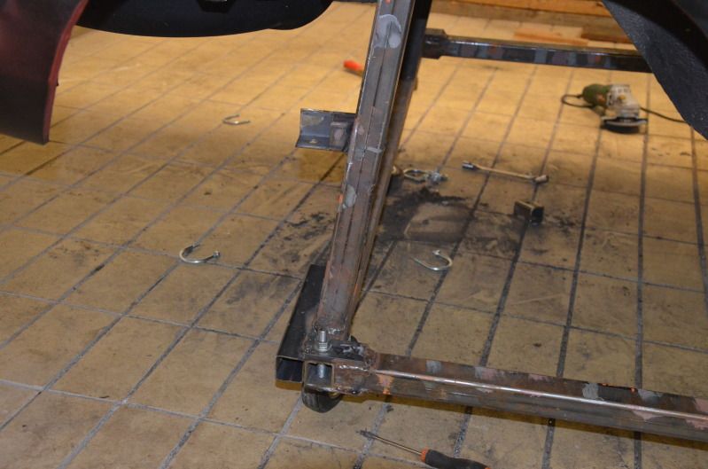

The outer bar holds the sidepillar, the angle holds the supportpillar. Nice big bolt and everything is secured.

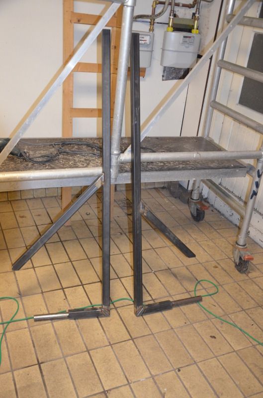

And the sidepillars:

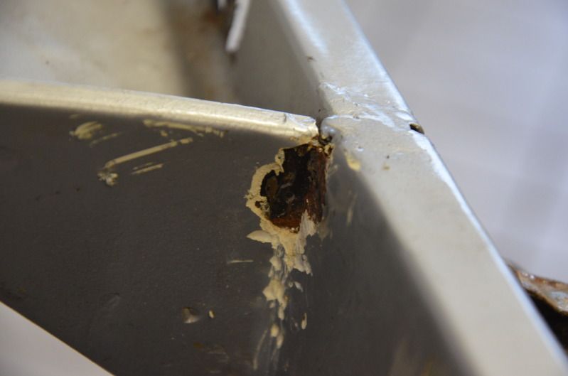

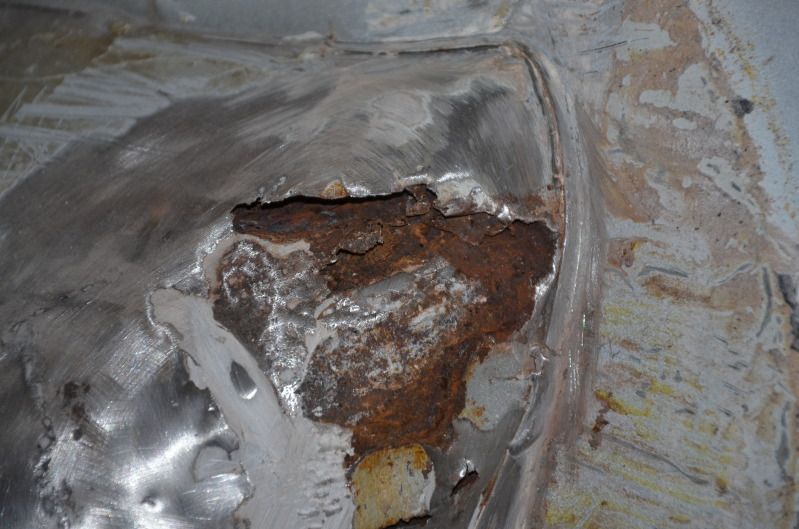

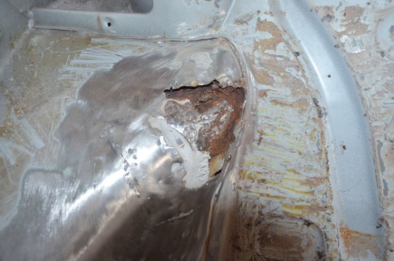

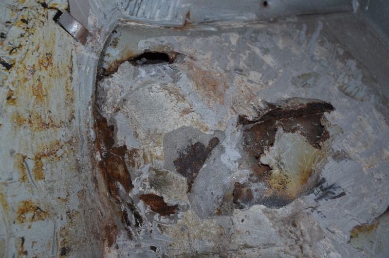

And…. I found rust and holes underneath 5mm of filler on the wheelhouses inside the car. Will have to grain that down to find out what the real damage is.

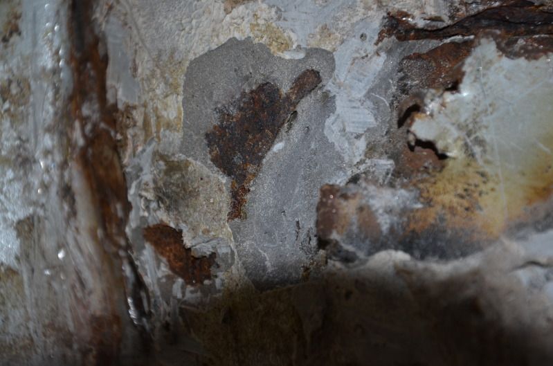

Right side wheelhouse, on the outside, underneath a patch is welded in, but the rot is on the upper side. What to do if you are a BWM Restorer with a big name? Just hammer out some rust and smear it with filler. Done! Right? WRONG!! :wtf
Left side: even more rotten.. Bigger holes, they even run behind the separation head to the boot.
Is this “rustpreventing filler”? Rust all the way to the back…

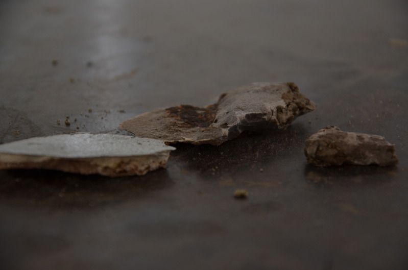

Thick layers of filler. So I took a hammer and started banging away. No dents, all cracks… :hammer
Oh, did I already mentioned the fact that they used filler in my car? :bag

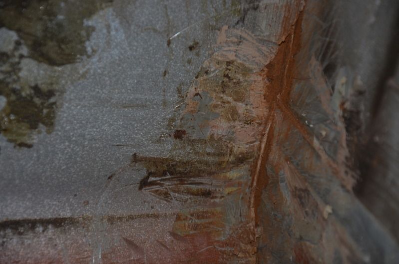

And here is the famous torsioncrack.
Ergo, one side is beyond repairs and the other side needs more investigation. I'm afraid that repairs won't help. It will take serious amounts of time and work, while the rust won't be taken out all together. That will lead to fast rusting of repaired parts. What to do, what to do. For now: :goodnight

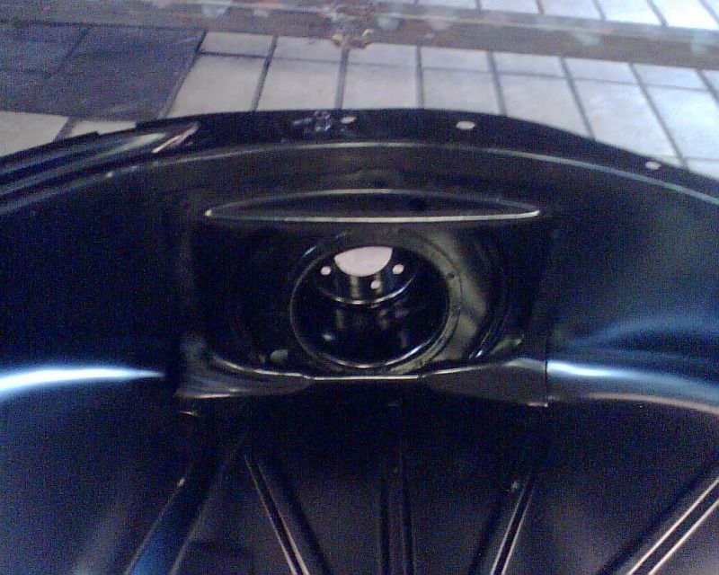

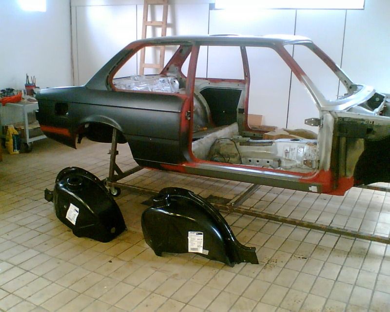

November 3th, 2012 Look what I’ve picked up at the dealers….
Bunch of crappy Nokia pics. This phone was hot way back in the past century:
Image,
In short: the game is on! Soon to rip big pieces out of my car….
Posts: 19042
Re: Uwbuurman: 1978 323i polaris ripping of the roof!

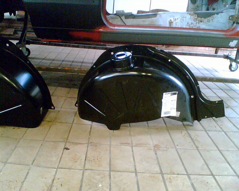

And just 6 days later, a call from the Glassgarage: The last brandnew popout widow I needed, from BMW :boogie

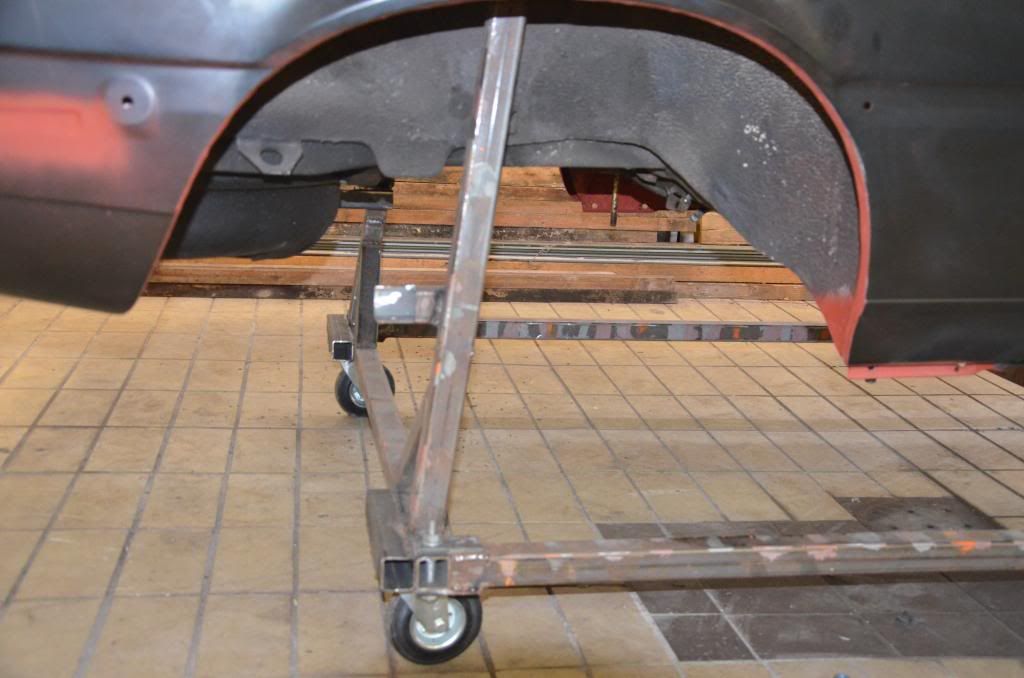

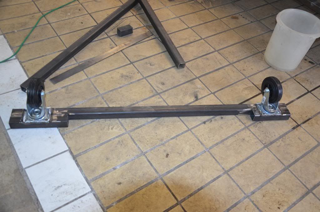

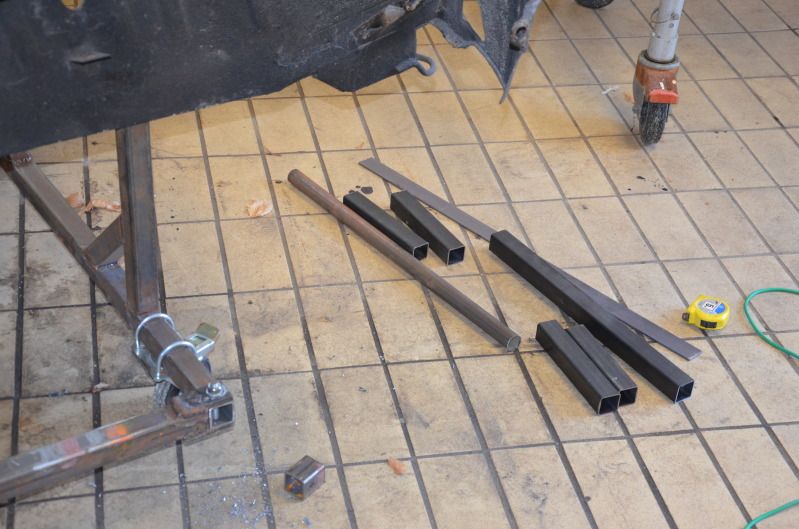

And I picked up some more steel bars to ajust the supportframe
Having to replace the wheelhousings, the supportframe has to be changed. As it is, the car sits on it at the rearshockmounts in the wheelhouses. I need a new spportpoint…

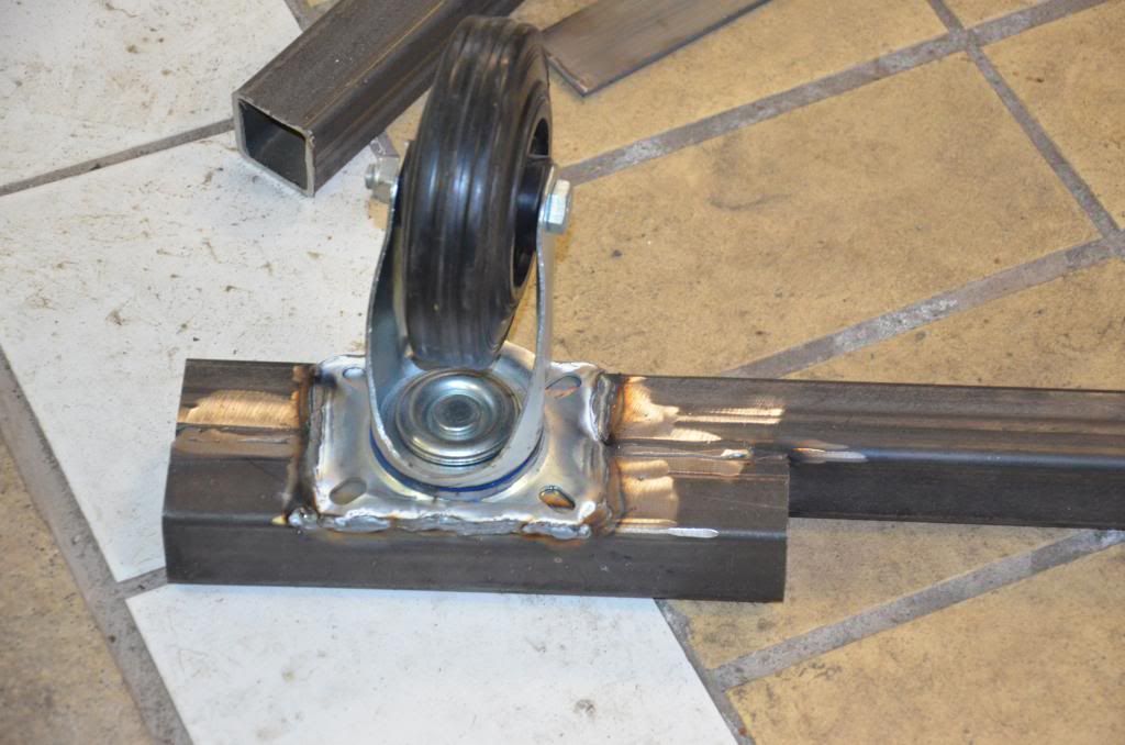

I bought a new weldingmachine, on the steel bars I can practice, before burning up my car….
Left is the second attempt, little more CO2 and wire.
New supportbar with wheels. This way I can change them back lateron.
These parts need to be sorted and then I can finaly go to work on the car again.
