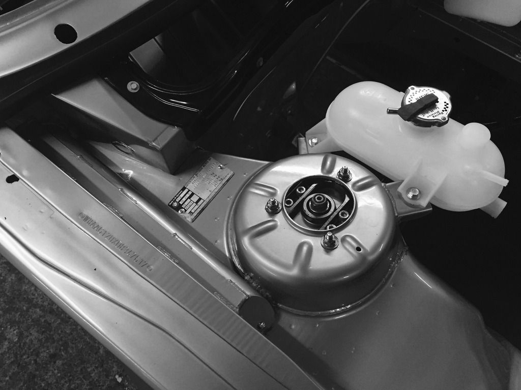

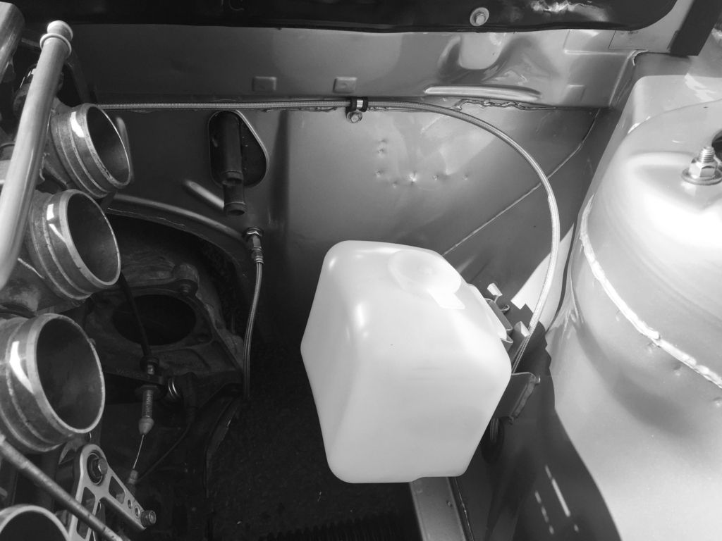

looking so sweet mate
even new washer bottle n header ,very nice

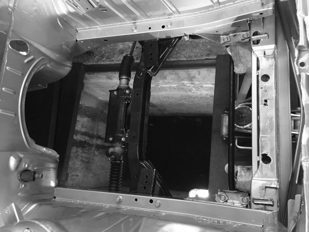

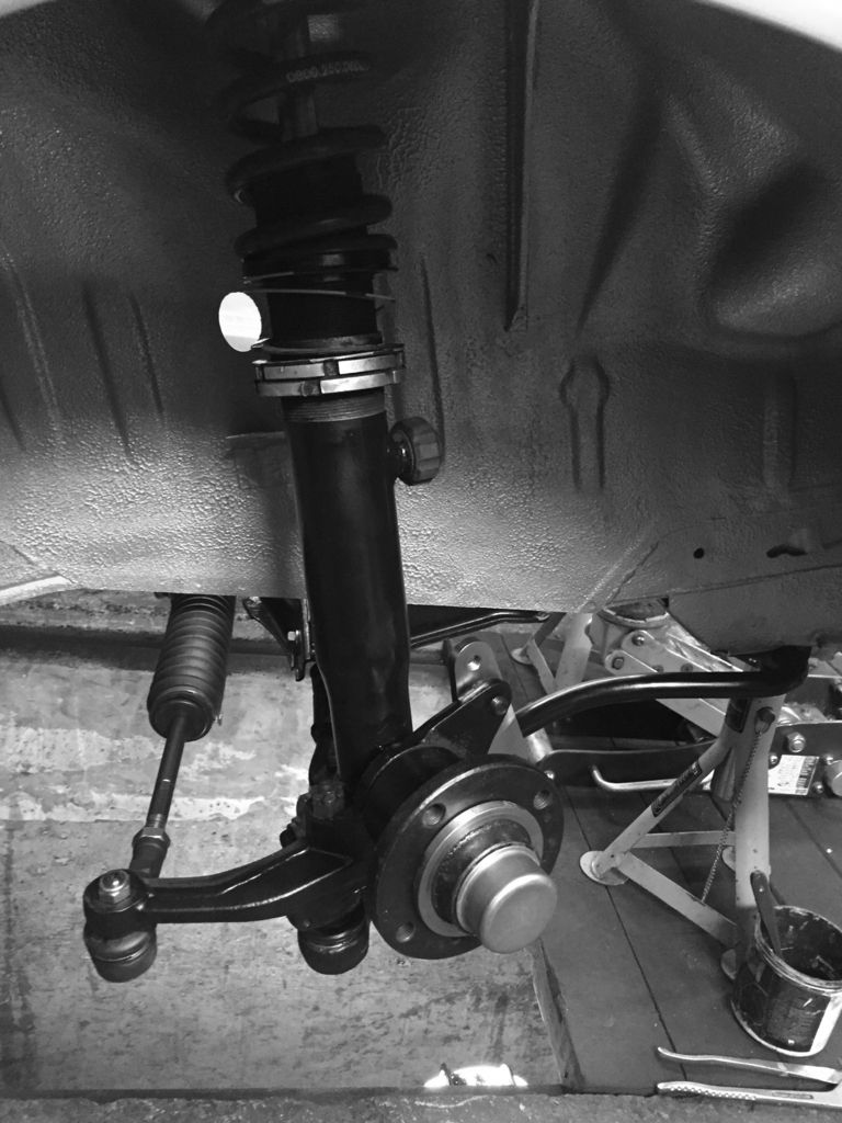

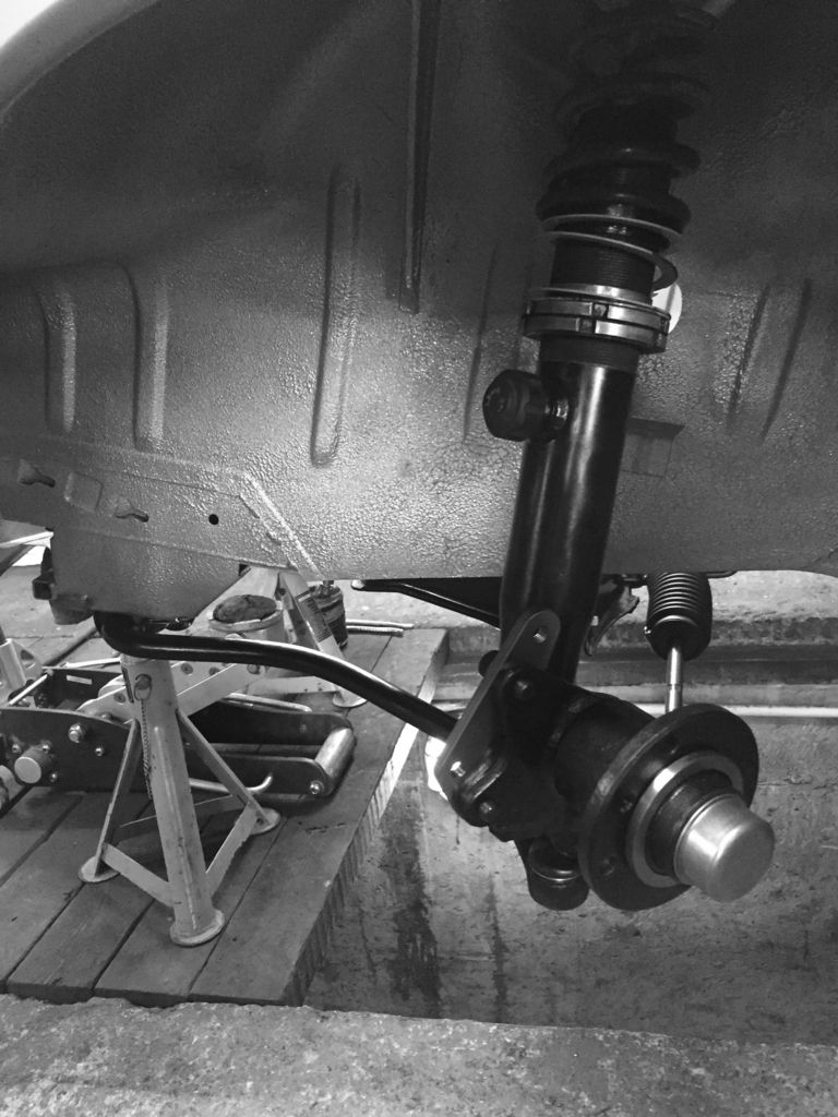

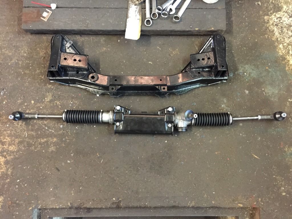

any idea about the steering joint position?
http://i180.photobucket.com/albums/x19/ ... G_2295.jpg
we all have the low ET problems despite that we all have enough space on the inside of the arches. Still thinking how to move, turn around, reengineer the position so a ET25 wheel can clear the ball joint? Any ideas?

Thanks Cromacroma_man wrote:any idea about the steering joint position?
otherwise a great build and the B&W photos make it nostalgic
The main issue I can see is the location of the steering rack and lower arms, easiest option may be to try and fabricate and fit an E30 front subframe setup. Quite a bit of cutting and welding required for that.
Also one of the nice things about the E21 is they like low offset wheels which means you can have some good dish
Ben

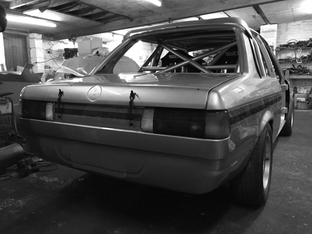

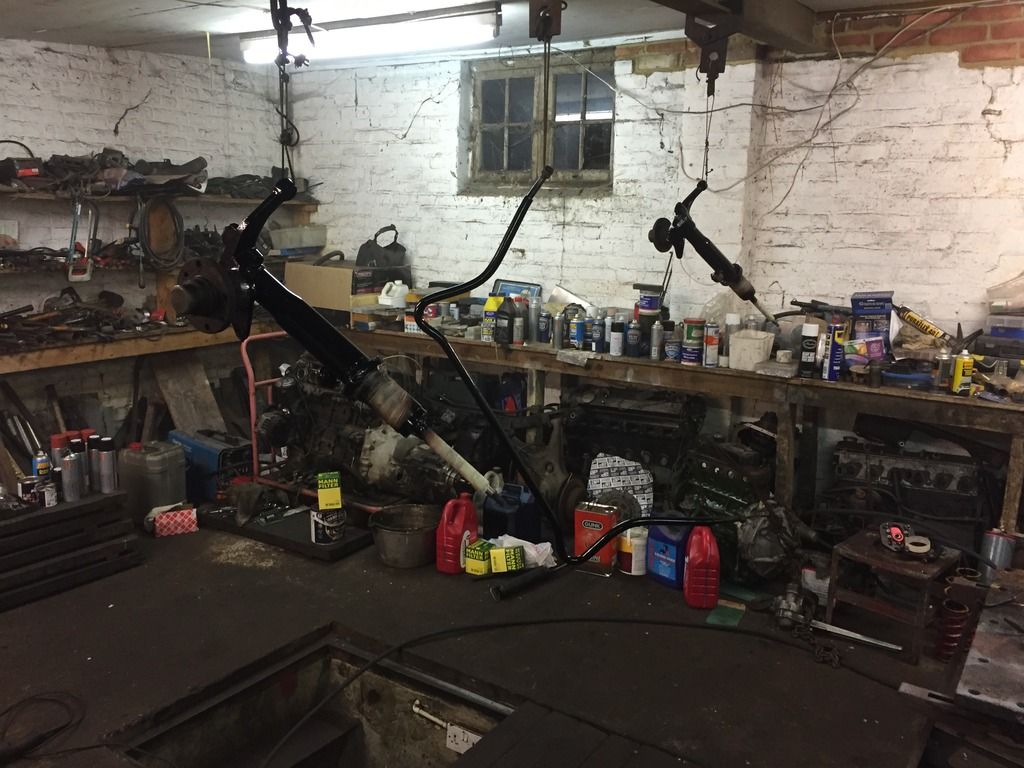

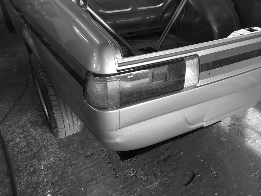

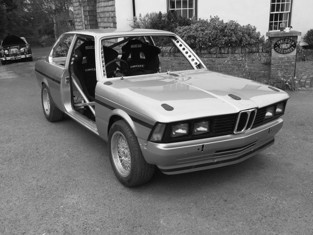

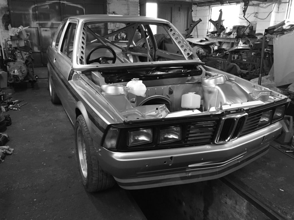

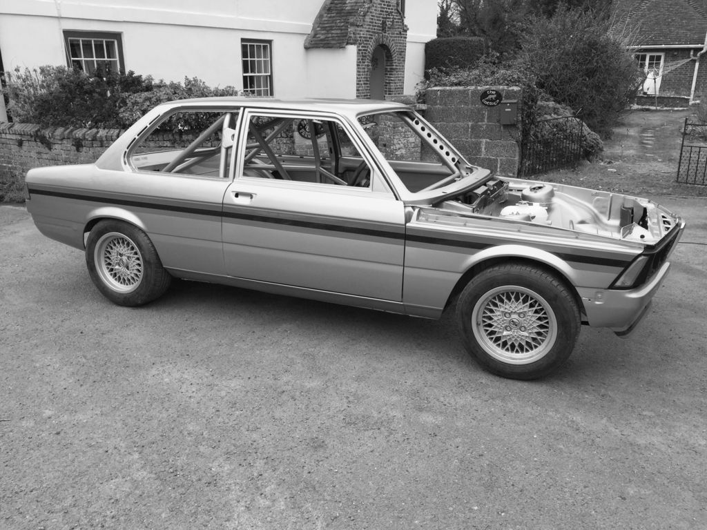

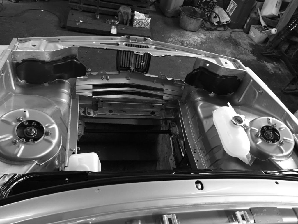

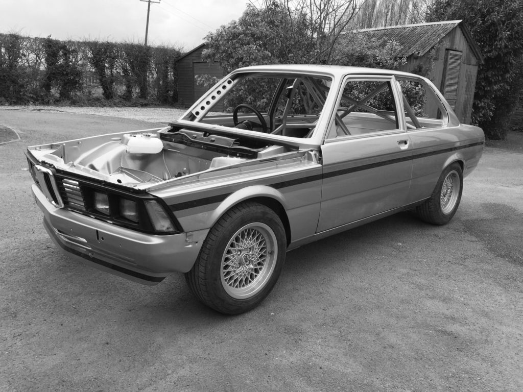

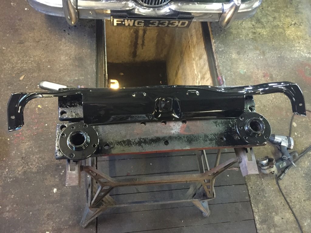

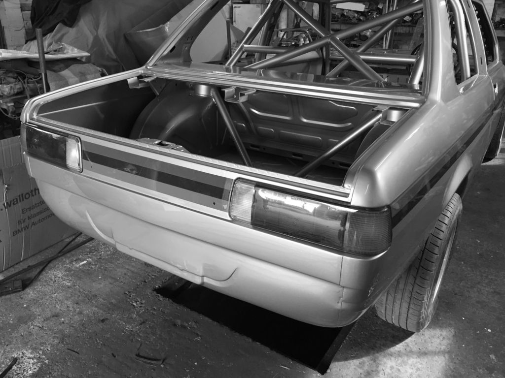

Bit more work done last week.

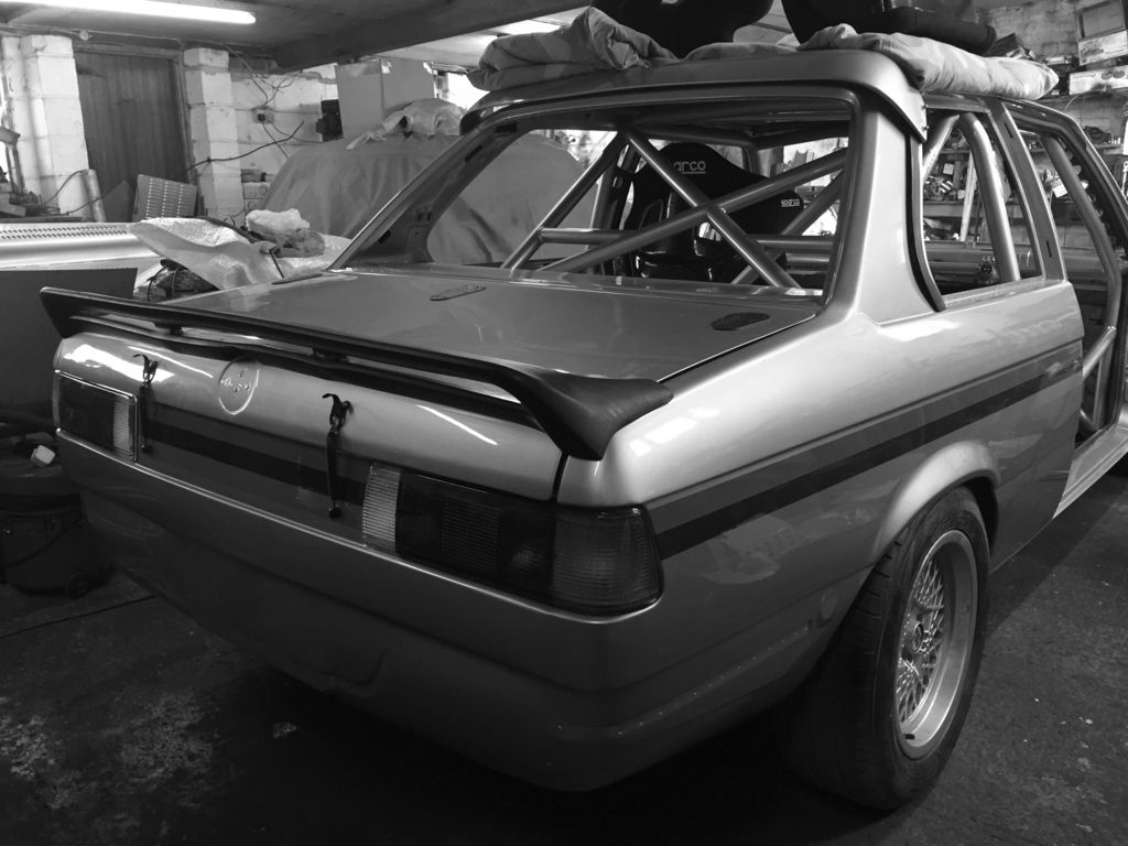

Removed the doors to prevent any damage during the build.

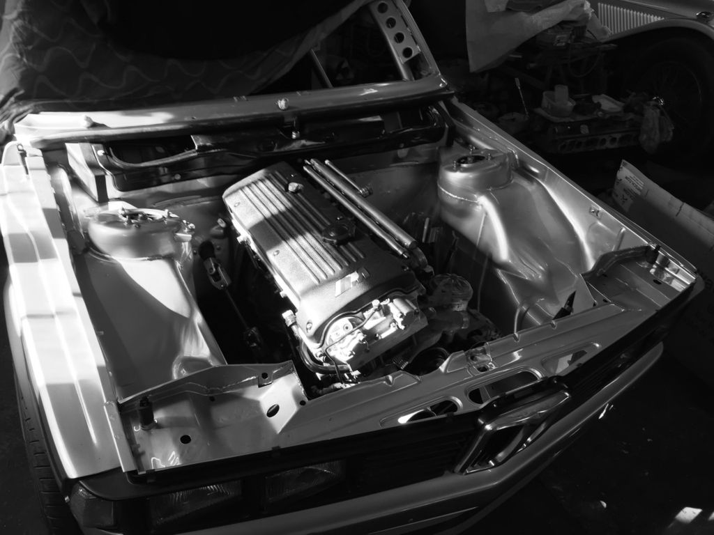

Got the bonnet, boot lid and roof spoiler fitted:

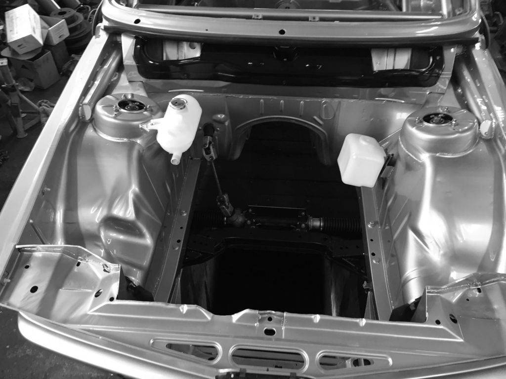

Cleaned the engine and box replaced the gearbox seals and linkage bearings and fitted the engine & box:

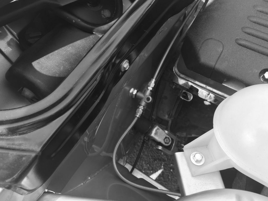

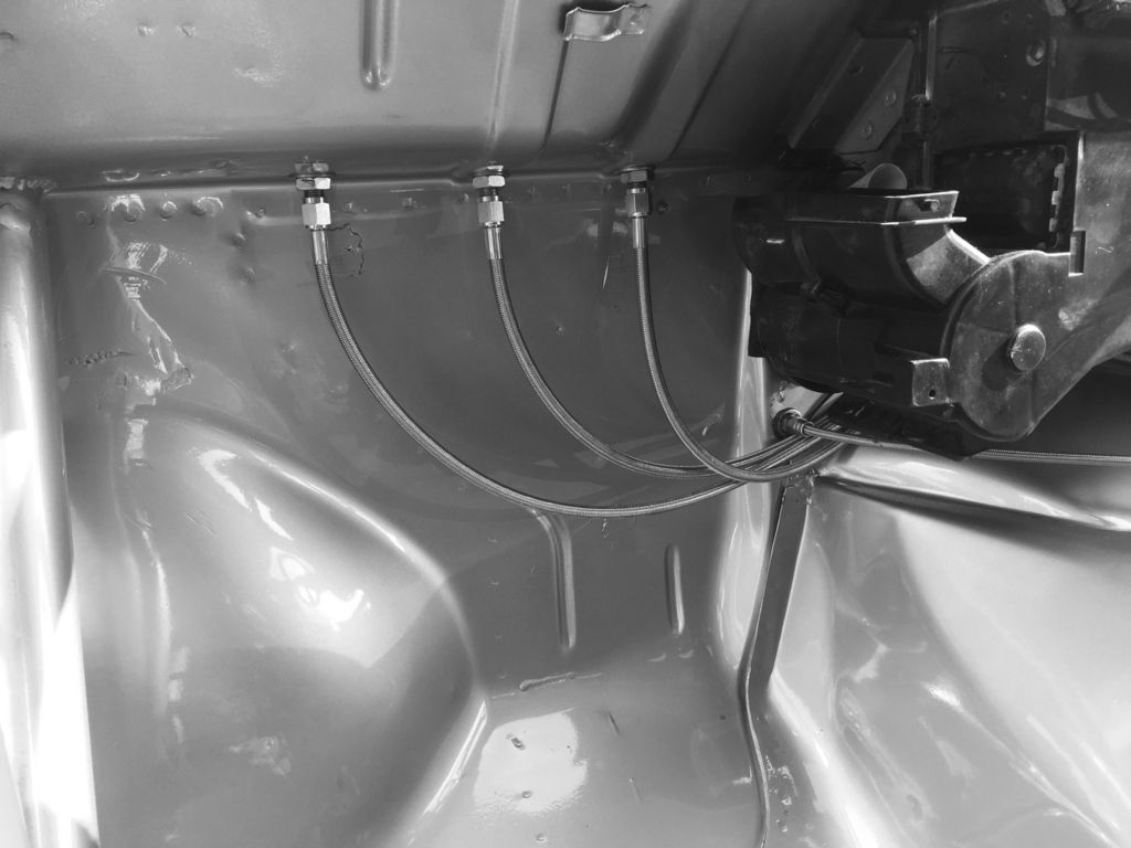

Then worked on the brake/clutch reservoirs and all the brake lines:
Fitted the rear Zender spoiler:

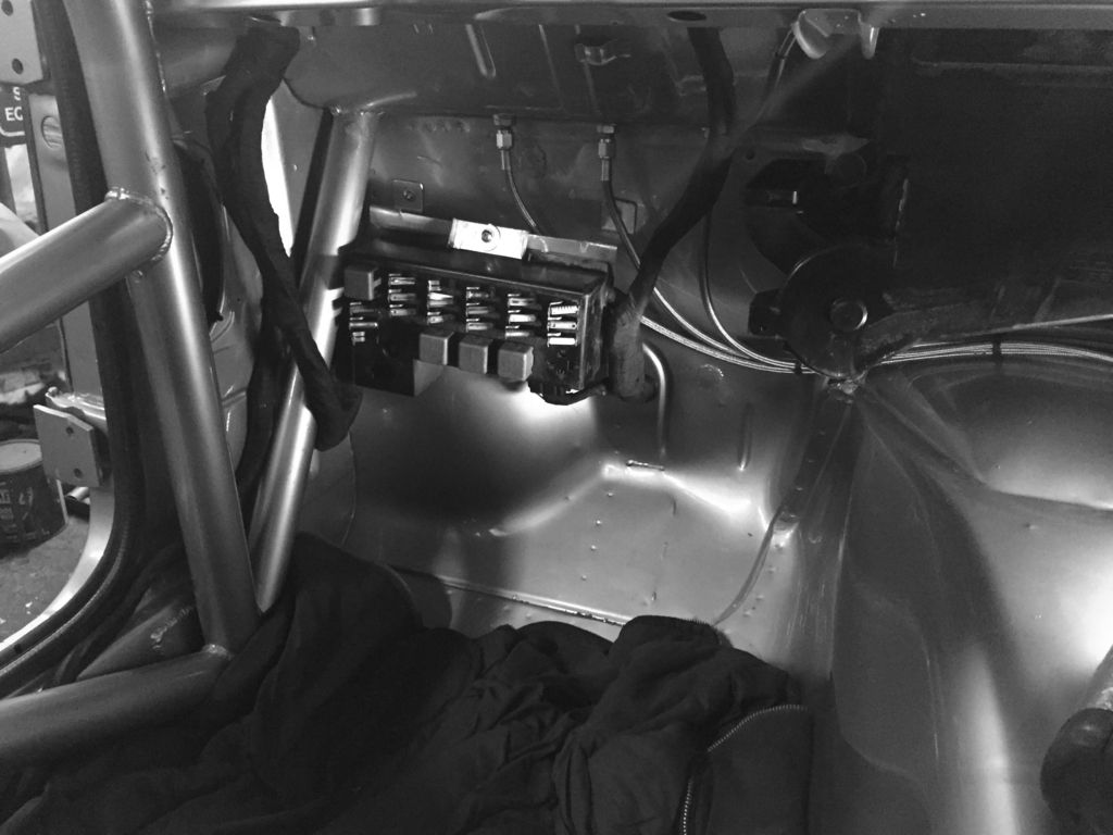

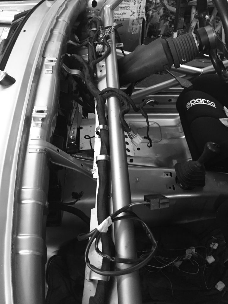

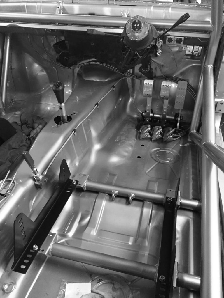

Then spent some time re-wrapping the loom and fitting the fusebox inside:
More work happening next week
Cheers
Ben
