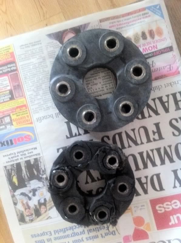

Quick update. The Euro car part (top on pic) was not even close in size and that's the smallest they do. Described the perished one to C3 BMW in London and they were able to sort one out for £31. I asked if about the quality and the guy said he's had the same make on his E30 M3 for four years and still works as sweet as a nut.

That's too big indeed
and the other one's quite dead, glad it's sorted now.
