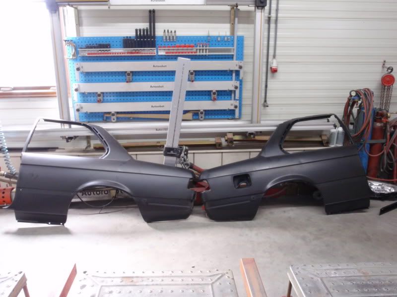

does anyone have any pictures of how to replace a complete rear quarter panel

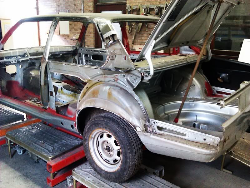

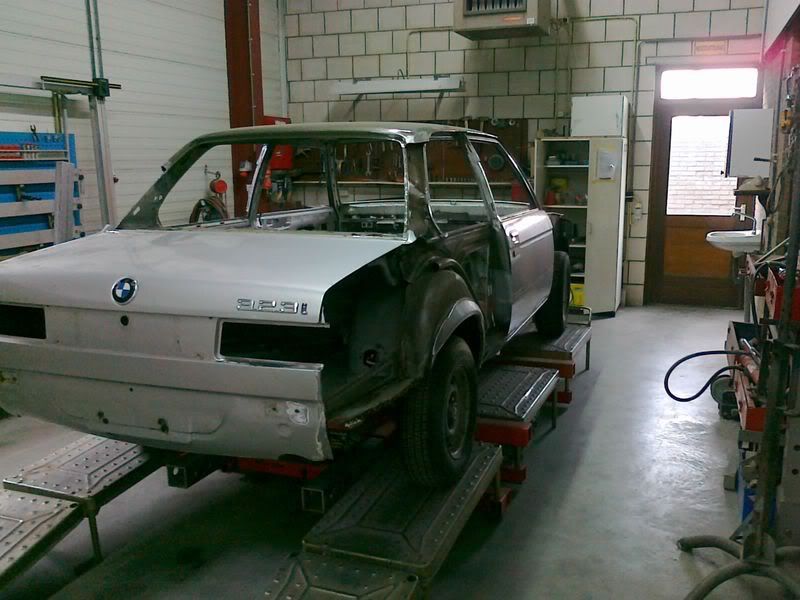

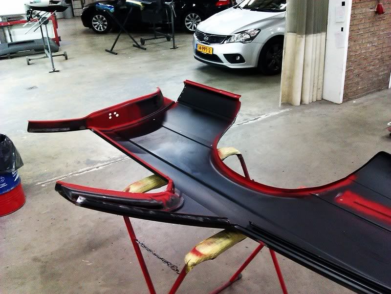

Yep, I take it that you mean from taillight to door?

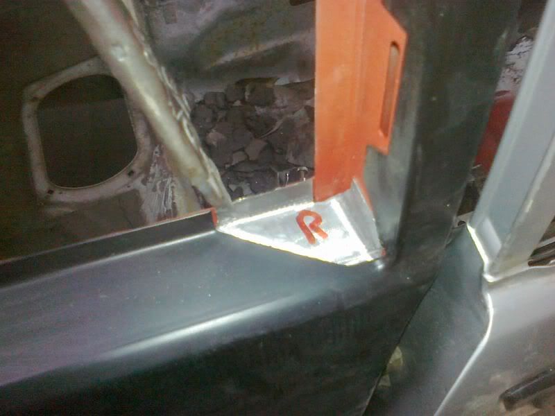

Orange parts are where it's spotwelded. only thing, the little cornerpieces, where the e21 always rust, are not in stock any more. So you have to make those yourself.
More pics in my topic around page 36
