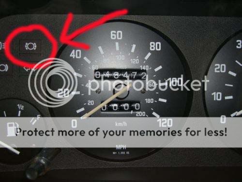

Dash board light what does it mean
LeeLee
Posts: 311
Joined: Thu Jan 09, 2014 7:53 pm
My E21(s): E21 316 1981
Post by LeeLee »
http://i1040.photobucket.com/albums/b40 ... 1/2e21.jpg it comes on sometimes when driving
Any idea? Thanks
Posts: 30218
Re: Dash board light what does it mean
Brake pad wear sensor, could be worn brake pads :wink: a bad sensor or bad wiring somewhere.
What dealerships have been doing for ages: if pads and sensor are ok, remove the bulb :?
polov8
Posts: 522
Location: Dronfield
Post by polov8 »
Mine flashes from time to time, but I think that's because theres no sensor and the wiring is bundled together with insulation tape. yours might be similarly "customised"
Andy
LeeLee
Posts: 311
Post by LeeLee »
Oh really!? Ok yuh it was and customised even further by my dad ripping it out lol :screwy
I'm gonna try and find it or remove the bulb so annoying,
should it come on when you turn the ignition key?
I had a a slight electrical problem with it not starting seem to have fixed it with a new battery though but to early to tell
But thought it could of bin related as it came on when key was turned
