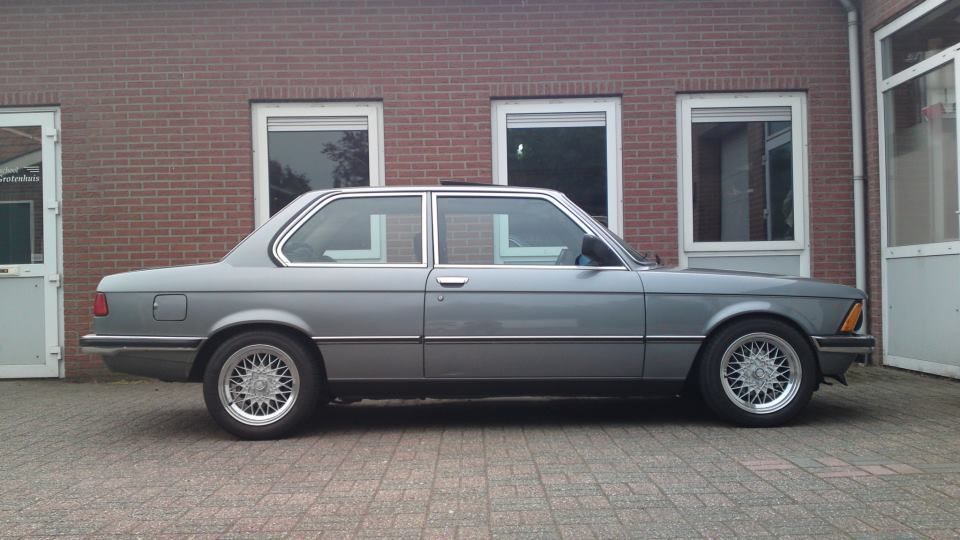

Re: Choice suspension set ?
I´d keep to the known brands like HR, Koni, SPAX, Eibach, Bilstein etc. I cannot reccomend TA Technix and those very very cheap sets, they are so incredible bad that it´s almost impossible to believe.
I myself are using a modded Vogtland adjustable coilover setup from a E39 (plug and play on the rear, need a bit of fiddling to get on the front). Vogtland are on the softer side but in a car that weigh in at almost 50% that of a E39 M5 they are pretty firm.
I have had great experiences with SPAX (adjustable hardness) in the past, and KAW springs.
Hello ! Thank you very much for your response! Clearly it is for sports use, the 320/6 is my self pleasure for the weekend! Actually I "fear" of the effectiveness of some lesser known brands ... Now there is a choice or eibach H & R, H & R lowers slightly more than I think? The front tires will be 195/55 and 195/55 or 205/50 in arrears so I hope not damaged my front wing ... And the choice B8 front and rear B6 apparently seems sensible in sports use, the back being lighter it is not really necessary either "hard", which could therefore save no comfort I immagine that this is not what is wanted! Do you have pictures comparison Eibach H & R and 15 inches?
H&R springs and Bilstein, 205/50/25 front + rear.
195/50/15 up front should be fine for your fenders.
e-einundzwanzig wrote:H&R springs and Bilstein, 205/50/25 front + rear.
Great !! I love when the nose plunges like that but I do not understand, I see regularly e21 with the back "down"? and combo spax hr demeans really top! eibach and also in the original wheel is really nice! thank you to comfort me for my choice, surely H & R.
