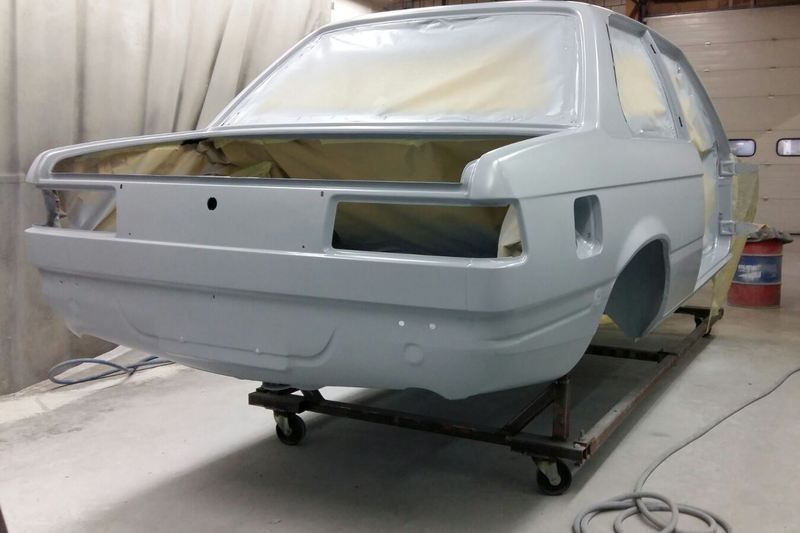

The type 1 versions have different rearlights, which have no space for a foglight, thats why type 1's can be equiped with an optional light, under the bumper.
Thats also the reason a type 1 rear panel had two round cents, because those are the mounting points for the lights. Thats the difference between the older and newer rear panels, apart from the exhaust hole.

Re: Fog Lights & Rear Lights
Just below where the the bumper goes, you can see the round spots clearly

Ah thanks for that guys. Yes I've got the round spots, and the to of the 2 lights. I see the difference now they're side by side
