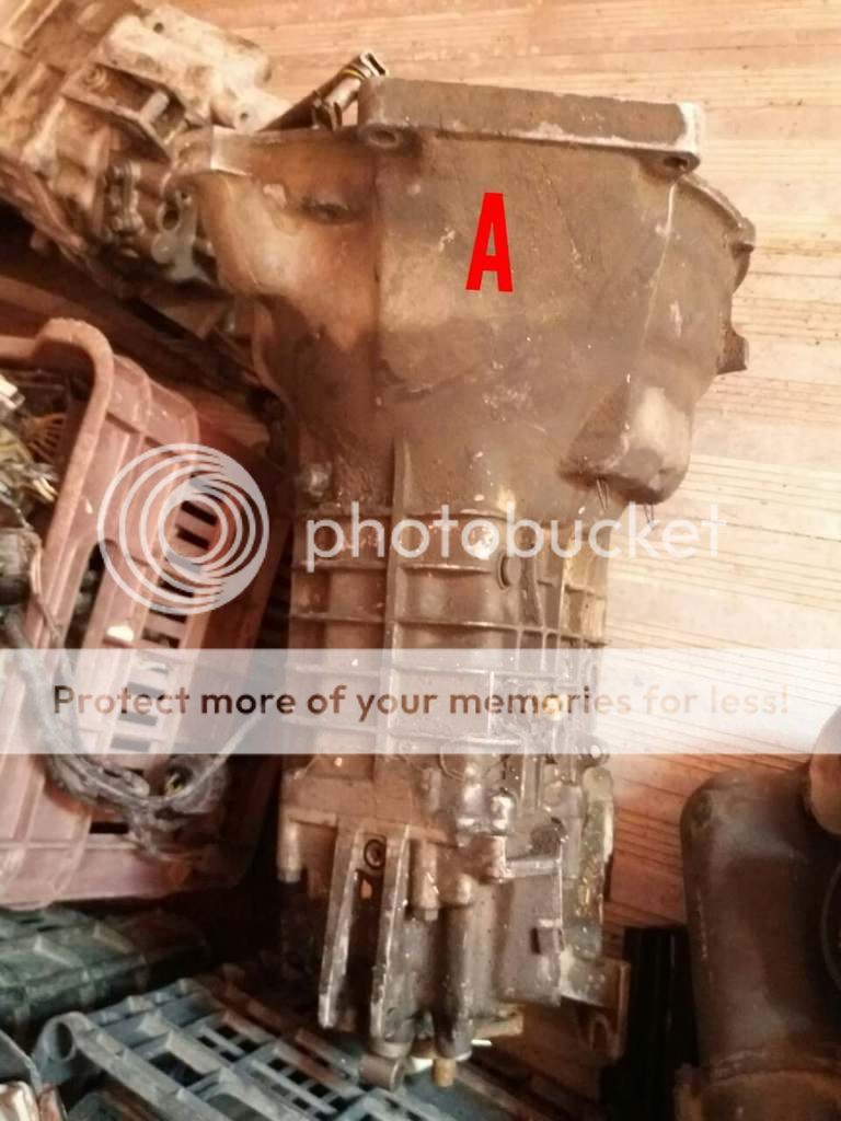

[That's the gearbox i am about to buy.
http://imgur.com/a/NZBIt
Beware of the shark
petroscf
Posts: 1470
My E21(s): '77 EU 316 manual
Location: ATHENS-GREECE
Re: e21 differential
Post by petroscf »
Giorgo I think the link does not work

giorgio2g
Posts: 40
Joined: Wed May 31, 2017 9:47 pm
My E21(s): '81 315 5speed manual
Location: Hellas
Post by giorgio2g »
How about now?
petroscf wrote:Giorgo I think the link does not work
Beware of the shark
petroscf
Posts: 1470
Post by petroscf »
:thumbsup
