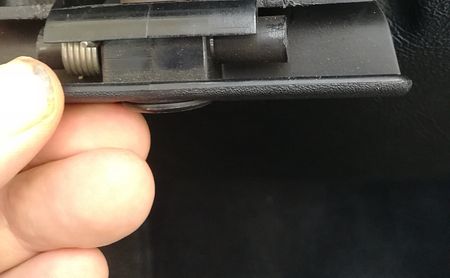

Hi,
I would appreciate it it someone could help me with my glovebox.
All was working fine until I recently opened it when I had too much weight in the glovebox. The glovebox opened fine leaving me with the piece in the photo in my hand !
The glovebox mechanism works fine and I can open it by lifting the small metal clip but I can't see to re-attach the handle to the glovebox itself. Any ideas? Looks like I am missing a pin or something but not sure.
Alternatively does anyone have a spare one that they can sell to me? I'm not worried if it doesn't lock.
Thanks in advance.
Posts: 28925
Re: e21 Glovebox Broken - Help !
That's correct, there should be a pin there. Better put up an ad in the wanted section!
Posts: 18413
Yeah, but how did it go missing? Seems like it is locked in there?

Thanks for the feedback.
Uwbuurman - yes I thought that something had broken off but I searched extensively in the footwell but couldn't find it !
Manitoba - after doing a bit of searching on the web it would appear that the glovebox lock is indeed shared across various BMW models at the time. I've looked on RealOEM but I can't see the part. Do you have a link to where you bought it from?

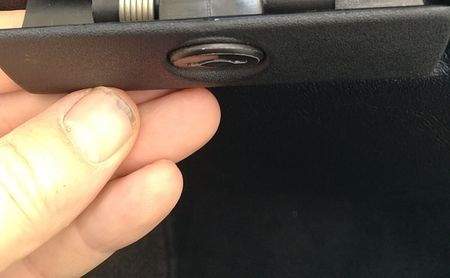

Post by e21paddy »
This is what I've been left with, cannot seem to figure out what I need to manipulate to release the latch? Any pointers guys?
Posts: 2330
There should be some kind of hook attached to the lock on the glovebox itself. This can be moved sideways, which opens the glovebox.
As said above, try and find an e30 handle; switch both locks and you're good to go.
