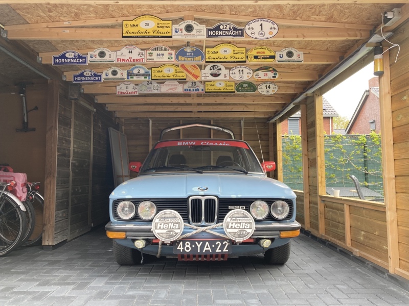

- Posts: 2872
Re: Your top 5 performance mods?
I think most of us are very happy with the engine in their E21, well maintained these bmw engines are fun to drive.
I'm one of the few fellows here who don't own a E21, my fun to drive car is a E12. A little more weight, and two unused doors extra.
As Polov8 said, my first improvement was also a set of recaro's.
Swap the original seats for a good sporty set of recaro's, the car gives so much more feedback with the recaro's, you'll soon know what else needs to be upgraded or renewed, like all new bushings, shocks, springs and arms in the suspension setup and wider low profile tyres on bigger rims.
BMW brakes aren't bad, but to prevent overheating, replace the solid discs for vented discs. Swapping the rear drums for discs is only a upgrade if you also replace the pressure limiter for a pressure regulator.
My E12 is equiped with the M20B20 engine, engine is upgraded to the latest specs as they were in the E30 models, in fact the engine comes from a late E30 and was overhauled last year. I'm happy with the performance of this 2 Liter little 6 engine in the relative heavy E12 chassis, is't fun to drive.
Ofcourse not the fastest around, but still able to do a zero to hundred under ten seconds.
As we use our car for classic rallying, some special mods are done for that purpose alone:
Installed 4 extra driving lights (all lights are halogen, because LED is not allowed)
swapped the 55A generator for a 80A generator, so there is enough current for all the lights
placed a sump protection
Replaced the fueltank for a 90L in boot plastic tank (is this a performance upgrade? )
Replaced the exhaust end muffler for a absorbtion damper, sounds great
Did some weight reducing, like ditching the stereo, rear seat and read window drives.
