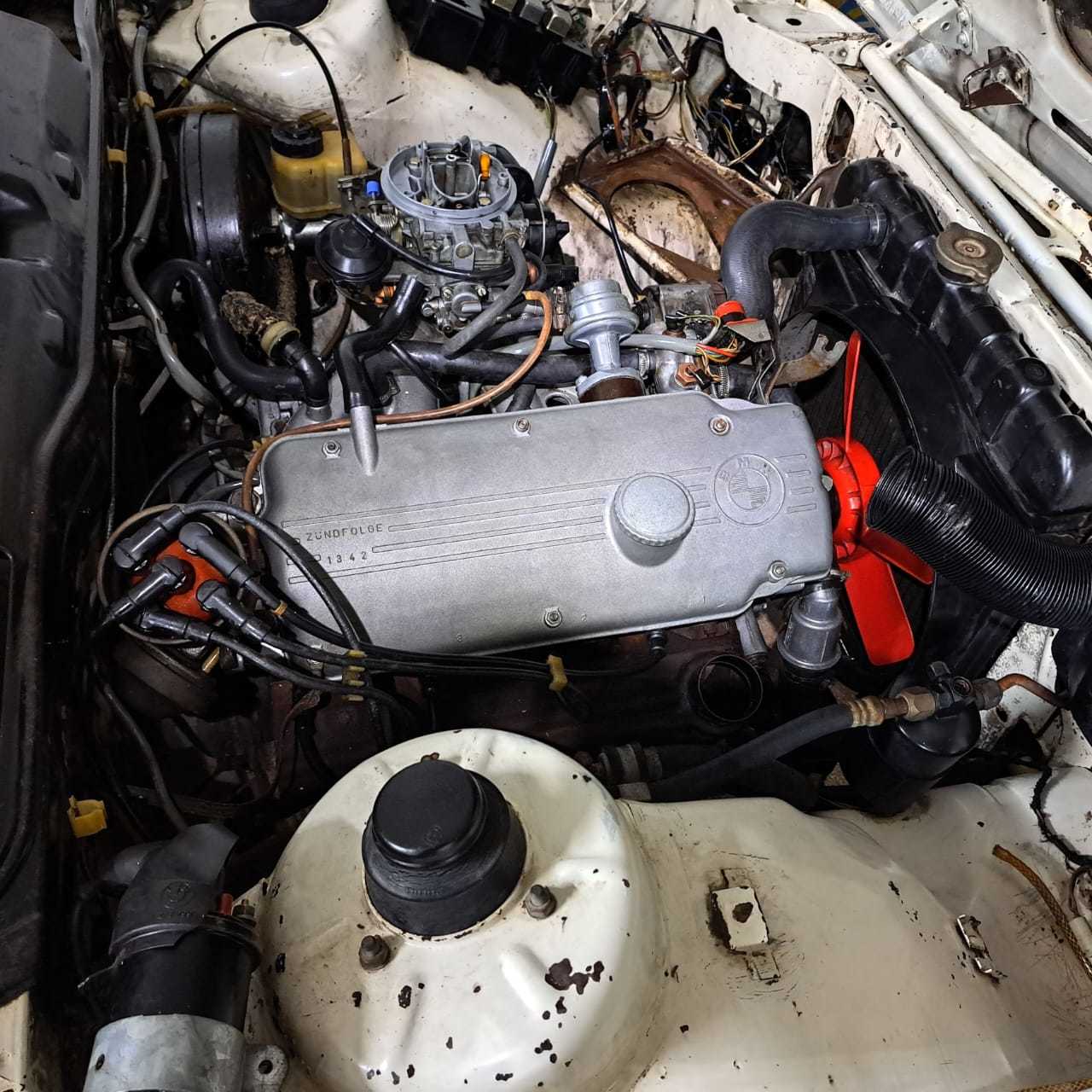

Quick update: Ignition timing was off, fixed that. Replaced ignition wires and distributor cap. Also managed to get full repair kit from Germany, comes with 2 gaskets, the diaphragm, lots of plastics (useless cuz the original ones are fine on 3 carbs that I've seen, I changed them cuz they were colored white the old ones tend to go brown/yellowish) but it has the nice blue plastic cap for the throttle screw. Floats and needles were fine but since I got them from the kit, I replaced them. I wish the kit came with Jets instead of the plastics. Also did valve clearance adjustment, found 4 or 5 valves were too tight. Car has only 63,000km I think they've never been adjusted for the last 10+ years.
Replaced electric pump with original mechanic one.
I had installed a brand new bmw p/n: 13111287844 I believe you guys call it a "TN-starter" I've read elsewhere it's called TM-Starter, and in BMW etk it's called a "actuator"...anyway the brand new one I got seemed to be out of spec. At 20c degrees it didn't extend at all, it should extend to push the piston in carb so that the gap would be about 4-6mm. So I got another brand new one, and now cold starts have much less black smoke.
Engine no longer dies after a long trip. And no more gasoline sneeze from carb. But engine's still running a bit rich. The idle screw has very little effect on the richness, also the CO screw if any effect at all. I don't have a CO analyzer, but my eyes see trace of BLACK smoke, and my nose smells gasoline.
Plus, car has a slight stutter/hesitation when going from 2500 to 3000rpm and then smooths out, and going above 4000rpm. But black smoke and the stutters are very slight/light compared to before. I bought a new airflow valve p/n: 13111705874 but it still hasn't arrived, although I believe the one installed is already working.
Is there any place to buy all sets of proper jets for this carb ? I'm thinking of replacing all jets for peace of mind and hopefully getting a smooth power delivery along the RPM range.
Couple of pix:
Couple of pix:

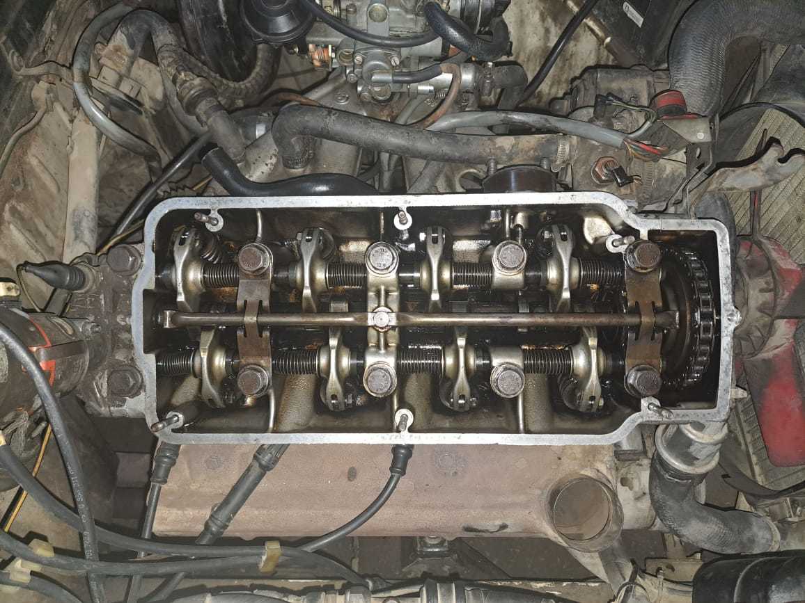

Forgot to mention, first thing I noticed earlier that brake servo was damaged leaking alot of vacuum after long drives. If I kept holding brakes down the idle would stablize, once I released my foot off brakes engine would slowly decrease rpms till it dies or barely holds 400rpm. Replaced that before I did anything. Then replaced the master cylinder which was leaking, and I think that's what damaged my servo. Then I went on adjusting ignition timing.
- Posts: 28941
Re: Pierburg 2B4 Carb fuel mixture adjustment
Not aspecialist here, but the inside of the head is pretty clean! Judging the old style bolts used it could very well be that the head has never been off the engine in all these years!
