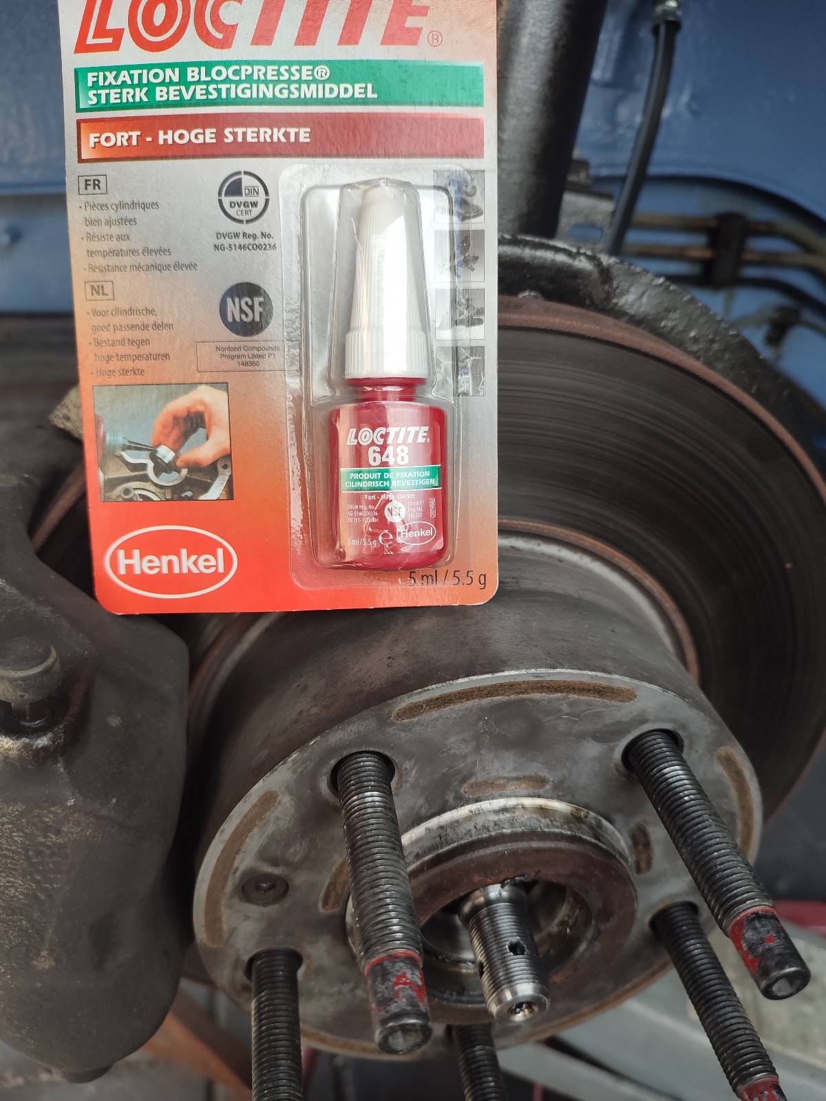

Today i tried fixing the loose wheel bearing on my E12 left front.
First marked the nut position, which makes reassembling iasier.
Removed the nut, washer and bearing race, cleaned the bearing race ID and axle stub free from grease where the bearing sits.
Assembled the bearing race with loctite green 648, washer and central nut back to the marked position.
Loctite green 648 is used for cilindric parts fitment like bearings are.
It wil fill up gaps up to 0.15 mm, after 12 hours fully cured.
Hope this works

Re: Loose Wheel Bearing, Exhaust Heat Shield 323i
I have performed the same repair today and so far I can see no excessive play in the bearing, lets see how it goes now?
