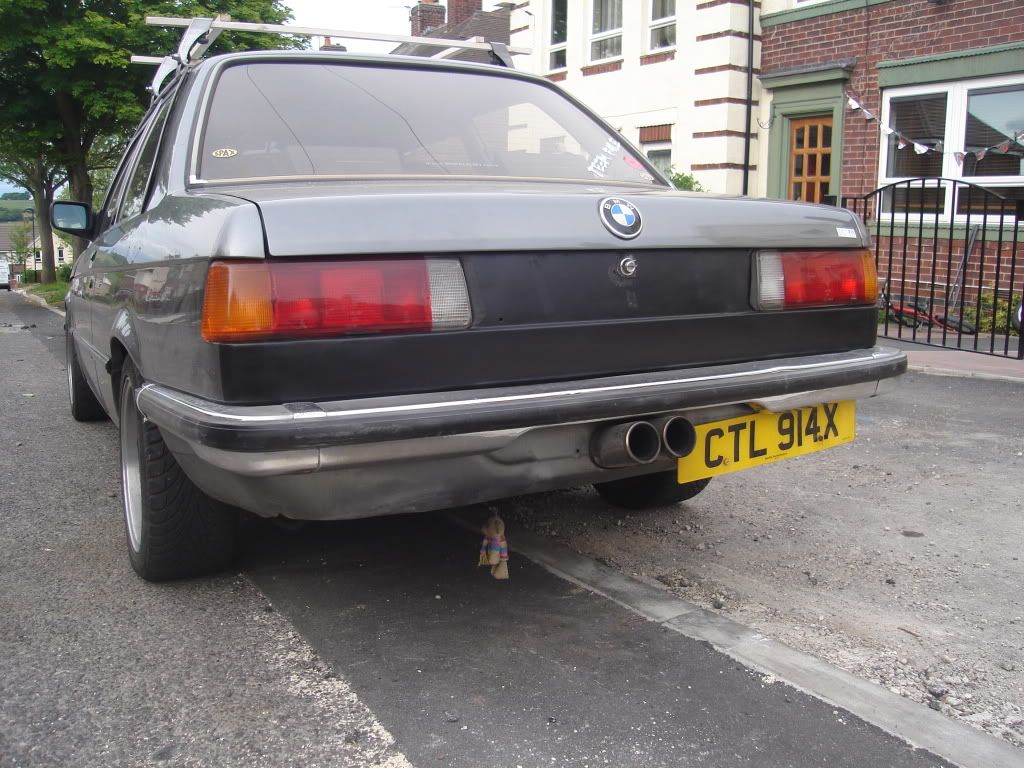

its a car for drifting! not looking mint. it'll do for now.MRE21 wrote:That's looking really good Murran! What will you do with the paint work on the rear quarter? Will you blend it in yourself? or a full respray?
it'll probably wait till either my mate tom can do it or..... till the boss goes on holiday at work and then it can be done under the radar.

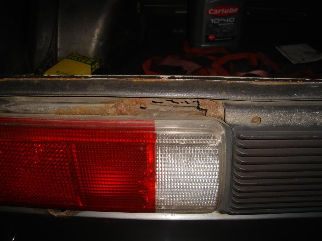

those are some stickers i found in the house. we're getting there. theres still the holes round the back lights. hole in the b post by the rear window. also i hole in the inner wing on the o/s/f

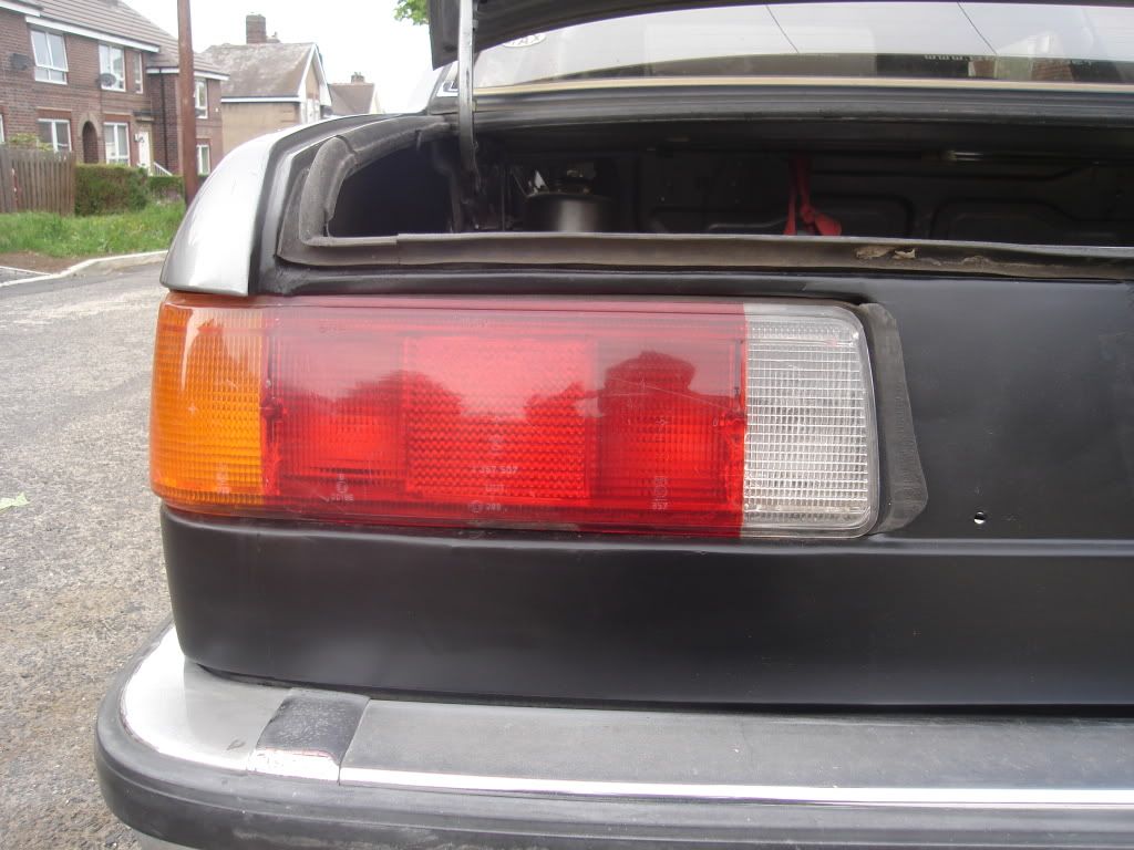

done the holes in the back panel around the lights. it was fun. one hole at a time! done 4 today. had to rebuild the lamp surround on the n/s thanks to this hole being much worse when i took the lamp out....
repair looks good tho! pics later!
ive brokenified the plastic trim inbetween the back lights too. doh! might just run without but have that bit black insted?

I'd like to see how you tackeld this repair. I recognize that rust...
Some E21's look great without the black trim between the lights. Otherwise it's a cheap part anyway.

tbh, it could have done with a back panel welding in it, if yours is like mine thats your best bet for a lasting repair.
but being that mines never going to be a mint car, gets used for drifting etc..... and i cant afford a new back panel. i just chopped it out the grotty bits made some patches and welded them in. then a touch of filler to tidy it up..... its not hard to do. for me anyway lol.

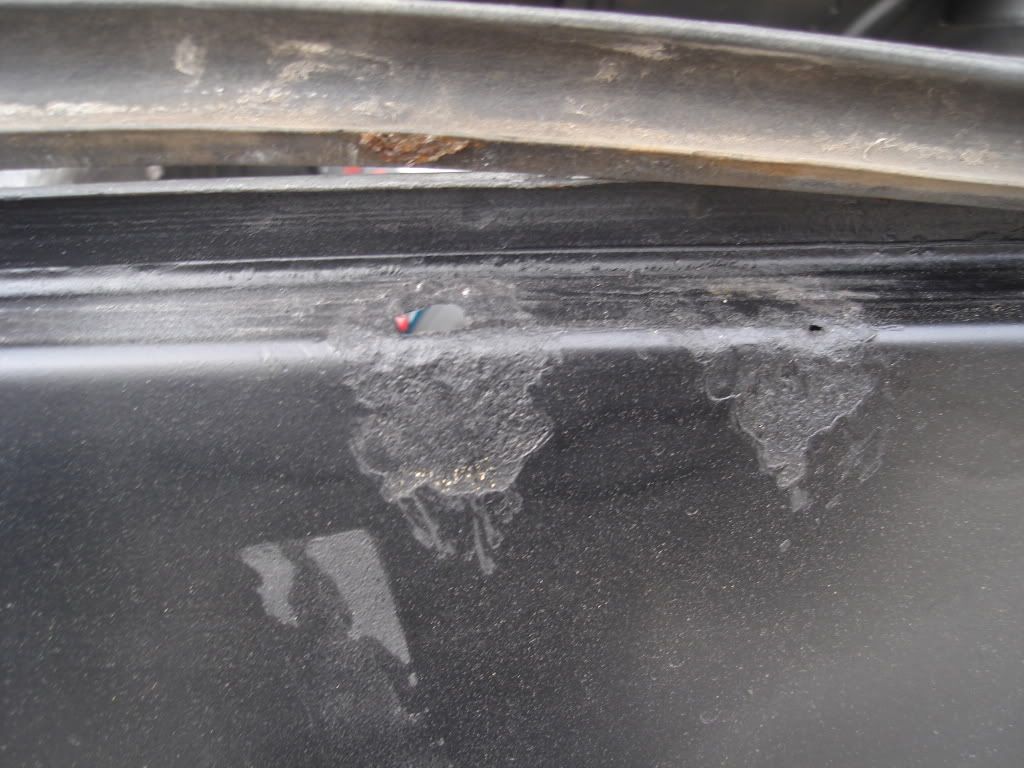

Re: murrans 325i.
couple of pictchurez.
other tiny holes in the back panel still to do....

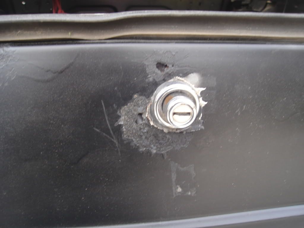

rather annoying ones around the lock....
how do you take the lock out, i looked at it for 10 seconds but couldnt work it out? plus i was guna leave it for another day anyway.
might actually paint the back panel black above bumper line, i kinda like it!
ive also thrown the rubbish black plastic bit between the lights in the bin as its pointless, broken and useless.

iirc the inside part of the lock unscrews. It's like a threaded barrel. Awkward to get at though. I think that's right anyway?

Undo the two bolts holding the latch bit in and the lock is a lot more accessible. There's a big plastic nut that screws onto the barrel to hold it in place. Piece of piss to remove, slightly more fiddly to get back in but if I can do it, you definitely can!
