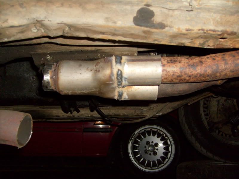

I was in the shed by 2:30pm and had a rummage around for bits of pipe and junctions from my stock of exhaust bits.
I ended up cutting up the 2 into 1 junction from my 325i exhaust and using that as my junction from my headers to the rest of the zorst.
I had to get under the car and lop about 100mm off my header pipes while they were in place so i could fit the junction in.
I used some offcuts to sleeve over the 325i junction so i could slide them neatly over the header down pipes. Butt welding grinder cut pipe ends in place, no thanks.
I still have to sleeve the car end of the junction yet.

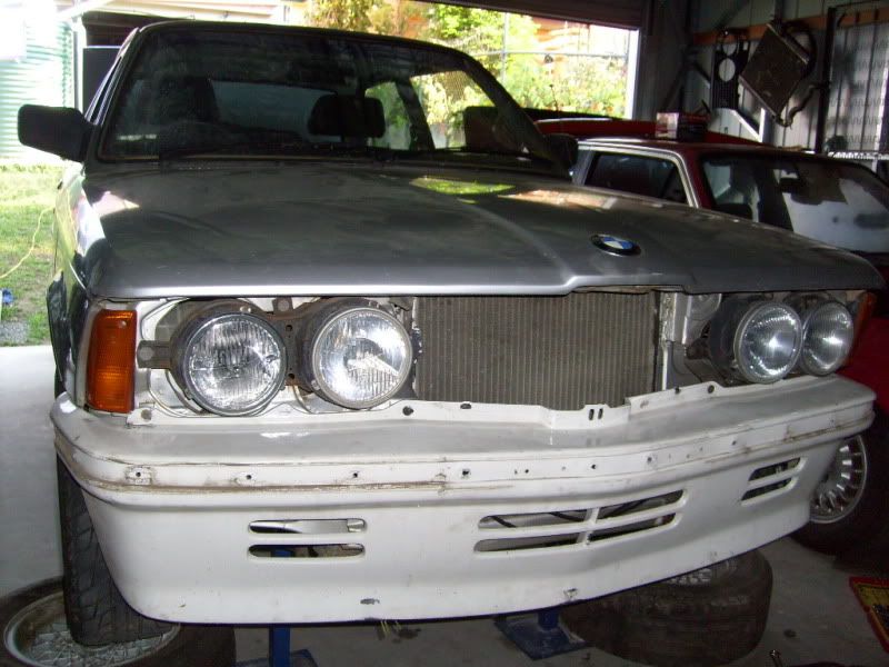

I've pulled off my bumper and front valance to test fit the motorsport bar.
I even weighed the out going parts and the bumper, valance and brackets come in at about 10kg.
The motorsport front bar with the rubber bits weighs in at 5kg.
Not a bad saving at the cars extremity.
Now if i get rid of the tow bar, spare wheel well, back seats and belts and swap my 660CCA battery for a 360CCA one it should make even more of a difference. :lol: :lol: :lol: :lol:
Where the oil cooler is mounted doesn't get any air flow from the front bar so I'm thinking about putting a line of holes along the bottom of the bar but I am concerned that will ruin the look of the bar.
Or i could get the pipes replaced so i can tuck it up in front of the radiator or something...
But that means spending money and i hate that, i already have a hole saw... :twisted:

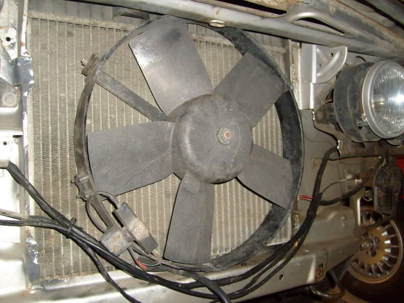

I like the look of this 325i aircon fan in front of the radiator here.
I've lopped off the drivers side towing loop in order to mount up my oil cooler ABOVE the swaybar brackets which tend to get grounded out easily.
The oil cooler will have to be offset to the right of the car to allow me to tuck the oil hoses up out of the way of the wheel and the swaybar.

I've cobbled together all the brackets to mount up the 325i aircon fan and the 325i oil cooler.
I'm pretty pleased with the way the fan mounted up, I've used the OEM rubber mounts to locate the fan, I even got to use my 22mm chassis punch to mount the fan into the rad support panel and do the two upper braces.
I'm not so in love with the way the oil cooler mounted up, for one its offset offending my sense of symmetry and for two I'm not so sure there is enough space for the sway bar to articulate without eventually damaging the hoses.
