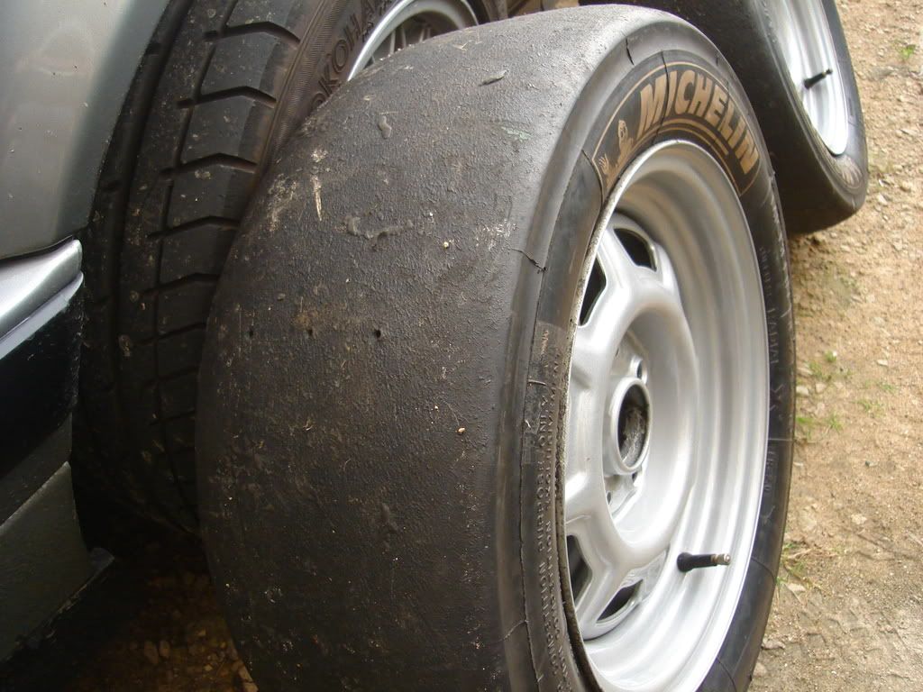

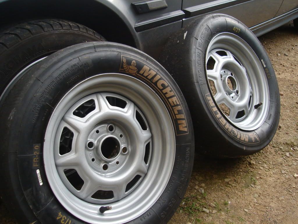

I would like to get some slicks for sprint events as I'm in a modified class anyway. I know 13's are easy enough to get but unsure about 15's? Are all slicks pretty much the same at clubman level? The guy in the Westfield XTR thingy I was chatting too, used Formula Ford slicks iirc.
A swap to rear discs is in the pipeline although the brakes have been excellent so I'm in no desperate rush to lose the rear drums.

13" slicks cheap as chips ebay or sticky slicks http://homepage.ntlworld.com/trrmotorsp ... ytyres.htm 13" wheels go over drums, what are your front brakes?
15" slicks - much harder to find and much more expensive.
Difference in contact patch minimal, grip from 13" slicks good enough to not notice the difference.

id go for 13's just because theres a good source of s/h ex-caterham one on ebay. just run in most of them!
as jim said depends on what front brakes your using and if 13" wheels will fit over them?

I'll go for 13'' slicks as I have an old set of Minilites that should do the job. Mind you, I'd quite like some Mahle to go for the authentic County look.

^^^ the're a little bit wider than the two i bought ages ago, mine were 160 530 13 they fit nice on e21 steels.
tyre sizings different for comp. tyres. "160" is the width, "530" is the overall diameter, "13" size of wheel. :playcar
