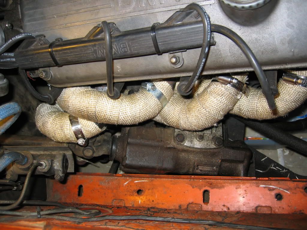

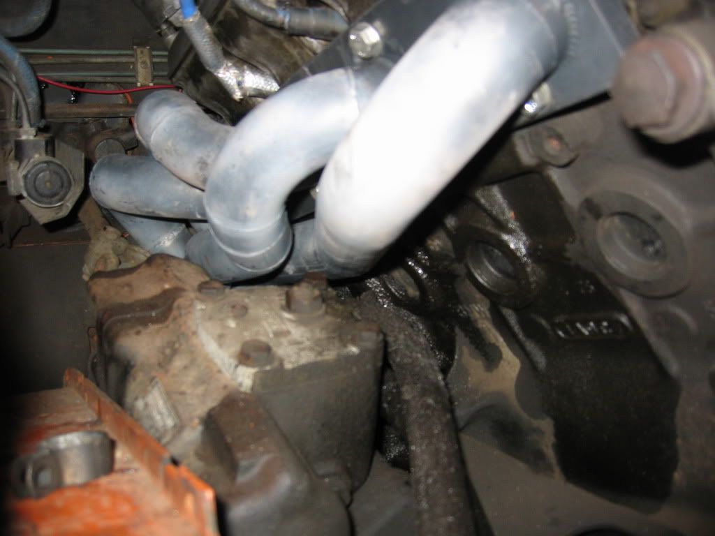

Sorry, I meant "4 into 1" as in the 4 primary header pipes all join into 1 pipe at the same point. "4-2-1" means that the headers combine into 2 pipes first and then later into 1. I've got tuned length 4-1 on mine. When I first had them installed, the engine was almost standard. Just a straight through exhaust and pod filter. It picked up a bit of power above about 4000 rpm, but it hurt the low end torque. Once I installed quad throttle bodies, EFI, and a 304 cam, it now makes even more power up high, but there is no power down low. According to some manufacturers, you could expect around 3-5% in power gain from well set up extractors.
These photos are from the e12 and it has a steering box rather than a rack, but it shows how tight it is with the engine leaned over.
The other thing I'd suggest is getting them ceramic coated or, if you're like me and not made of money, wrap them in exhaust wrap to keep the heat in (helps flow) and keeps under hood temps down.
