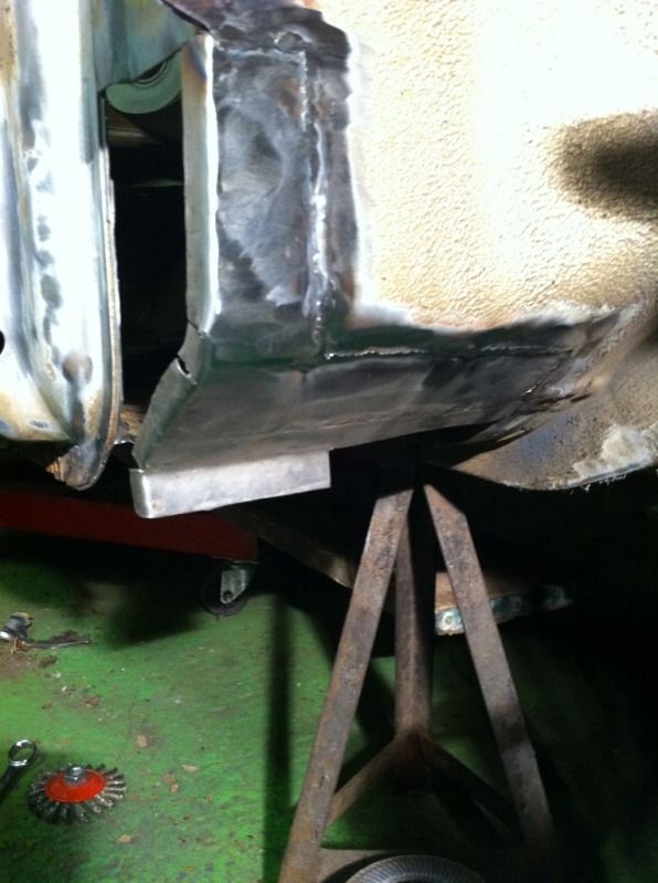

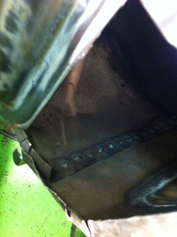

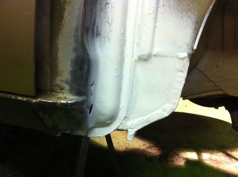

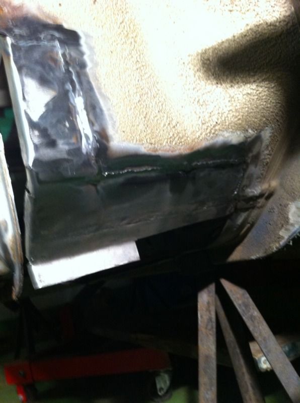

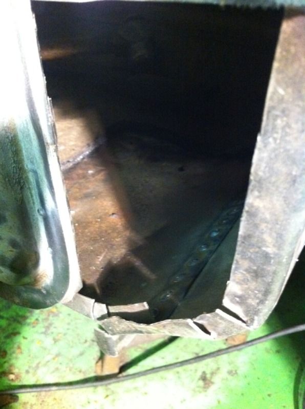

I did mine in sections buddy here's some snaps of what I did might give you some ideas, by doing it Like this I was able to make it look like there was still an original panel there not just a Bodged on plate
The floor plate
Finito
Hope this helps mate :thumbsup

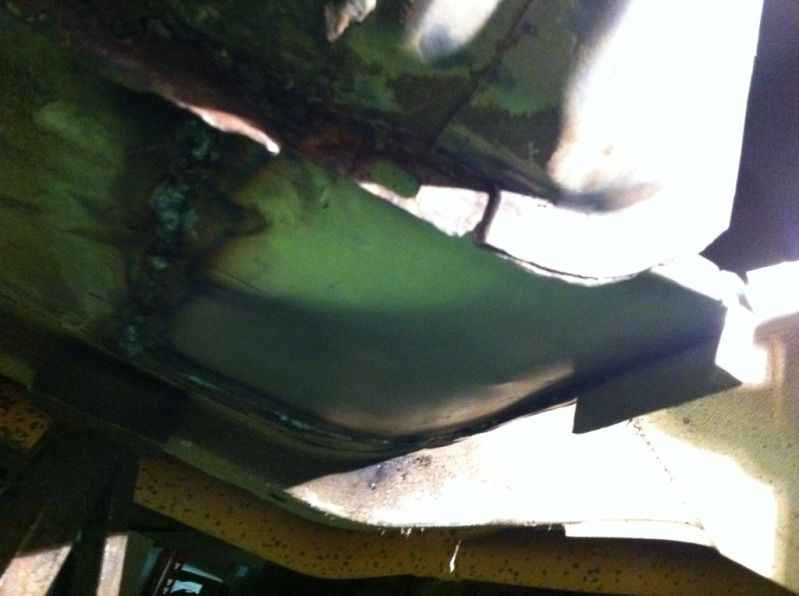

This is the only shot of before that I have, but it was rotten around the accelerator pedal too
