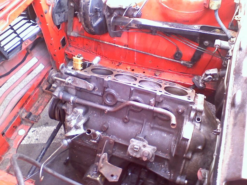

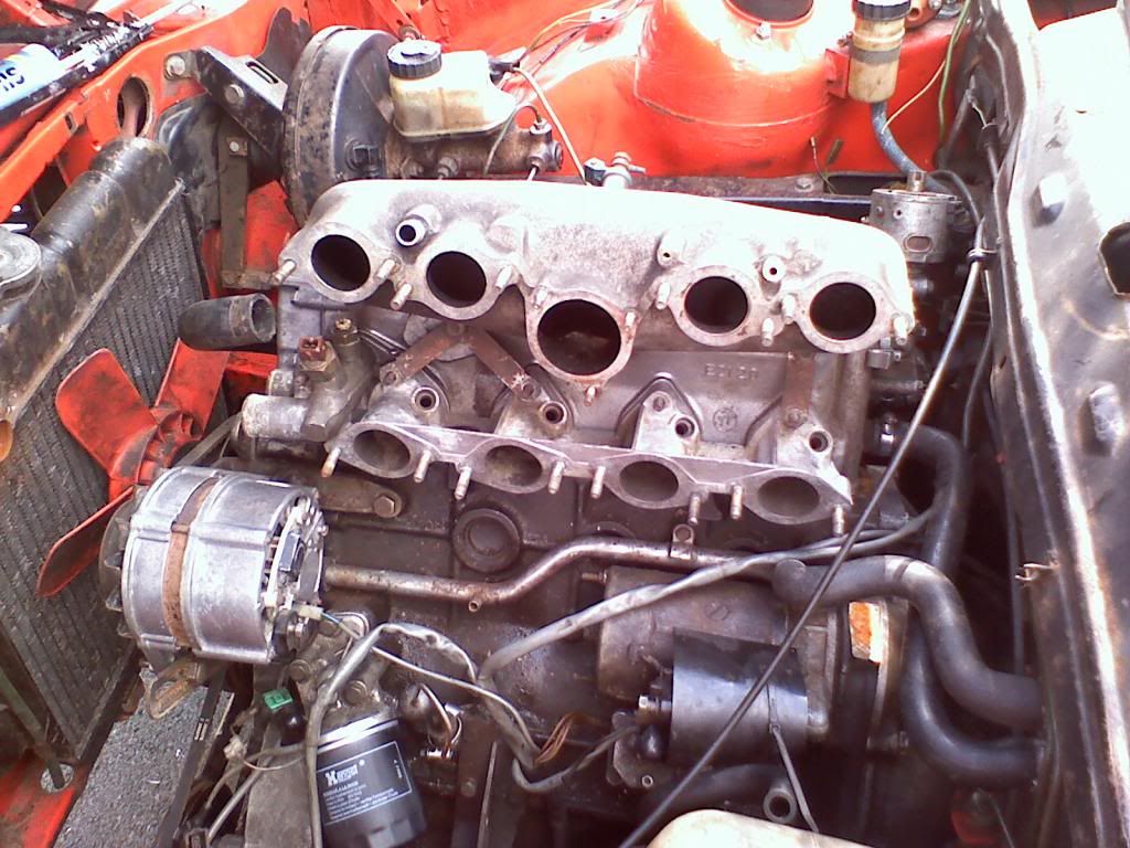

on injected m10 engines there is a metal pipe from the waterpump to the hose for the heater that sits under the inlet ...could this be the answer ..have look at the pic in the link..edd

I had assumed the heater pipe went to the housing at the front of the cylinder head. Looking at that and realoem reminds me that the pipe off the back of the pump has a y adaptor in it, one goes to the manifold, the other presumably is a heater pipe. Presumably that's the return straight into the pump, I believe the feed to the heater is the one from the back of the head.
Unfortunately the slug is wedged in my garage and there is no way I can get under or even to the inlet side to look. Also have a skip on the drive so I can't push it out at present. However sticking fingers in there I can feel something coming off the back of the pump. If I have another blanked off hose in there I can connect to that as well and leave the rad intact.

two photos of my injection engine in recks old car(engine swap part 3......) on face lift cars the heater valve is in the hose to the back of the head. .hope these pics help jim
