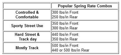

Just found this useful little chart on VAC Motorsports web page, relating to E21 spring rates.
Andy
