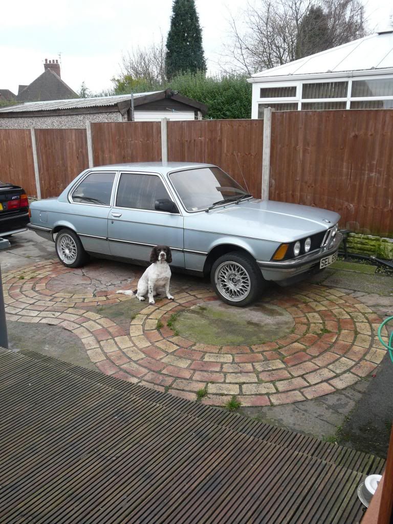

Re: 323 rear brake conversion
Post by Nikgam »
