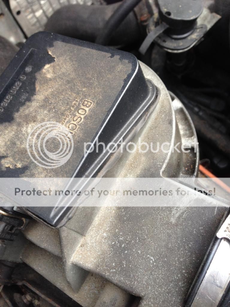

Did a bit of reading on the adjustments of the afm, because the idle is different hot and cold I thought that pointed towards the temp sensor working.
Had a little look at the afm and found this-
Not exactly bmw standard sealing!!
I got the car with a failed head gasket and think it could have been tampered with to try and overcome poor running.
I'm going to hopefully borrow a working afm to test and will work from there
