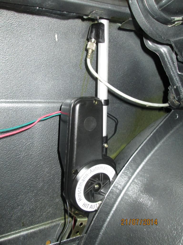

Or on eBay, I believe it was NLA from the dealer. Its just a manual version, the auto versions usually go to the rear so there's enough room to fit the entire unit in a dry place (well, usually) in the trunk. May start to look like this then (stolen from member Remy): :wink:
I don't use it too much as I love the M20's music better so I stayed with the original example myself.

If you go for the auto version as depicted by Jeroen, you can buy it here http://www.conrad-electronic.co.uk/ce/e ... a?ref=list. I used it to replace mine. With the hole already drilled and the cables already available it was not such a difficult job...

I don't think that will work because a) there's not enough space b) i don't think it's well protected against water and lastly, c) the mounting method of the antenna itself is not suitable for that place. As you can see on realoem at the desriptions, an auto antenna was originally meant to be mounted on the rear of the car. This document provides you additional info about mounting the antenna, the graphs will probably be more clear to you than my words;): http://www.hirschmann-car.com/fileadmin ... a_2050.pdf
