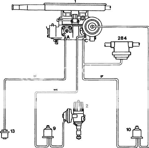

I have a slight flat spot on my 320/6 with solex 4a1 carb, I had a look today and the larger secondary butterflys have no resitance and are open all the time,
I found this pic, mine are not closed like that.
What part of the carb controls the secondary butterflys?
Thanks

I fixed one issue the vacuum pipes where connected slightly wrong
Posts: 12164
Re: Solex 4a1 carb secondary butterflys issue
That is a different schedule then i have. You have the type 2 carb so i believe that you have a ignition with advance and delay vacuumconnection.
Also no vacuumcontroled fuelpressureunit.
