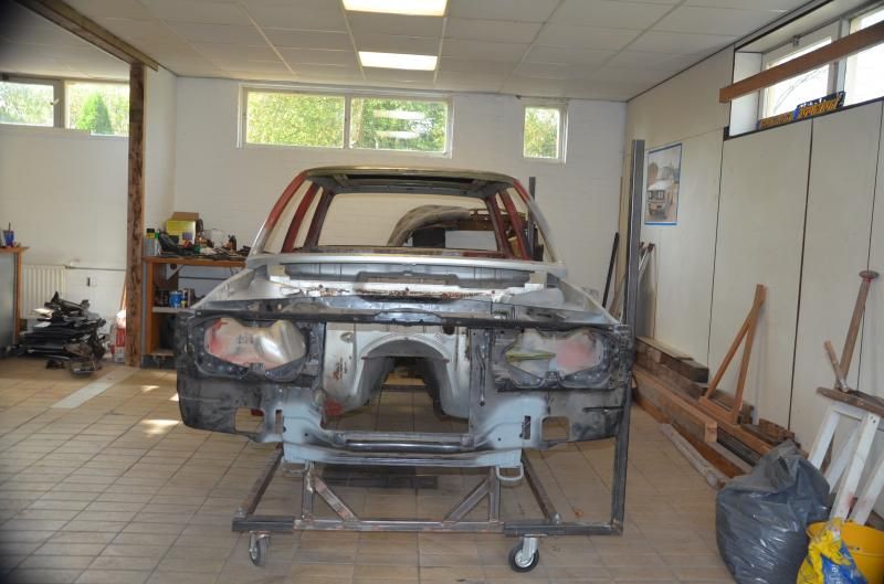

See what I mean?
To get it tot roll over the dead point on top of the sidebar, the whole car had tot be lifted al most upside down.

Oh yes they are much taller than the roof :oops: , do they flex much with the whole weight on one side?
Great idea for easy access to the underside

Less than an inch, is has a diagonal support bar

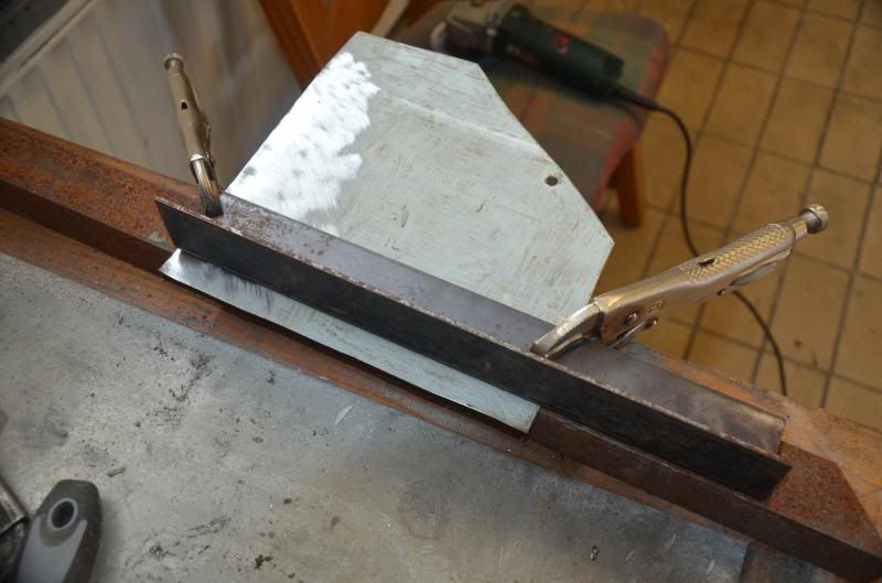

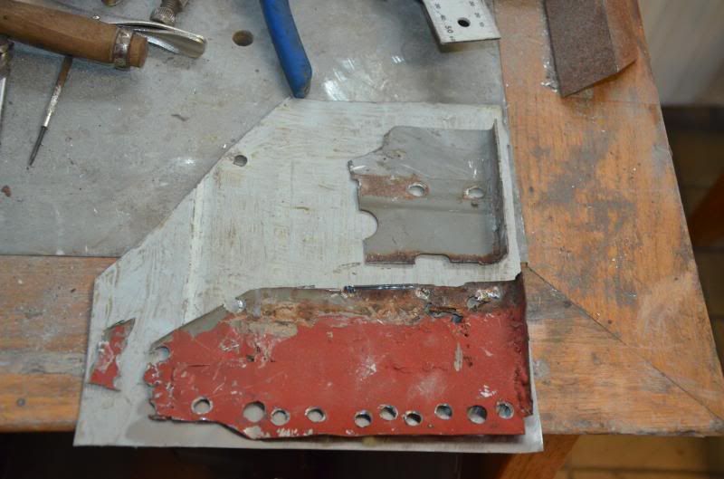

So I went to the Stealer, again, got me a new piece of metal, again. The rear wheelhouse on a e21 consists of two parts. The inner part is larger and contains the shockmount. Those were very much dead in my car, but the smaller outer wheelhouses looked alright. But on this side there are pieces to be replaced on both ends of the outer one, and what works better than brand new BMW replacements? NOS of course!
In an attempt to get a solution for the rotten floor edges against the inner sill, I searched for some of those wiringharnas clamps. Originaly the car has 7 of those clamps, but mine are far from original. So I asked around for the measurements. On both side the car has rotten edges, only on the left the car has those clamps, since thats the only side with a wiringharnas.
In the front in my floor I welded in some new W&N imitation panels. Nice of model and fit, but the egde on the side is the wrong way around! It goes down instead of up. Due to not having the edge up, on that part there are no clamps. In short, irritation all around. There is no donormaterial, all e21 have the same problem at this point. So I took measures, detailed, and had one of my staff draw it in Autocad. Had it hydrojeted out of new sheetmetal and bend. That left me with two new edges, and 6 clamps on the right places!

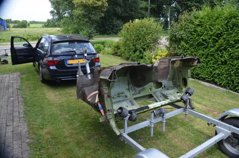

On the front of the car there are some lame old repairs with lots of filler and sealant. To repair all of that, after the rear is done, I need a lot of donormaterial. My friend Jan had a breaker, which I can use so I picked up a piece of that one.
Had my little kids with me, and they where lucky! They got a delicious icecream from Jan’s mum. I’m happy with the donor, they where happy with their icecream!
On the way home I drove the E91 through a write-off barrier…

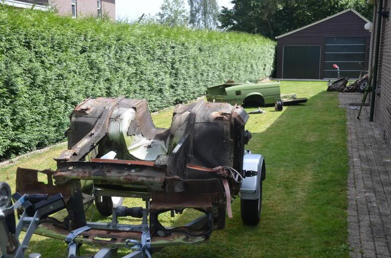

Sunday August 11, 2013.
This is were I left off.
The rotten parts is all gone, apart from the lower corner of the outer wheelhouse. Thats attached to the outside of the sill, in the middele on the pic, and is actually inside (still following this??) The biggest part is cut out.
Thats from this spot. Where the sill is attached to the wheelhouse, some bits of metal are left. Those I will remove later on.
