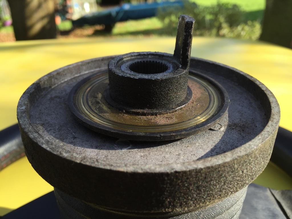

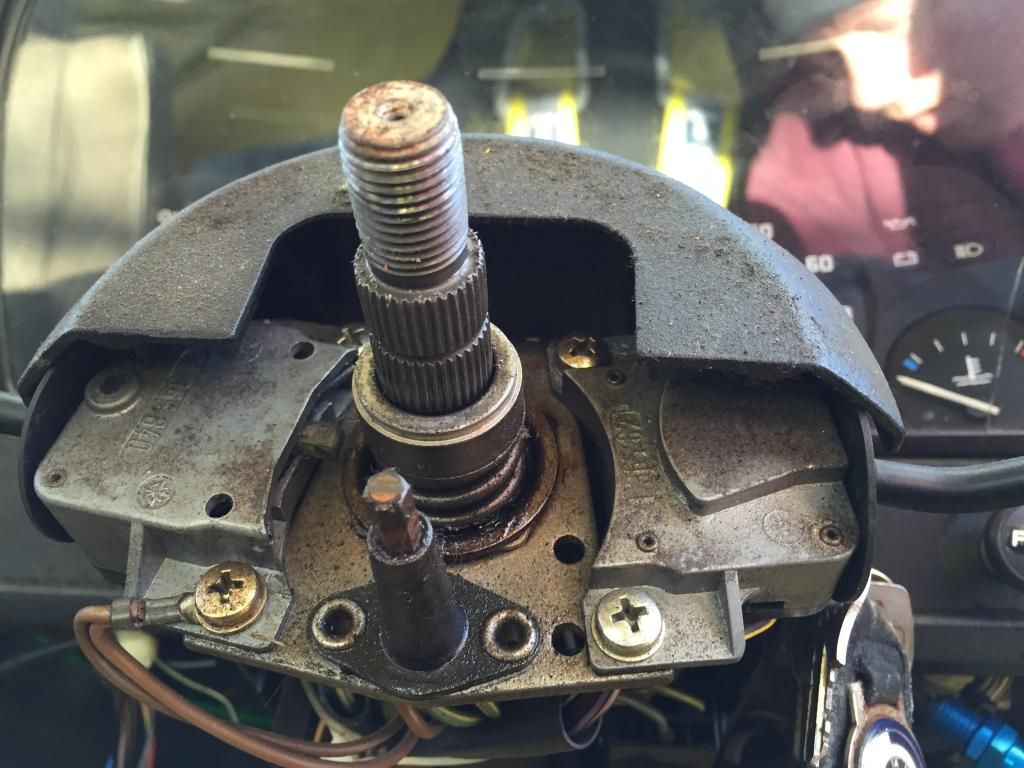

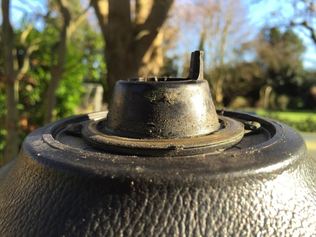

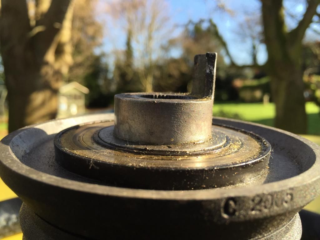

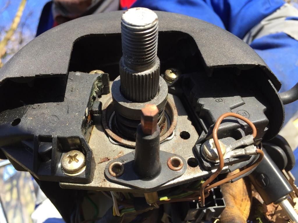

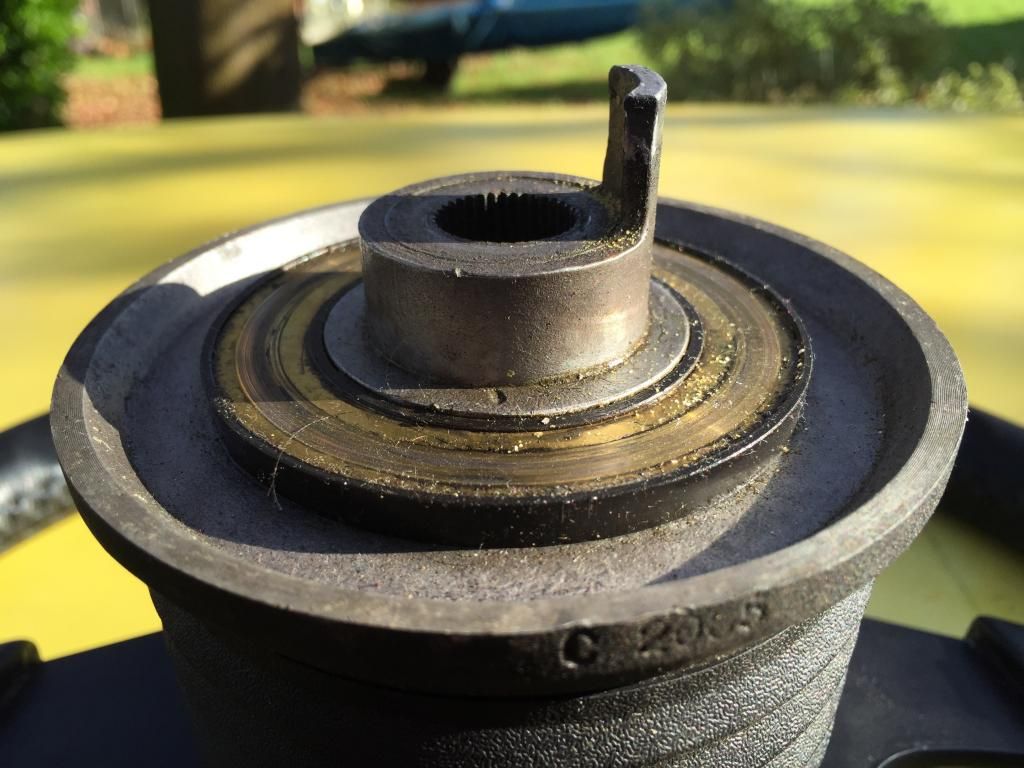

Re: E28 Boss Fitting on an E21?

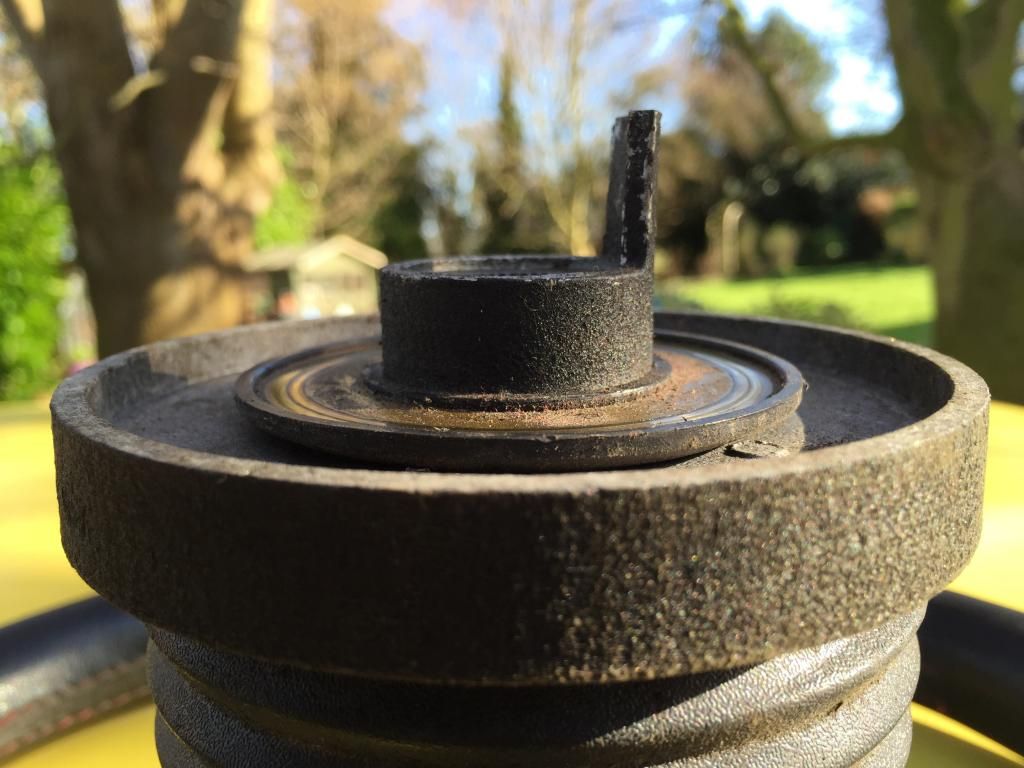

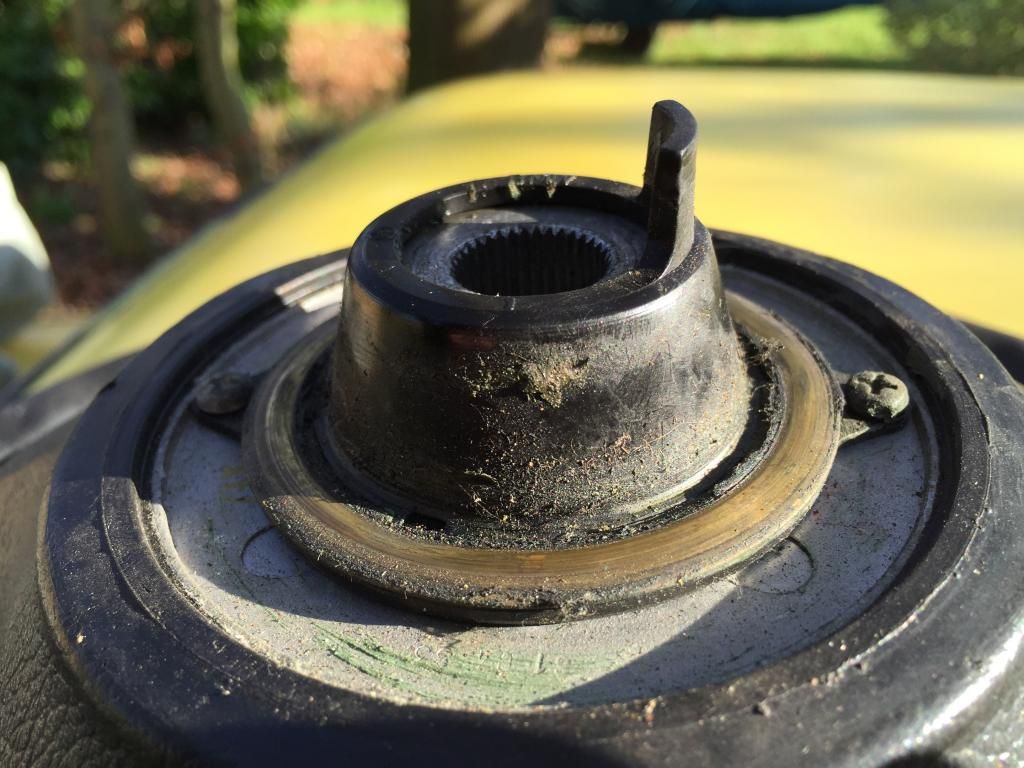

Well its good news with some bad.
The E24/E28 boss will fit on the E21 steering column. The spline is correct and it will bolt down fine. The issue is the boss doesn't contact the indicator canceller.
Looking closely at the two columns you can see the E21 has twice the length of splines. When fitting the E24/E28 boss to the E21 column there is a gap left behind the wheel of about 5 to 10mm.
E21 Column:
E24/E28 column:
E21 MOMO Boss:
E24/E28 MOMO boss C2005:
Just for extra reference this is a standard E24 wheel:
HTH
Ben
E21 Column:
E24/E28 column:
E21 MOMO Boss:
HTH
Ben

That's great, thanks so essentially I would need to extend the tab that cancels the indicator, in order for it to contact the required point?
Yes that and live with the boss having a bigger than normal gap behind it and the column (cowling).Eddie. wrote:That's great, thanks so essentially I would need to extend the tab that cancels the indicator, in order for it to contact the required point?
Ben
Remove that bearing and put on the other side of the boss with a thick washer. Then it will work.
