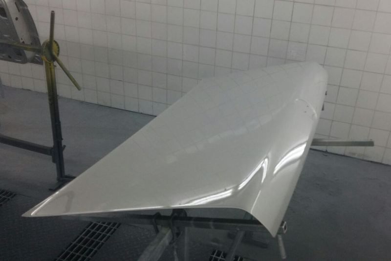

So we have the first Polaris!! On with the rest!

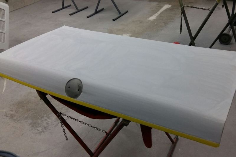

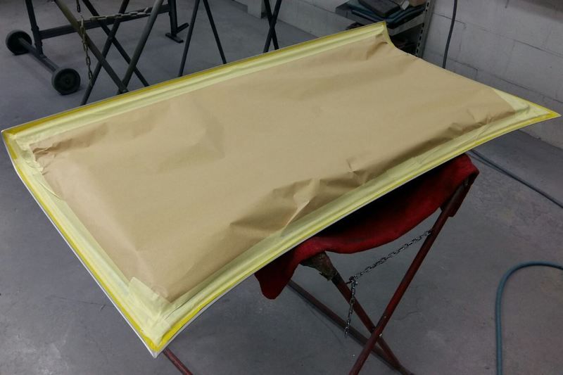

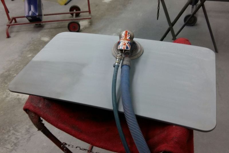

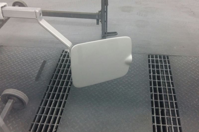

Sunroof, outside.
Inside covered, because thats already painted in the Enginebay coating.

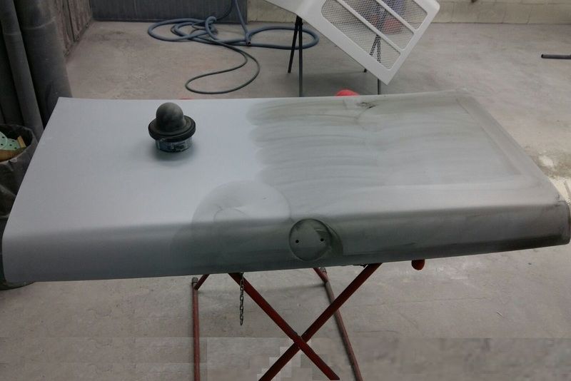

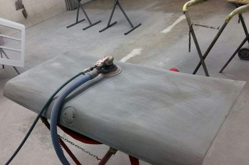

Bootlid the same

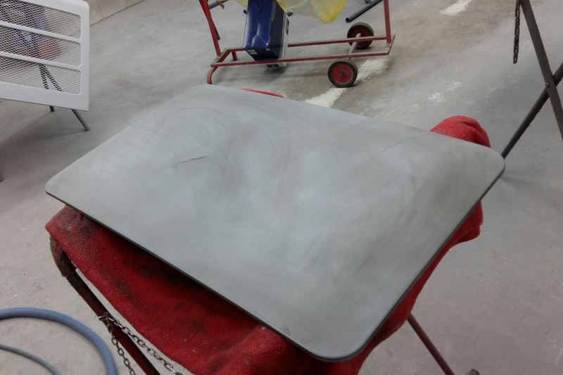

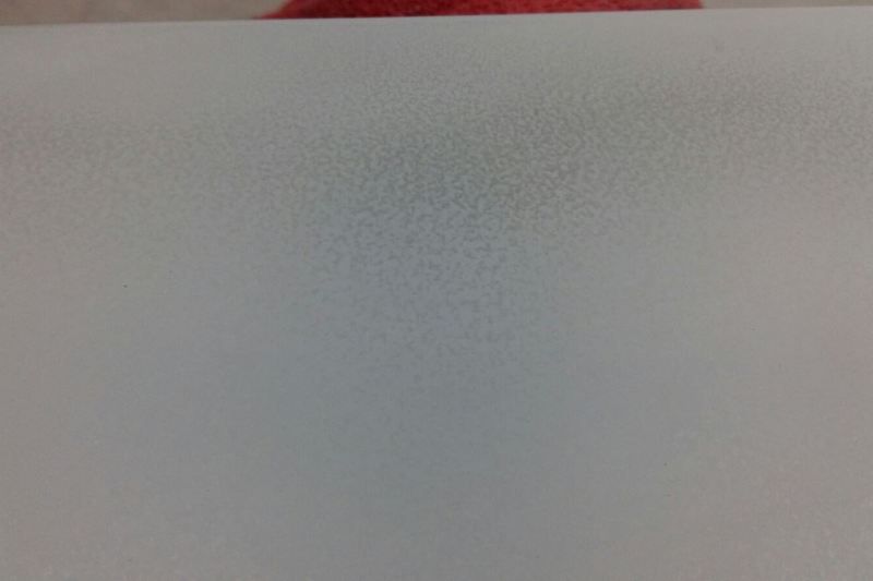

The first layers give some structure. Thats needs to be sanded out.

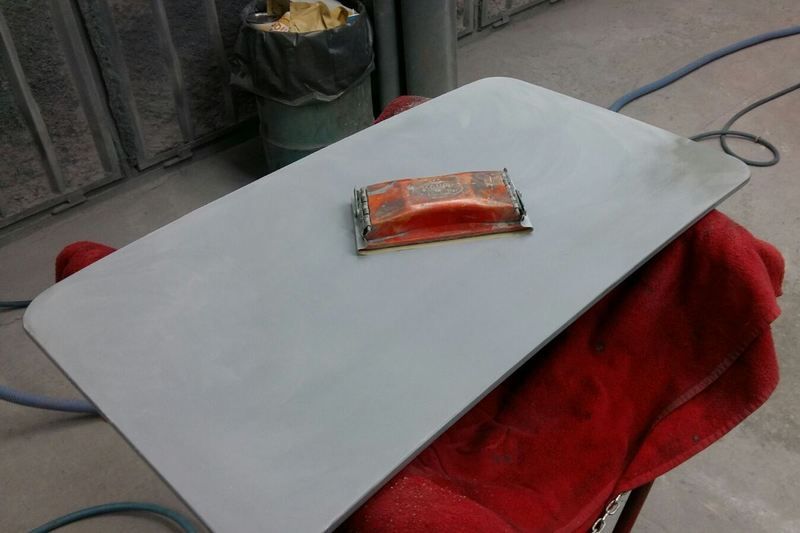

After the block and the machine some powder on it. The black powder shows imperfections.
Tape in the lid so we can sand in the edge.
