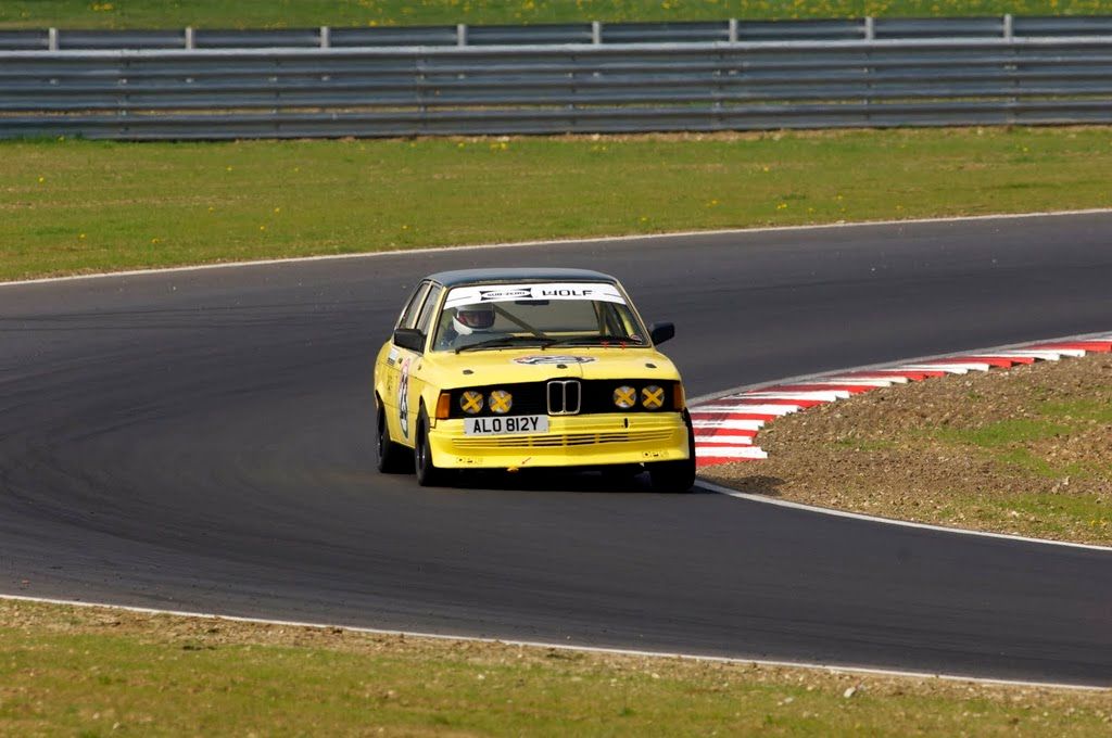

On track with R888 tyres I use different settings:
Front - toe out ~2°, -3.75° camber
Rear - toe in ~2°, -3.5° camber
I would like to run the car lower than I currently do on track but the rear arches are not big enough for the 225/50/15 on my 8" rims.
When the car is setup like this it is not fun on the road, tramlines and pulls around badly. But on the track its great.
80mph corner and front tyres are nicely perpendicular to the road surface, rears maybe a touch too much camber:
Ben
