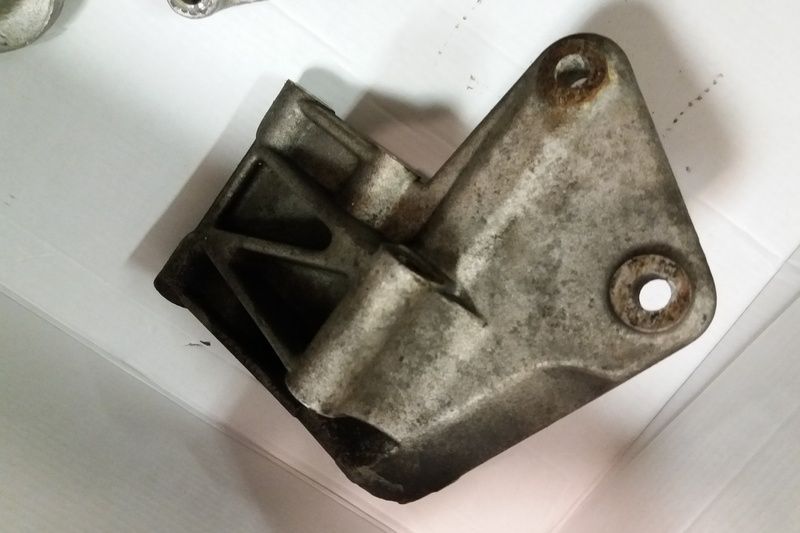

Rearside done leaves me with the front. So the next step is likely to be the front axle. But since I want to fit the engine on the subframe in one go under the car, I need to build that motor at first. So all the hardware that is to be boltet on, needs to be refurbished, cleaned and tested.
The liftbracket on top of the head is not the right one. The small one is e21, the larger oe is for an e30 of e28. But the e21 one doesn't fit the 885 head, due to a different diameter of the holes. They are fortunately to small. Drilling them out is much easier than drilling them smaller.... ;)

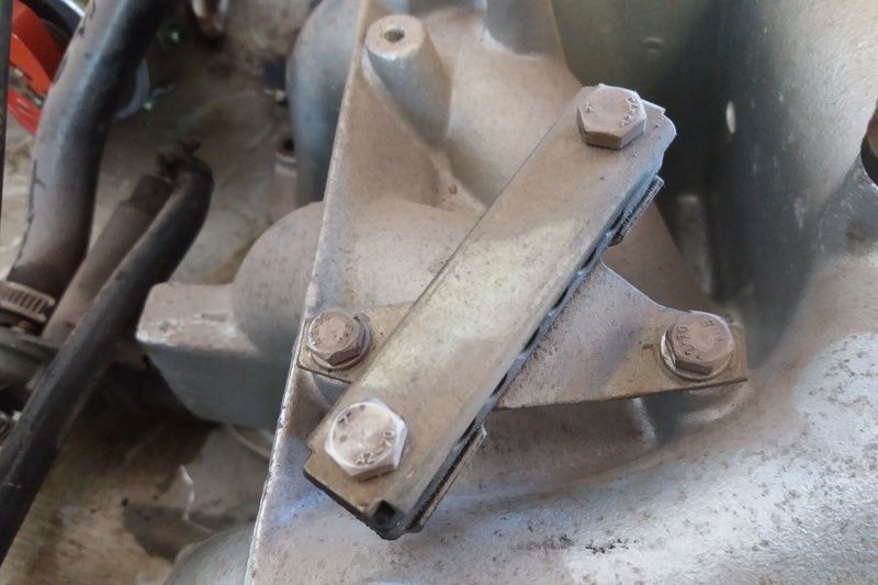

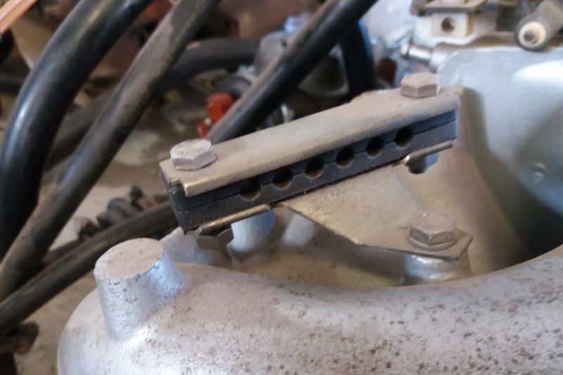

Brackets of the fuellines on the head.

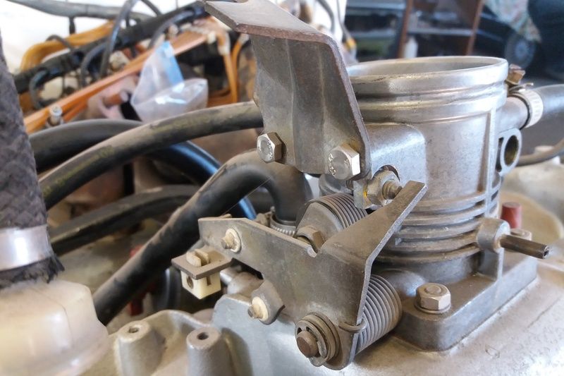

Trottle body

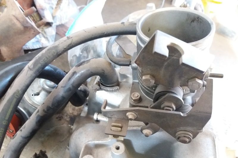

Disassembled trottle body

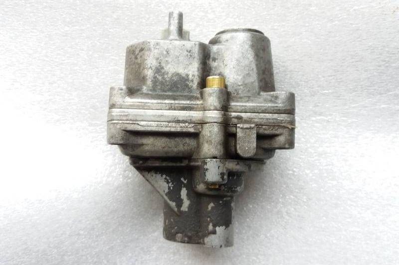

Warm-Up Regulator (WUR)

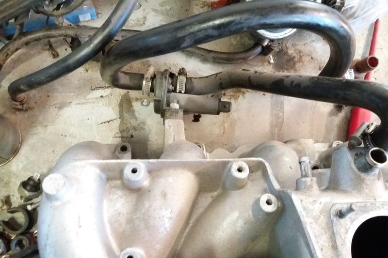

Extra airslide

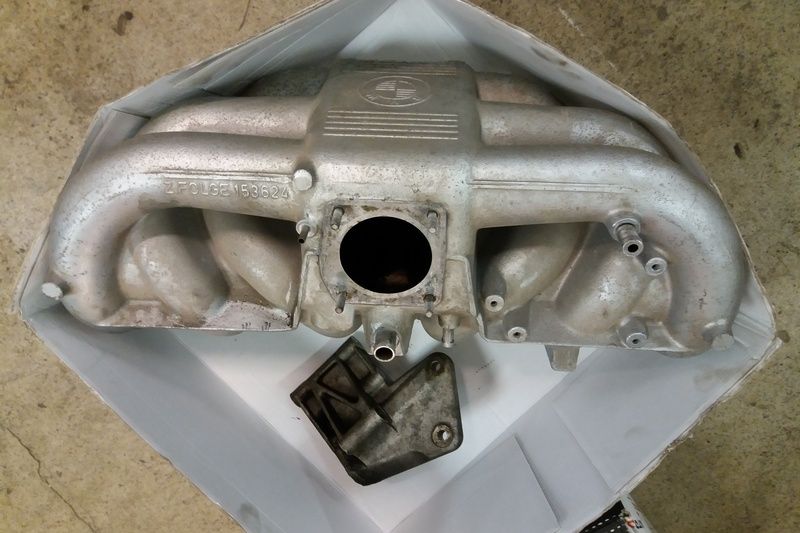

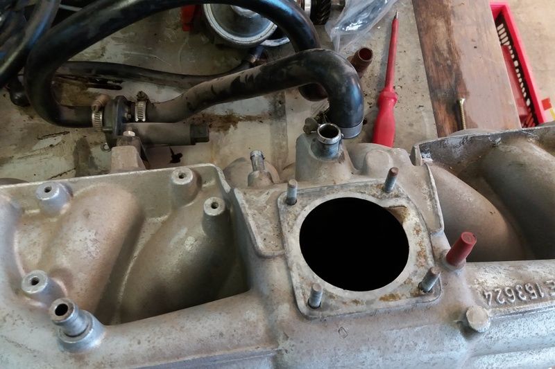

Intake manifold

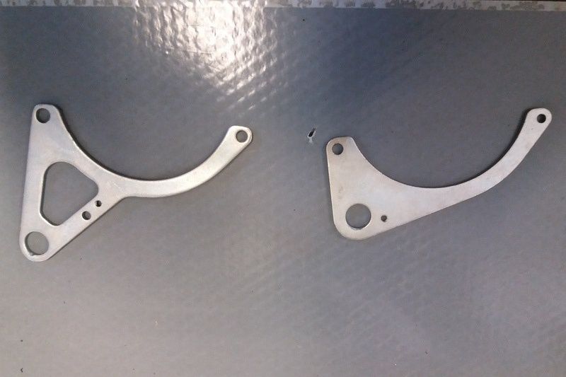

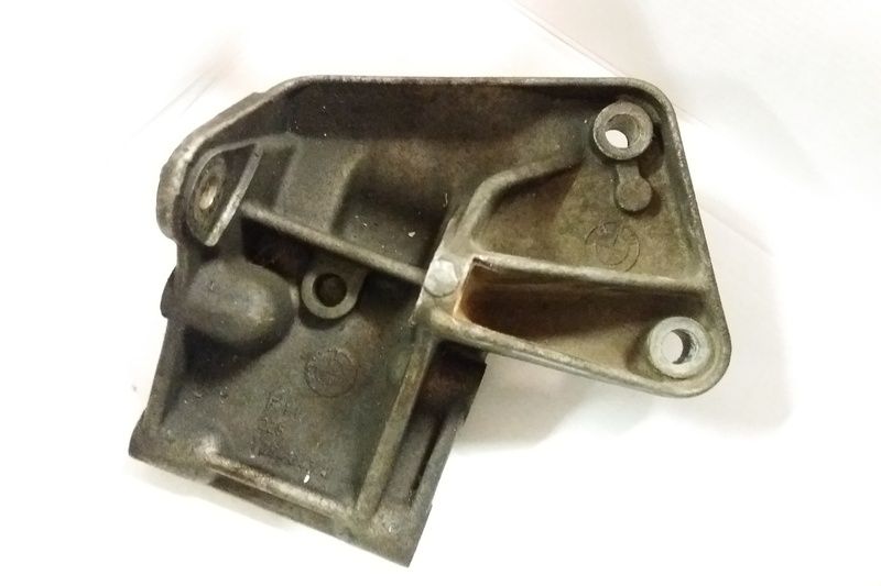

Bracket for the powersteering pump and dynamo.
