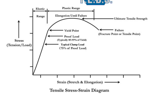

Ah, that is 5 microns per mm. See these graphs, of course I don't know the exact graph for your bolts, but you are most probably within elastic deformation.
It is important to stay under the yield strength, as the graphs shows, the proof load is about 80% of the yield strength. It depends a bit from the type of load what percentile to take, but since it is not a load that goes from tensile to compressive, the percentile can be taken rather high. In effect for a bolt are the clamping forces so high that dynamic load exerted on the bolt just results in a small variation of forces. TTY are in the area above the yield strength since steel gets stronger when elongated.
Youngs modulus for 10.9 bolts is 210GPa. For a yield strength of 940MPa this means that the it is reached at around 4-5 microns per mm.
Maybe this is where the whole story comes from. You are exactly in the 0.2% region so the bolts will probably have stretched a little bit.
