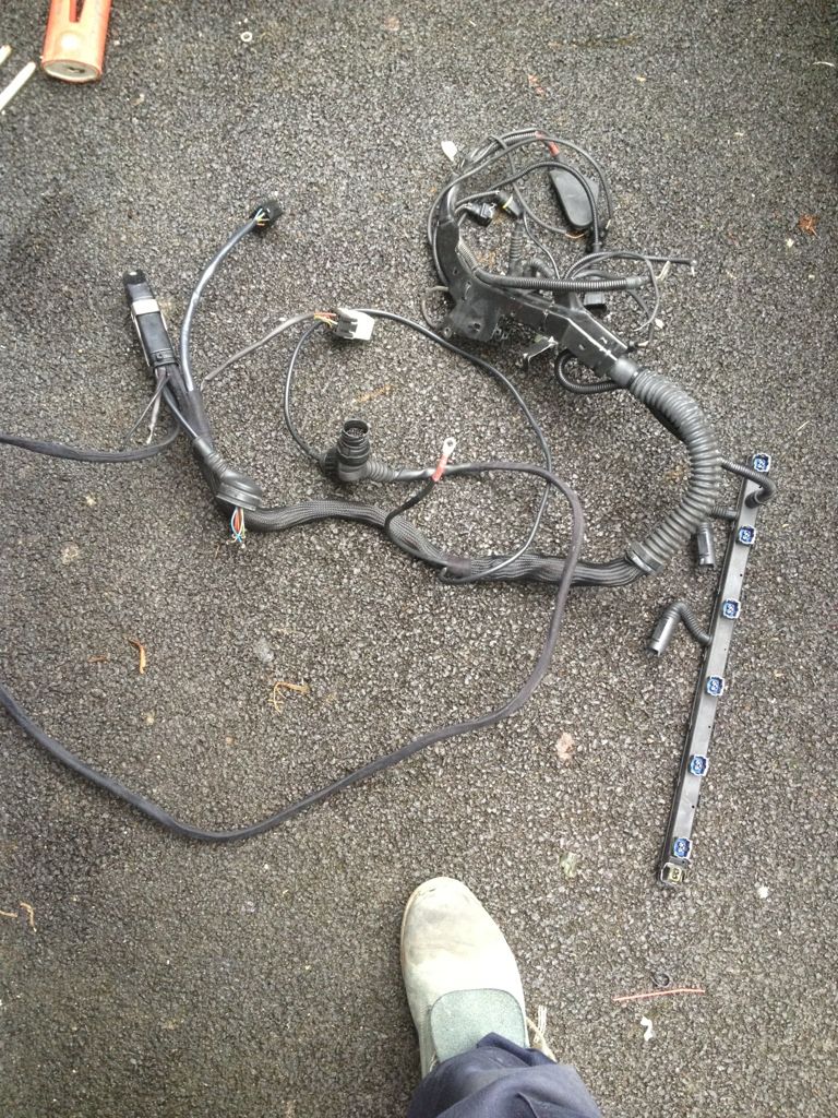

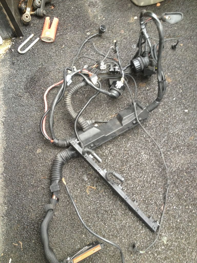

Original loom
New loom Doesn't look much but it's awesome and can be hidden out of sight.
Today's two steps back :-(. Flywheel catching block so all had to come out)
Re: Problemchild75s 1983 safari m52
Good work on the loom. I hated all that extra bloody wiring. I'm doing the same thing on MIB2 except that I've got a Dastek piggy-back ECU spliced in alongside the OE one.
Shame about the flywheel though. Easily sorted?
the e21 flywheel is very light so bolts straight on no modifying. the e30 m20 flywheel is heavier so needs machining to take material off to clear back of the engine.
easily sorted though and I can get flywheels machined for cheap enough.

I can't take the credit for the loom I got Danthe to make it up to my spec for me :-)

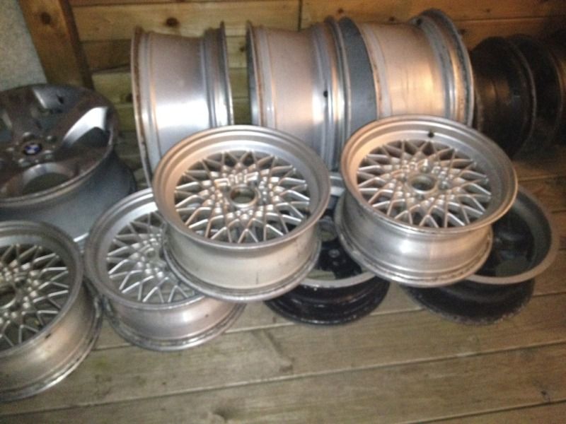

Not much been happening since the new family arrival in our house but im hoping to get back into it again now and try and make Marks retro meet fingers crossed.
while im not working on it im still always thinking about it lol.
Any way had a few sets of wheels delivered this week two sets of which are destined for the E21 one set are 7x15 bbs Mahles and the other set can just be seen below them (ill let you tell me what they are). they will all be painted and polished. So my BBS RS's seen previously will be up for sale shortly if anybody is interested pm me.
for the second set I need two pairs of these :-)
