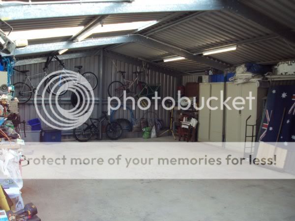

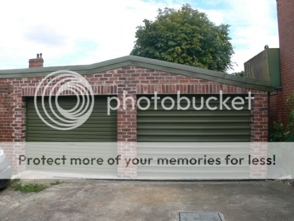

Its pretty much a massive double garage that someone built on the side of their house. Now the guys renting them both seperate.

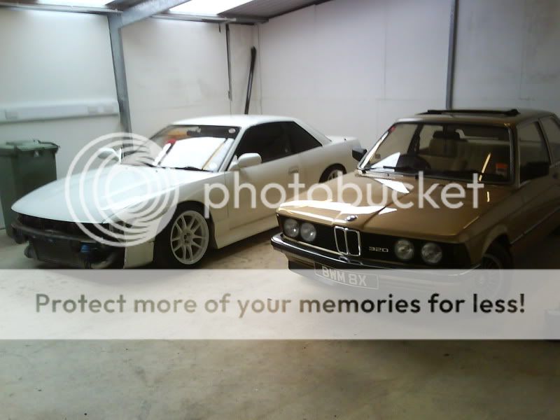

If all goes to plan should have it in a couple of weeks or so. The guy who owns it has an absolute mint VW camper in there at the mo that he imported from Australia, very nice motor. There's another bloke i work with who has a proper space-ship of a Nissan Silvia he wants to work on too so it'll be a contrast sat next to the bimmer!

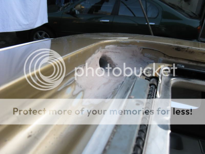

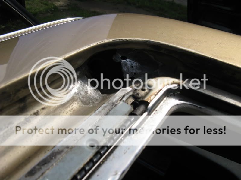

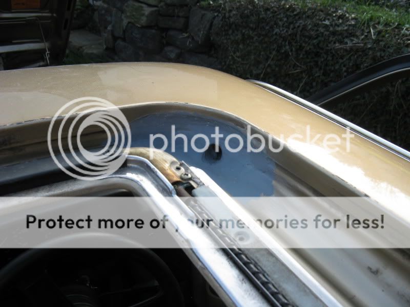

Ahhhhhh!!! Finally sunshine on my day off! Got round to my sunroof fix and thought id share the love.
The orrible hole.....wire brushed the shit, cut the dead and cleaned the edges

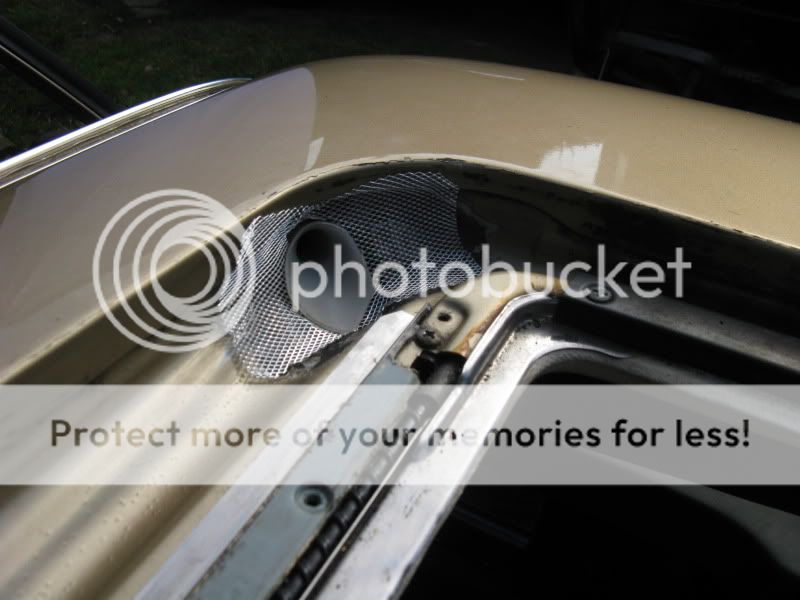

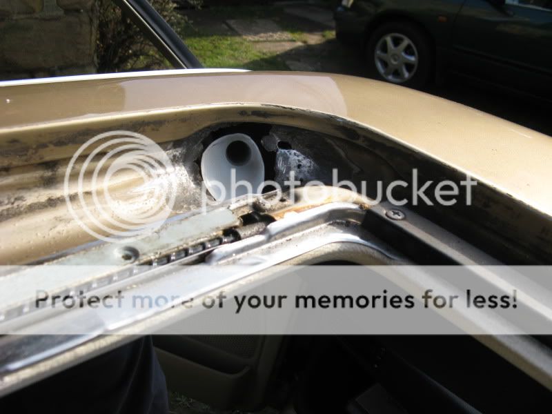

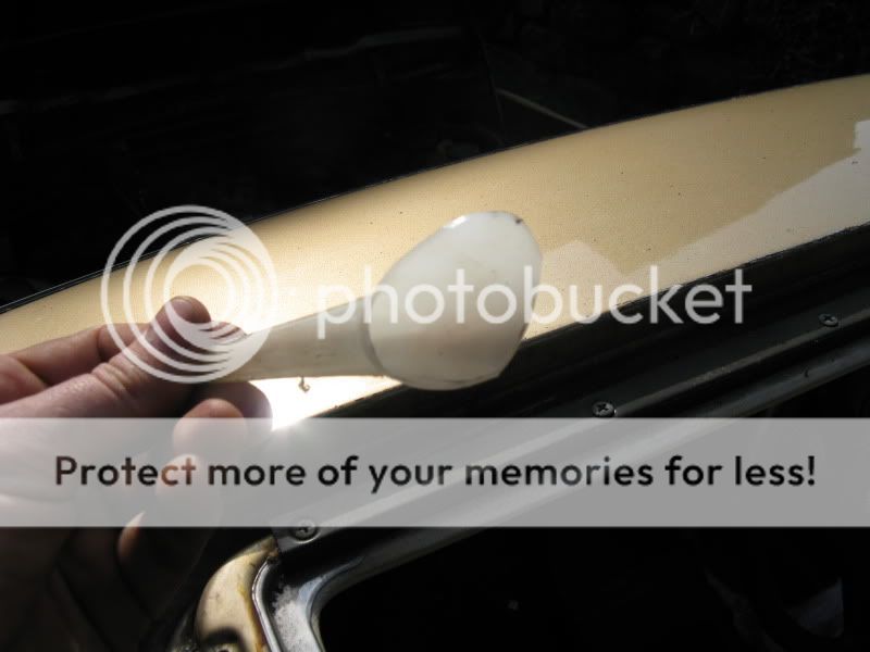

Then needed a plan to join the drain channel back up to where the roof was. It was about an inch underneath the headlining and my first idea was to use a bit of hose pipe. I couldnt find any thin enough to fit into the drain tube so the idea of using a funnel popped into ones swede. I chopped it to roughly the shape of the hole
Was gonna metal mesh over the top and then cut a hole out but the mesh is nice and easy to chop and minipulate so i put the funnel through the mesh and glued the end to the drain tube with liquid metal

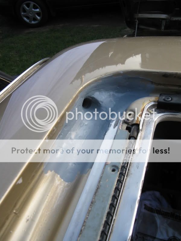

Then it was just a case of body fillering it all in and trimming the edges with a stanley knife.
Then anti-rust (false hope) primer and ready to paint. Did the other side too but that wasnt half as bad

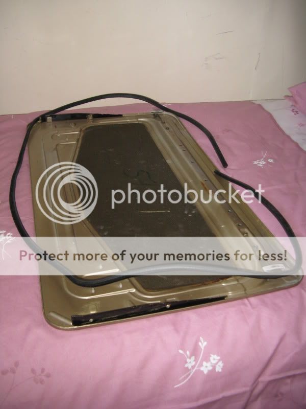

Just need another coat and ready to paint now. Got my new seal (courtesy of DrJim, thanks again!) ready to go on my sunroof. Gonna get some tigerseal for it as ive used it in the past and its good stuff.

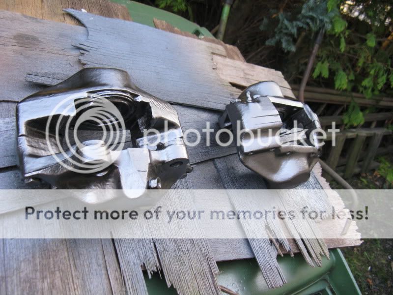

Finished off my calipers and their ready to go once i get my new seals through

thats an awesome bodge on the sunroof!

More than awesome that, it's fantastic. Can't believe the size of hole, and how you've made it look good as new. What trade are you in again?? Reminds me of those cosmetic dentists that could take Shane McGowan's mouth and fill it with perfect teeth.
I think that's the seal off the slugs sunroof panel, glad to see it being used well!
Bodgetastic performance all round mate.

im impressed also, some people would have scrapped the car faced with a awkward repair like that!
nice work dude.

Cheers folks. It aint perfect by a long way. I had to fill it all with the ends of my fingers cuz i could'nt get the plastic spatula thing in to smooth it out so there was alot to sand down afterwards.Took a bit of pissing about to make sure water ran down instead of collecting in corners. Like a said before, i aint really bothered if i never have to open the sunroof again, as long as it works properly.

DrGonzoPOW wrote:Fished out the 323i calipers (did i get them from you Rob?)
Just had a thread catch up. Not sure you did, obviously the discs were though! Dremmel though?? That must of taken you ages, an angle grinder with a wire knot wheel attachment is pure win in rust removal, 2 mins a caliper would have them nice and shiny - very satisying!

Haha, it does look like a she wee Mark yeah, might buy a load and go into the sunroof repair business! Dremmel'in them calipers was'nt too bad, i could'nt have got a drill into all the nooks and crannies anyways. Will do them discs with a drill though.
