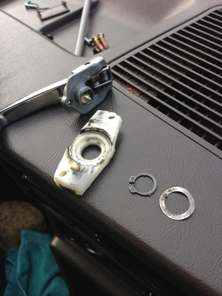

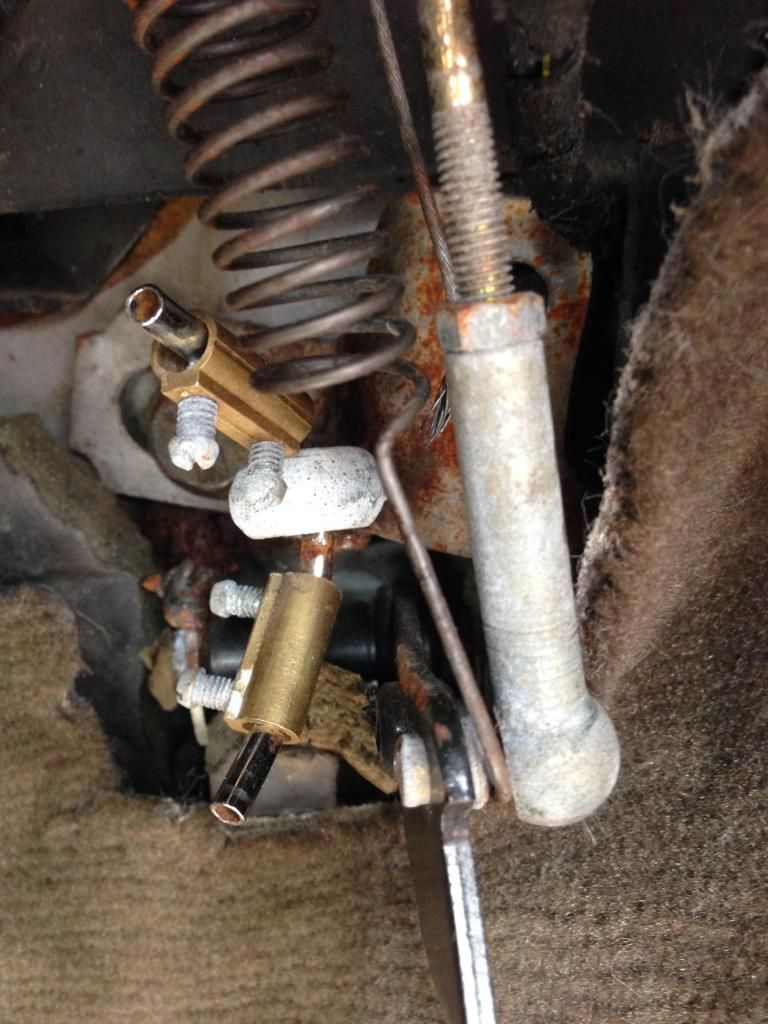

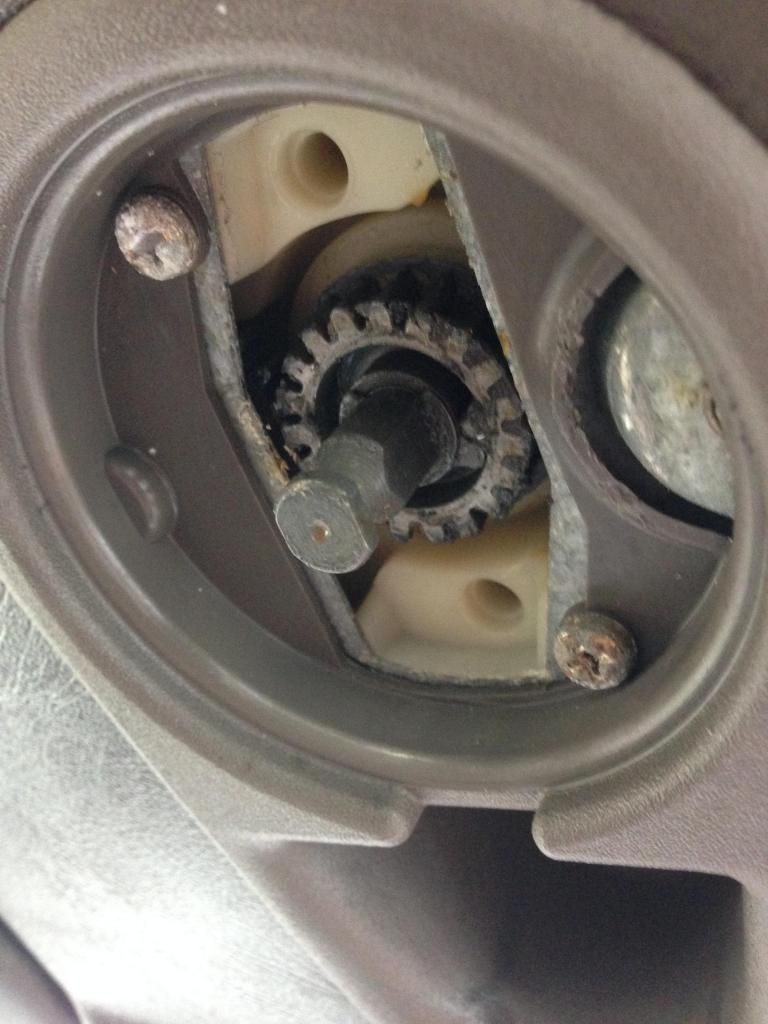

Got some of the niggly bits done today, brake light and reverse lights have been sorted. the driver side window switch isnt faulty and the fuse was perfectly fine, so im worried it may be the motor. i did try and sort the sunroof handle but it sort of just fell apart as i took the screws off and this happened, anyone know how to put this together again or if the Cclip and washer is extra?
And also... what is this? the little metal C bar thing....

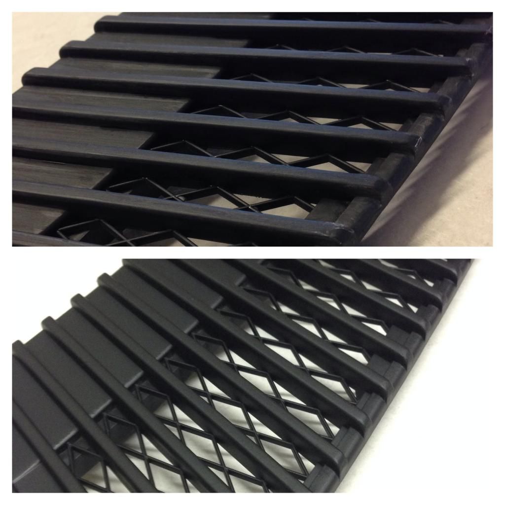

How did you treat the grills?

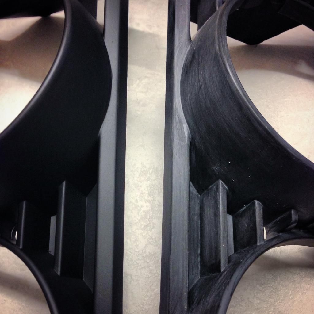

Jeroen wrote:How did you treat the grills?
I wash the grills thoroughly with fairy liquid then I sand the grills with a medium grade sand paper (what ever is at hand) very carefully. Wash again, let it dry, then wipe them down with paint prep wipes. The wipes left little bits of material everywhere so i wouldnt advise to use them, id use a cloth and some sort of degreaser for paint prep. then i spray the grills with 3-5 coats of satin black paint. After being left near my boiler for 3 days to dry and harden, they are ready to go onto the car. Sanding takes around 2 hours to properly reach all areas. then cleaning another 20-30 mins. Sanding is the killer part, kills your fingers.
I use the same method for my mirrors and door handles. the finish makes them look brand new.

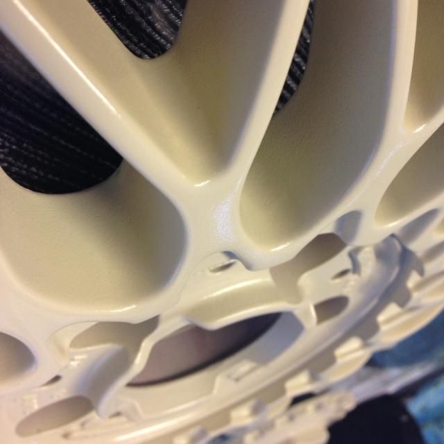

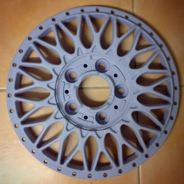

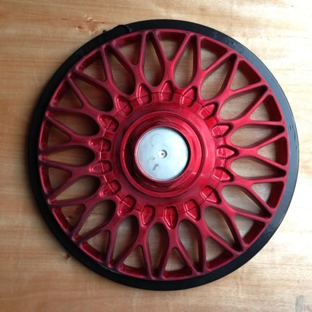

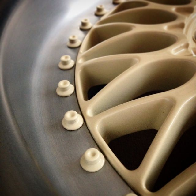

So i got these.... was not a fan of the colour, they were candy red and didnt suit the car. so i decided to do a bit more DIY and try my hand at a proper paint job for the first time. ill let the pictures do the talking.
Sanded.
Primed and wet sanded for a smooth finish
few coats of paint followed by heavy clear coat for a shine.

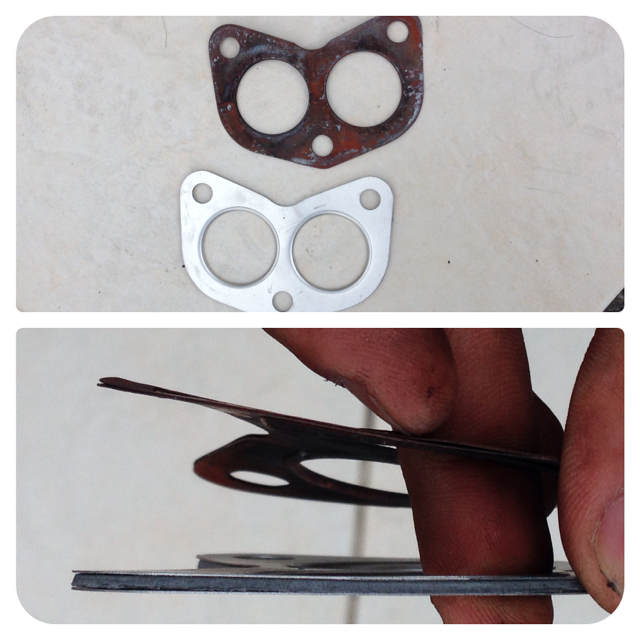

i also found a huge exhaust leak which i originally thought was a hole in the manifold, but closer examination revealed it was the gasket between the manifold and downpipes. the difference was immense. this £2 fix sorted out the hesitation when at high revs. however my oil pressure still drops as the car heats up, going to heck for vacuum leaks over the weekend.
Shushman
Posts: 136
Joined: Mon Jun 11, 2012 3:30 pm
Re: my e28 project
Post by Shushman »

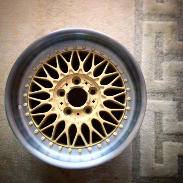

the finished Product after putting in nearly 23 hours in my garage sanding, preping and painting. The chrome lips were not in the greatest condition, so i decided that i will do something a little different. i decided to scuff all the chrome and was on a mission to get a brushed metal finish. i sanded them with 1200 grit sand paper, used abrasive scuff pads to get the rougher brushed look, worked my way up to a fine scuff pad and got the look i was hoping for. complete luck with a little bit of planning.

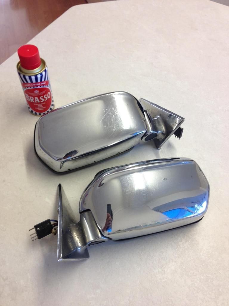

very nice, really want a set of the chrome mirrors, know of any more for sale.?
