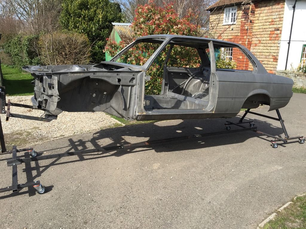

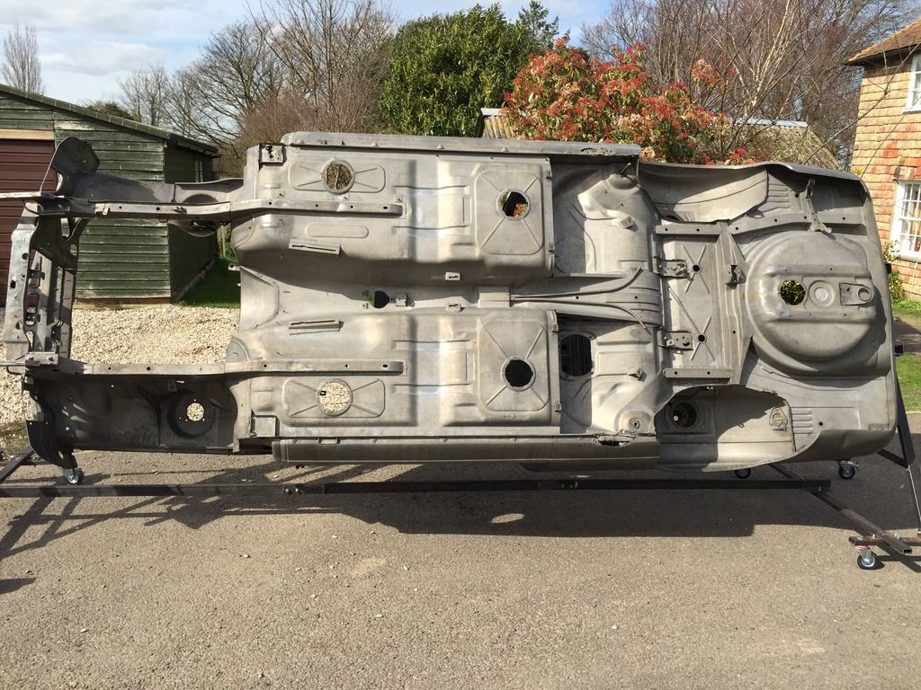

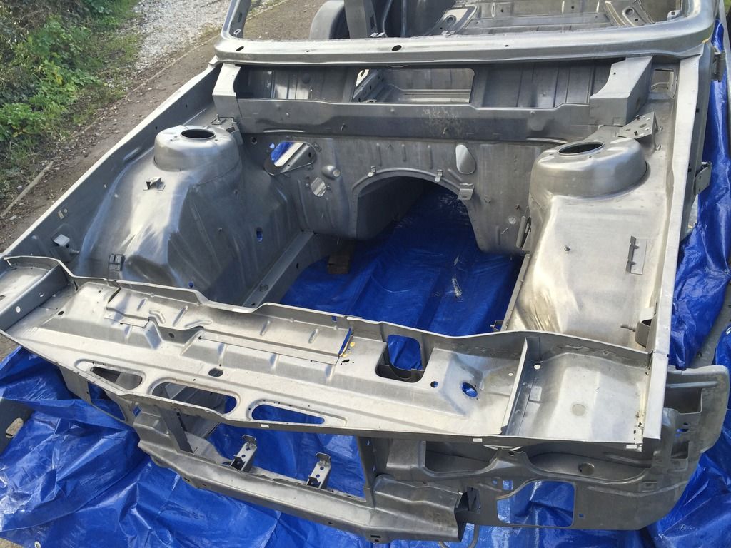

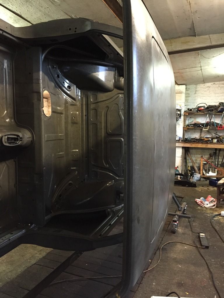

Some update pics of the shell after being dipped de-rust and passivated, it is interesting to see the amount of brazing used between some of the panels:
Lots more pics can be found in the Photobucket album, may be useful to see how all the panels are joined in the factory:
http://s180.photobucket.com/user/durace ... E21?sort=3
Regards
Ben

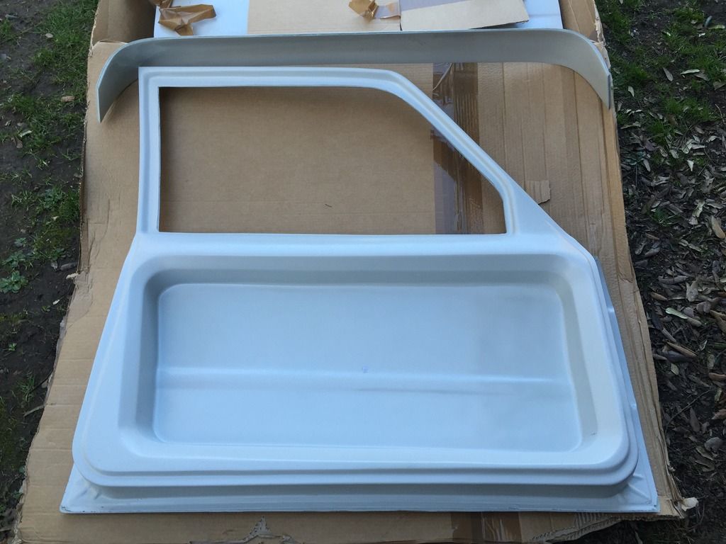

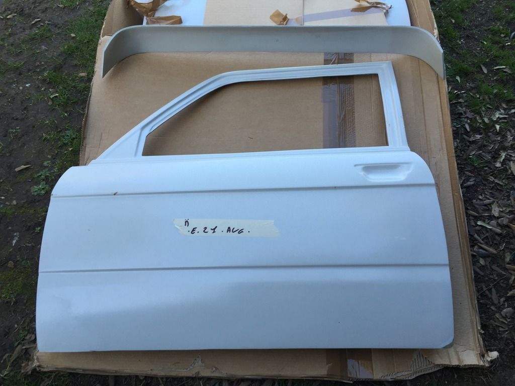

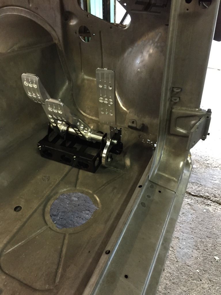

Got some new parts:
Doors and Roof Hoop:
Pedal box setup:

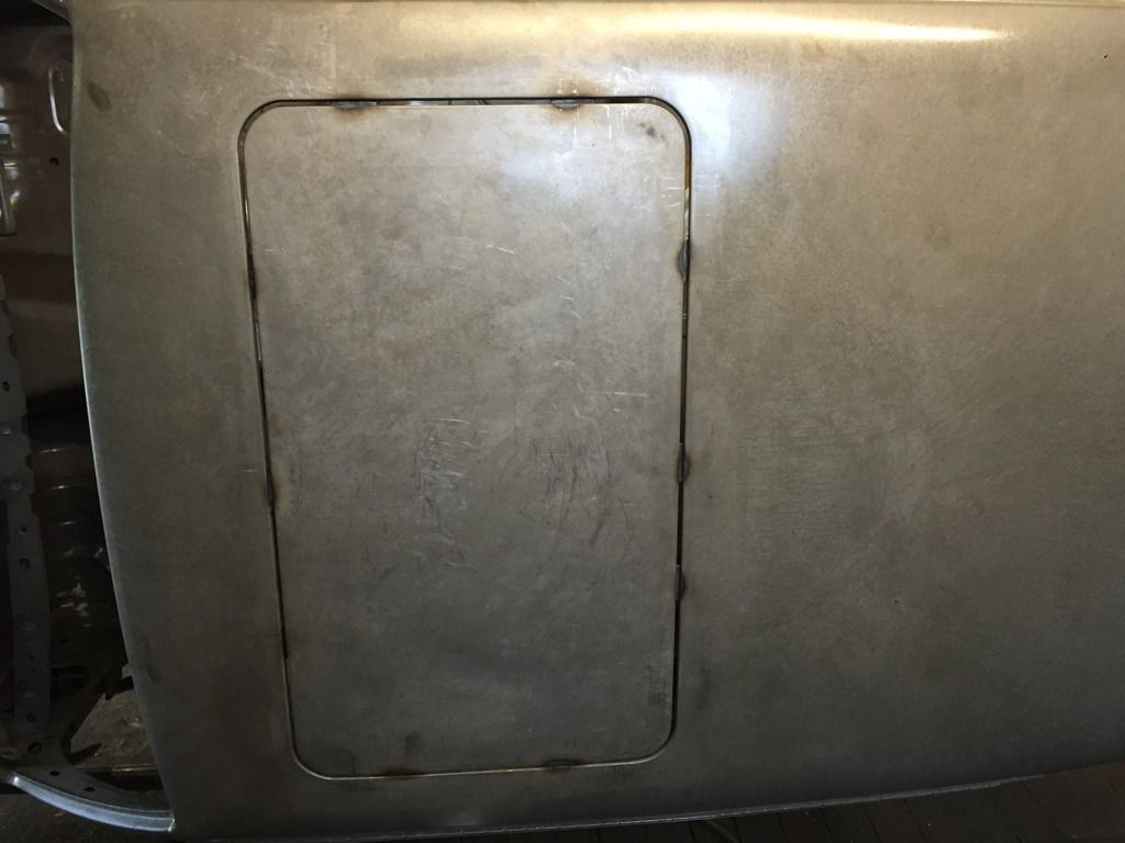

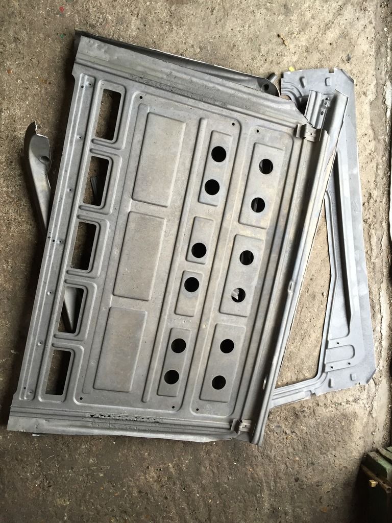

Also made a start removing the sunroof cage and welding in the roof panel:
Regards
Ben

Posts: 19270
Viewed all 276 pics. Looks great, some spots and holes, but all on known places. Nothing out of the ordinary, so a great base to start from!

Post by pandemonium001 »
Super clean, :thumbsup
I would love to repair and just clearcoat it as it is.
Lars-Nord
Posts: 535
Location: Norway
Post by Lars-Nord »
That looks great. Even i could have made that chassi good again. Love to follow the this tread. Good luck with it.
