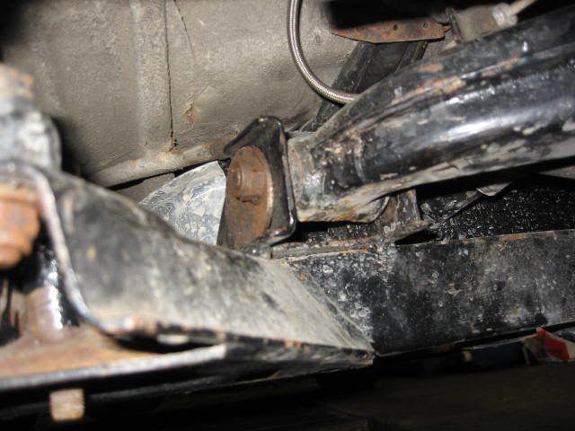

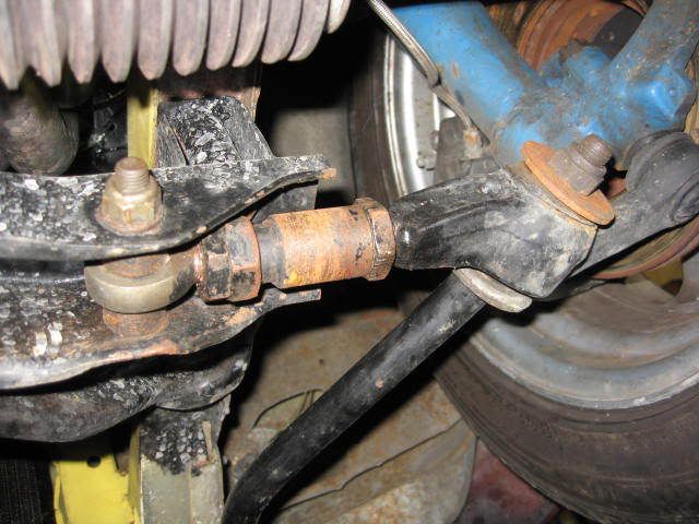

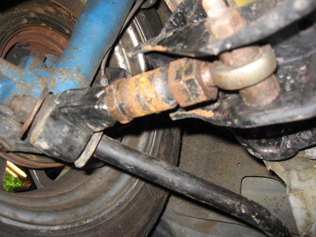

Here are some Adjustable TCA pics
And the adjustable rear wishbones

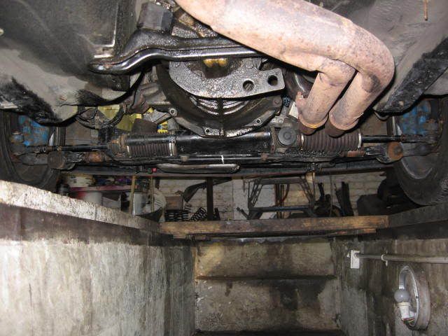

Don't know if you can identify the rack from pics but here is one.

Hi Duracel79,
Im more familiar with wishbone suspension design than macpherson, can you tell me what the purpose of adjustable tca's are? is it just to adjust the track, or is there more too it? it seems like alot of hassel to build, then wouldn't be easy to adjust (ie do you have to also adjust the tierods to re-set the toe?)
with the rear adjustment, is it to adjust camber only?
cheers

The front TCA's adjust for front camber, but yes the track will increase with the more camber you run. With this setup I can get about 3 degrees of negative with standard top mounts. The Toe still needs to be set by the Tie rods attached to the rack. When you adjust the camber teh toe needs to be reset as well. I go between 2.5 degrees and toe out for racing and 1 degree and parallel for the road.
The rear adjustment is just for camber, for toe adjuctment at the rear you need asimilar slotted bracket and clamshell on the outer wishbone pivot. This would need to be slotted horizontally rather than vertically like the one shown.

As for the TCA's, I don't know where mine came from as they were on the car when I bought it. They do work quite well but take a bit of time to setup. Difficult without a pit and with the car weight on them. I'm thinking of adjustable Top mounts to make the changes easier.
Jason323i, I seem to recall reading that you had some, Where did they come from? and what sort of price range are they? Do they need the toe adjusting every time the camber is moved with them?

Once set up they should not move if you use the jam nuts. but i am in the procces of becoming a ground control supplier for the UK so i can get you the tasty top mounts.
To use the escort weld in kit you need to nock up a jig and have quality welder do the work.
Also redrilling the mounting point further out and upwards helps.
