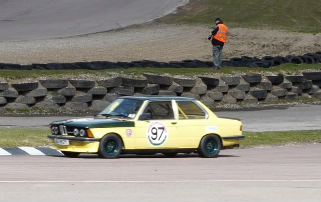

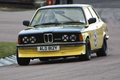

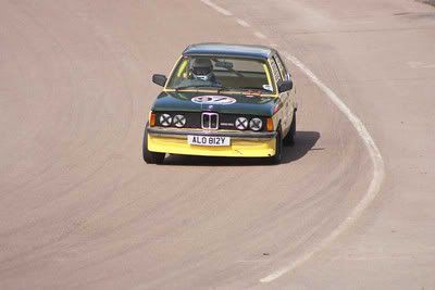

Bought my car part converted to a race car about 1.5 years ago. Finally got it all finished this year for my first race with it in April.
Here are a few pics.

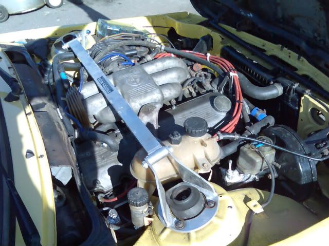

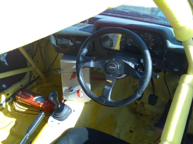

Its gto a 2.3 M20 engine running on K-Jet. Fritz manifold, Homemade Stainless System, Heavily ported 731 head with 300 deg cam, E30 gearbox. all lightened and balanced. Leda coilovers, Quick rack, Full cage, Extinguisher system, braided brake lines, race brake fluid, yellowstuff pads, Dunlop D83J Tyres on Compomotive wheels.

How did you sort the speedo out with the E30 gearbox?
Duracel79
Posts: 817
Post by Duracel79 »
No speedo mate, Just use satnav on the road.

Ditch the servo save weight and run a pedal box.

Duracel79 wrote: The car has modified TCA's for the front and Camshell slotted inner wishbone mounts at the rear.
this sounds interesting, can u please elaborate and/or post photos.

I should be able to get some pics from under the car this weekend.
I'll post them next week.

No idea where the rack came from, most of the major bits were already on the car when I bought it. The rack still utilises a damper so looks stock but is only 2.5 turns lock to lock.

Brakes are standard, apart from being aluminium Alfa SZ Brembo calipers up front and W&N drilled discs. I sourced the pads through Fritz Bitz along with both Of my Strut braces and the exhaust manifold.
