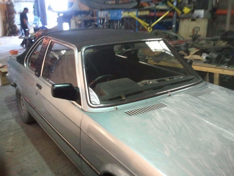

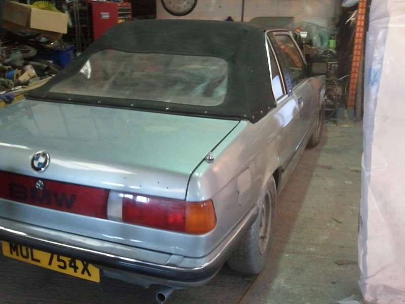

It now looks like a car, needs a bit of touching up to the paint and proper cleaning.
Bare shell was actually two years ago - I suspect I will win a worlds slowest restorer even though a load of Mates came and helped award!
Hopefully get 5-6 hours on it tomorrow, in the home straight!
