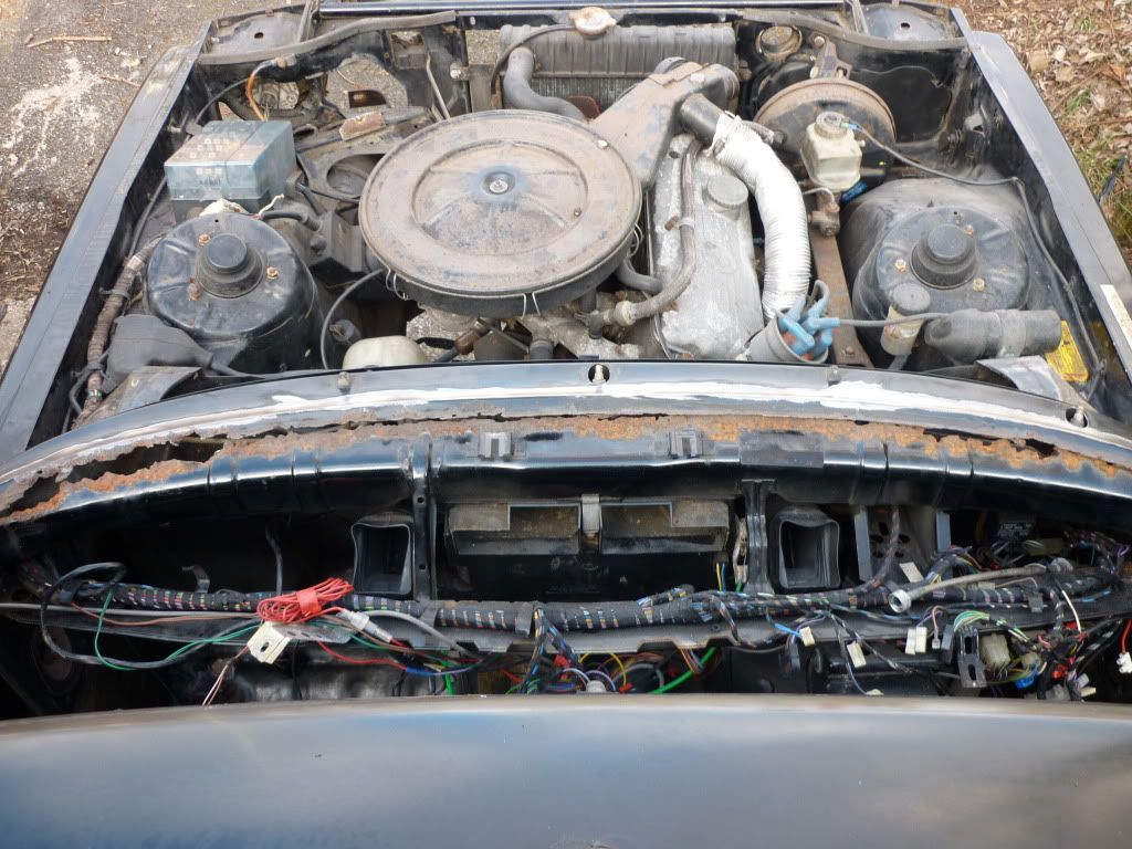

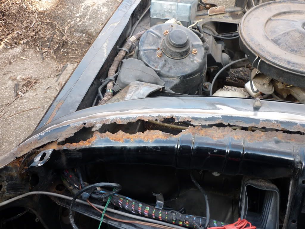

jesus, thats rusty! cutting bits from a good/better shell is your only route here.

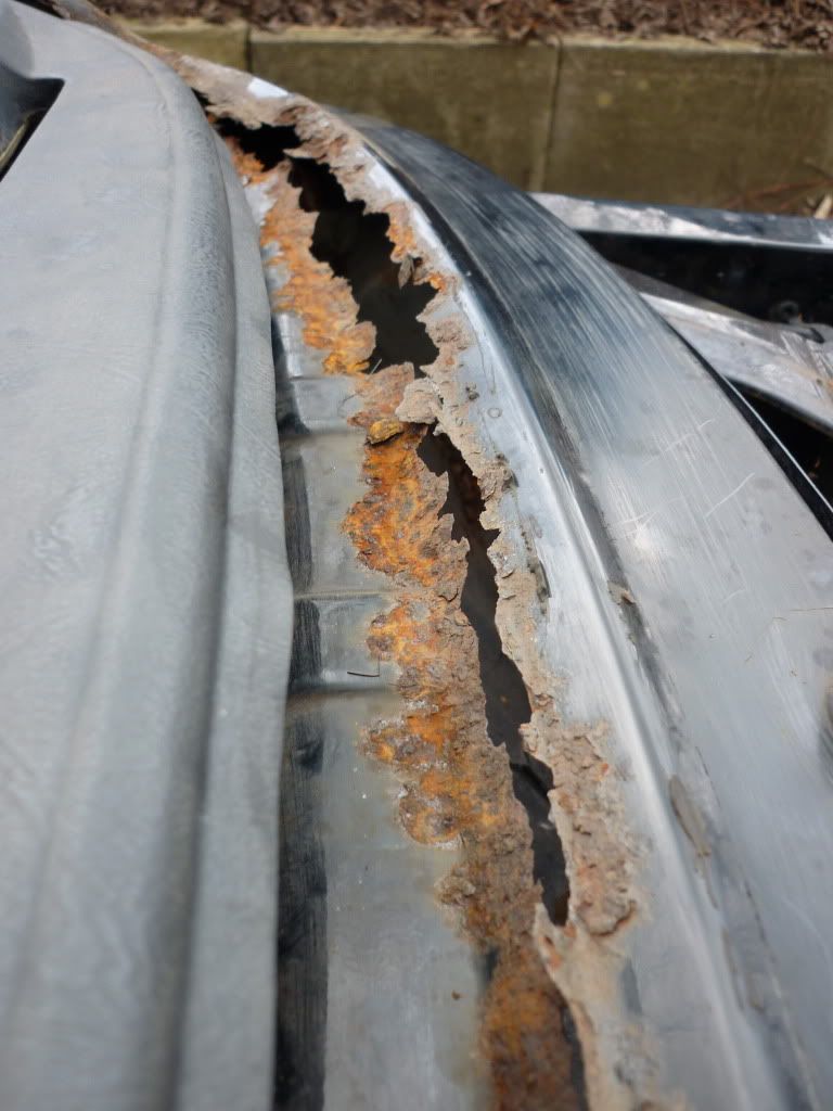

The rust in that scuttle/screen area is scary, but anything can be fixed if you want to do it. The thing most of you aren't really taking into consideration is that this was Marks car originally and he wants to bring it back to life. If he'd bought this car and was planning to restore it, the Manchester branch of the e21.net forum would go to his house and either remove it or him. However it was his pride and joy once and hopefully will be once again.
I bodged together a patch for a smaller hole in the slugs windscreen surround which still leaks now, but as a track car it's not really an issue. For this project it would be though.
Jacko and I have bought an e24 to break, the screen base should be a very similar shape - assuming it isn't rusty you could cut that out of the e24 and modify it to fit the E21. Would be easier than starting with a flat piece of sheet steel and wondering how to make it the right shape.

Wow, I've never seen scuttle rust that bad on an E21 like, ever! What a shame I never had anywhere to store my scuttle when I broke my red car as I would have let you have that, but hey who knew? Depending on if you're a whizz at fabbing panels or can get hold of a scabby shell to scavenge, it'd still well worth doing - I've seen much, much worse saved...
