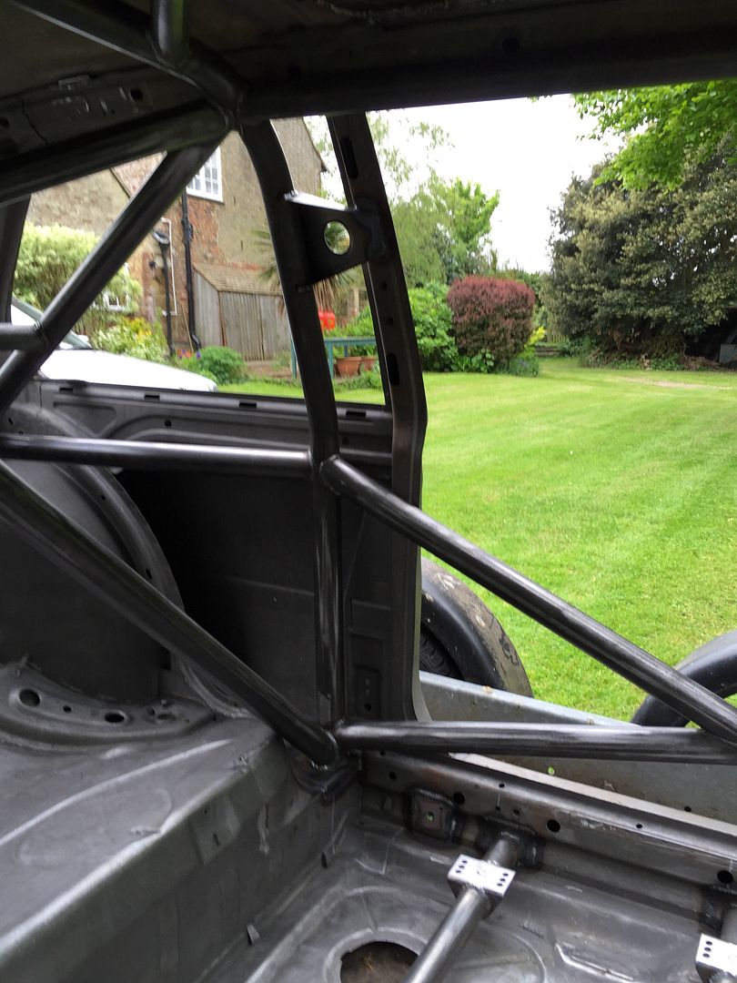

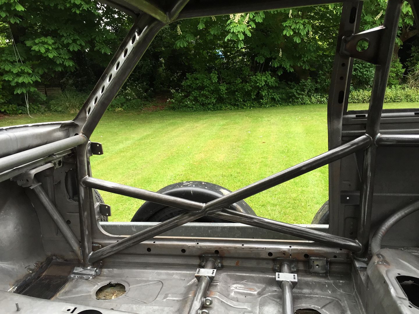

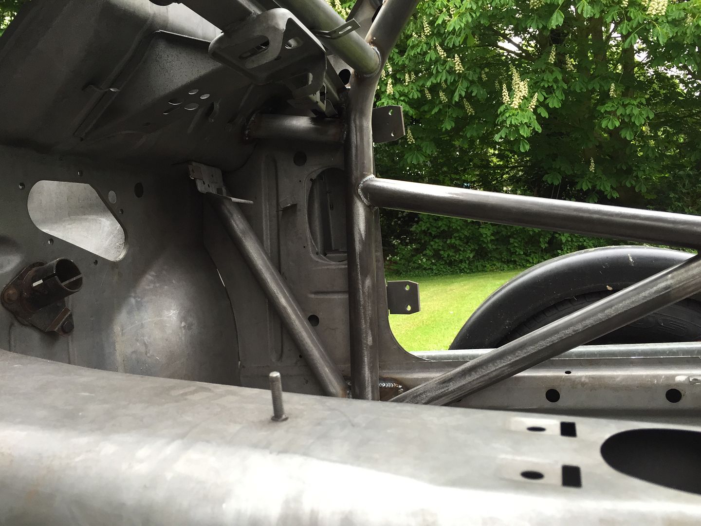

It is now away again having the roll cage fitted which will include:
Full 6 point weld in cage to MSA specs
Extras:
Gusseted to A & B posts
Roof bar
Dash bar
Front strut triangulation
Differential bracing
Harness bars
Driver & passenger seat bars with harness mounts
Should be ready sometime next week, pics to follow.

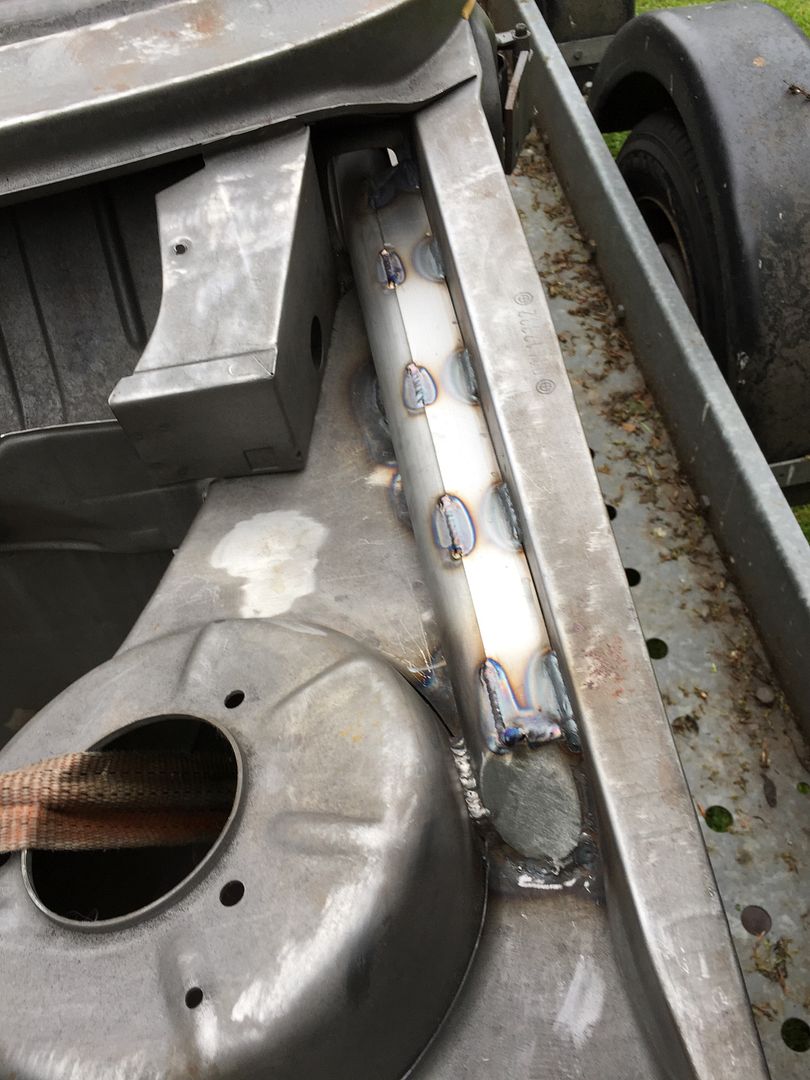

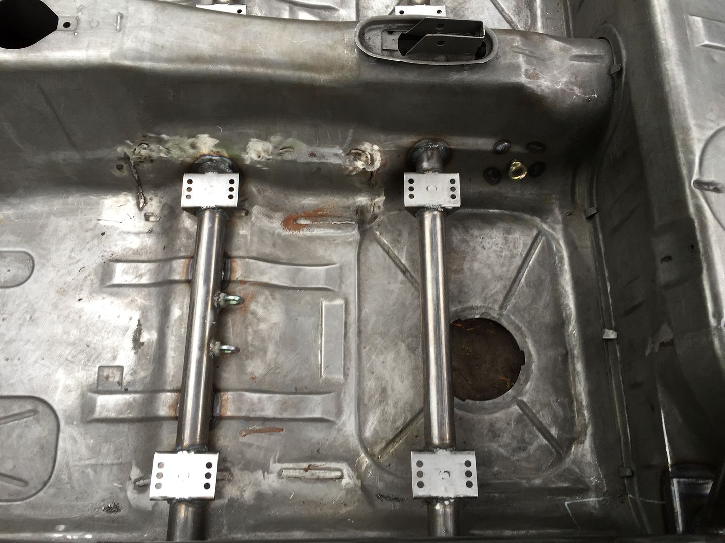

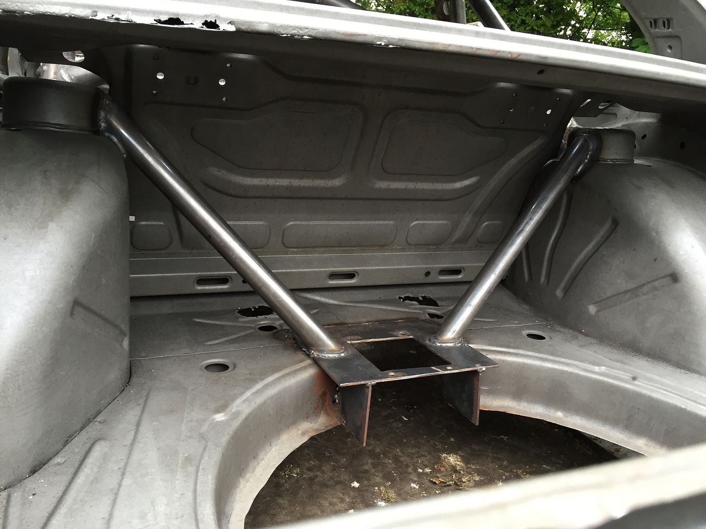

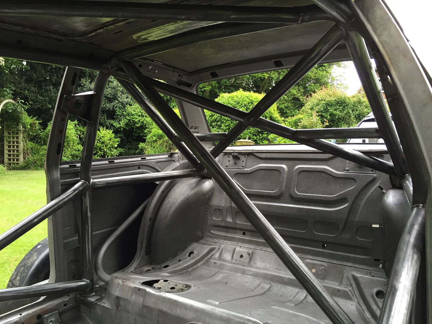

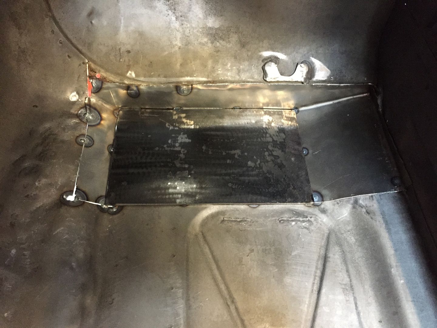

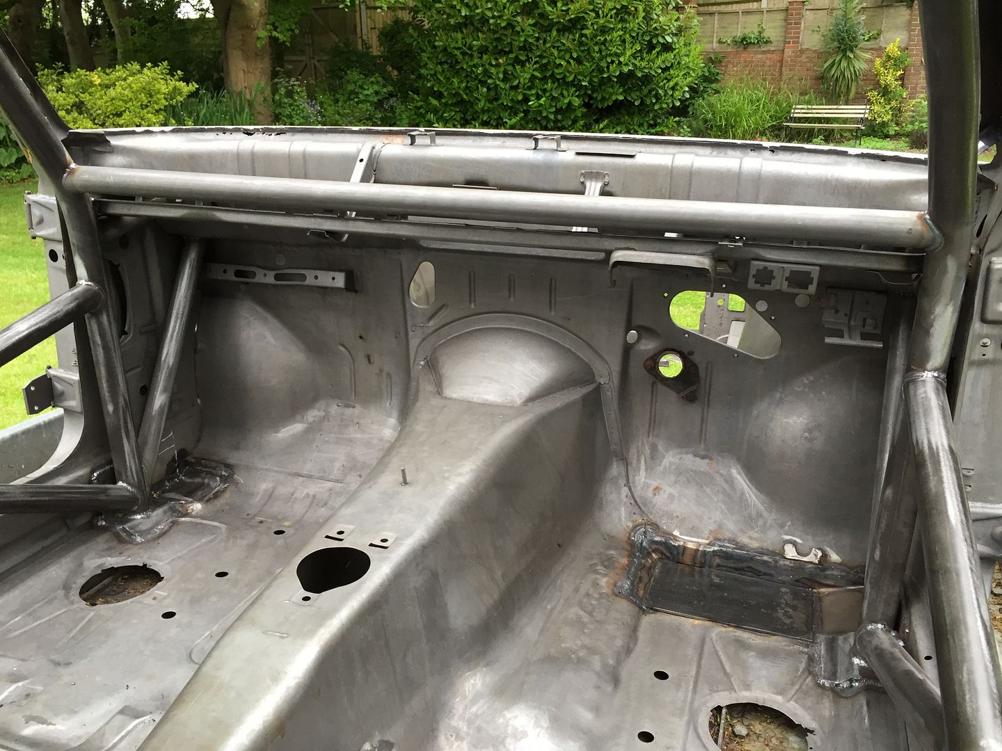

Some progress.
Modified floor to take the pedal box. Lowered and moved forward. This is just tacked in before being fully welded:
And the bigger progress - the shell now has a strong cage:
And some proper seat mountings and six point harnesses:
Few more pics in the photobucket library if your interested.
Cheers
Ben
