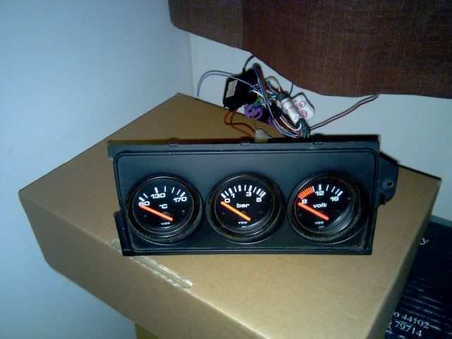

--ALPINA-- wrote:I havent connected the oil temp cos the temp sender is the oil sump plug, and when i next do the oil change and fit a mocal cooler i will then connect it, the wiring has been done, just needs to fit the plug and fit wire. :lol: when the temp is connected with out the sender it reads at full as you see in the picture....
my engine is very healthy like a dog with a wet nose, no over heating and over gauging.

hey good ideas here. im going to fit mine in the cubby hole in front of the gearstick. i actually have had the gauges below since 2001 i found them in the shed a month ago. they aye from an audi 80 coupe.
Image[/list]
Still playing about with position before I drill any holes.

Mark, looks good but a little thought on this.. as you only using 2 gauges why dont you fit them in the airvent like what i did, this way you wont have to be drilling holes and using the gauge pod!!! if i had 2 to fit i suppose its what i would have done!!
J
why dont you mount them in the pillars using a pillar pod??
they look a bit in the way on top of the dash like that.
