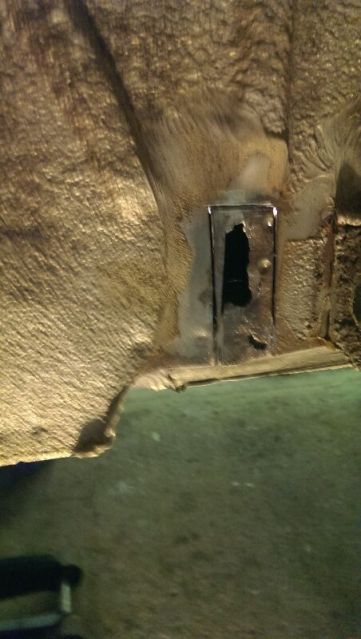

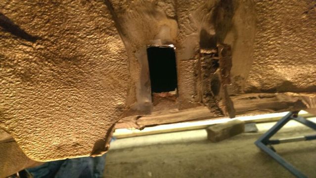

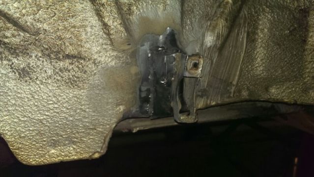

i uncovered a few rusty bits when i steam cleaned my car theres nothing major, but a couple of little holes all the same.
this is where the fuel filler pipe goes / crosses the drivers rear arch, porper rust trap in there.

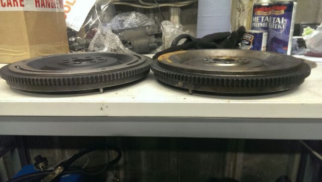

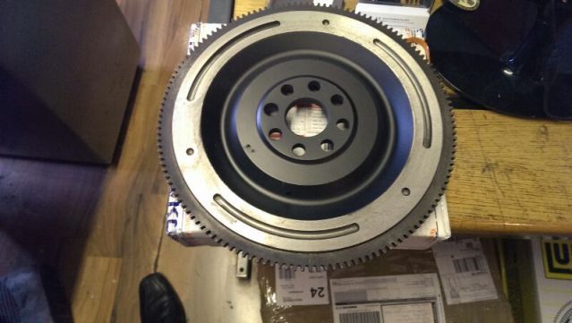

got my flywheel lightened here it is next to a stock m20 flywheel

Nice job! I love how the flywheel looks!

Some 17 year old kid apprentice at cg clutches did it. He was so young he even spoke in txt speak. He said "id av kncked it dwn furva bt rekond itd be t'weak".. he took off about 2kg off it or so its way lighter then the stock one. This is also first time ive seen a flywheel done with grooves milled in. Clever lad tbh and he gave me hope about the next generation lol. Only cost 65 to get done too.pic wrote:Nice job! I love how the flywheel looks!

£65 for the flywheel was a bargain. So what's the new weight?

I should have weighed it before i stuck it on the engine lol. Iirc he said it was 7kg? When i picked it up i nearly launched it over my head
its not as light as an alloy effort though.

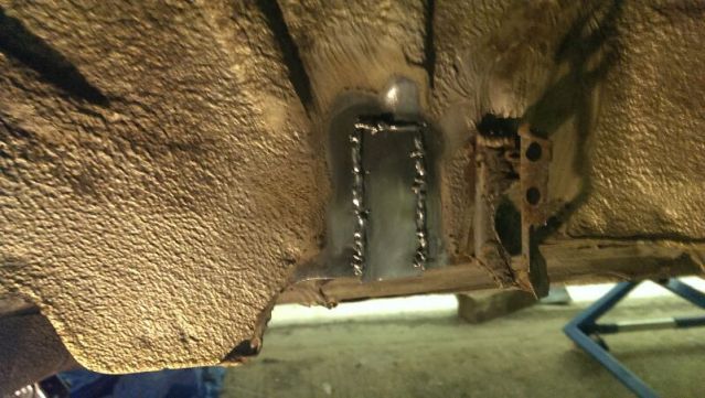

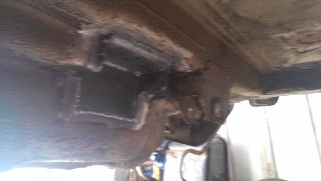

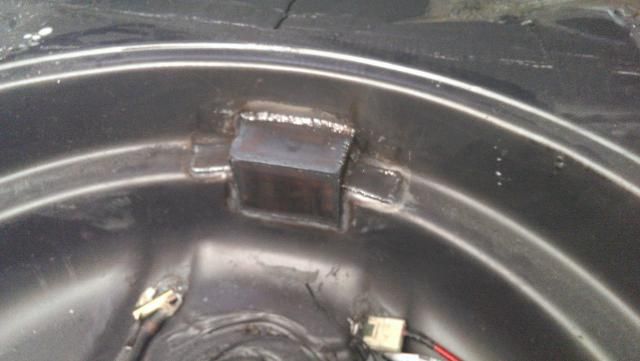

e12 diff mount done today, my pics are crap combination of bright background and a dark foreground and a complete lack of knowing how to set up my phones camera.
ill confess that I ended up paying a man to come round and do it for me as I didn't fancy making a mess of this vital job,
He used 3mm plate and then welded onto the box section underneath and welded on the inside to the double skinned area and there's a nice amount of room there now and all I need to do is make a poly mount. 20 years of welding experience beats the crap of my own welding effort tbh.

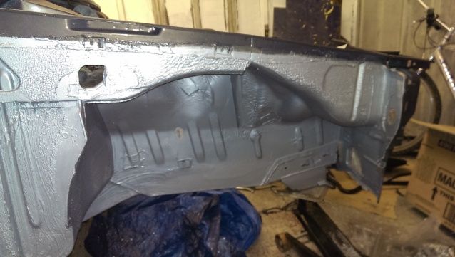

Spent most of weekend going over every inch of the underside and checking the factory sealent, any loose or rusy edges was taken back and cleaned up. Someone has used that horrible underseal that is like rubber on the wheel well.
I spent hours getting it off. I have 90% of it off just need to clean off residue. I found wire brush and a gallon of high power degreaser got it off but left the factory coat untouched.
I found a few more 5p size holes and welded them.. but now i know 100% my car is good to go for another ten year at least without any major work to the body.

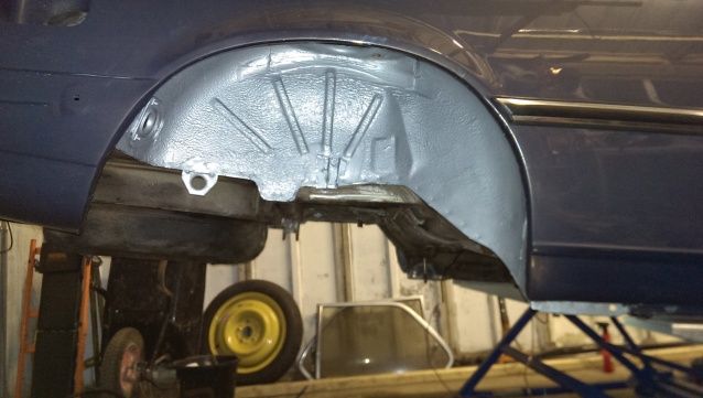

So on sunday i panel wiped and painted my arches with rust bullet very carefully! You need two coats. The first coat does the job intended and the second seals it preventing any air reaching the substrate.

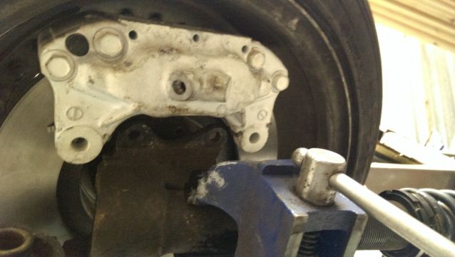

Had a v.rough mockup of my new 300mm budget brake kit. So far this job owes me £200 quid in parts. I was over the moon that it all fit under my rims.
