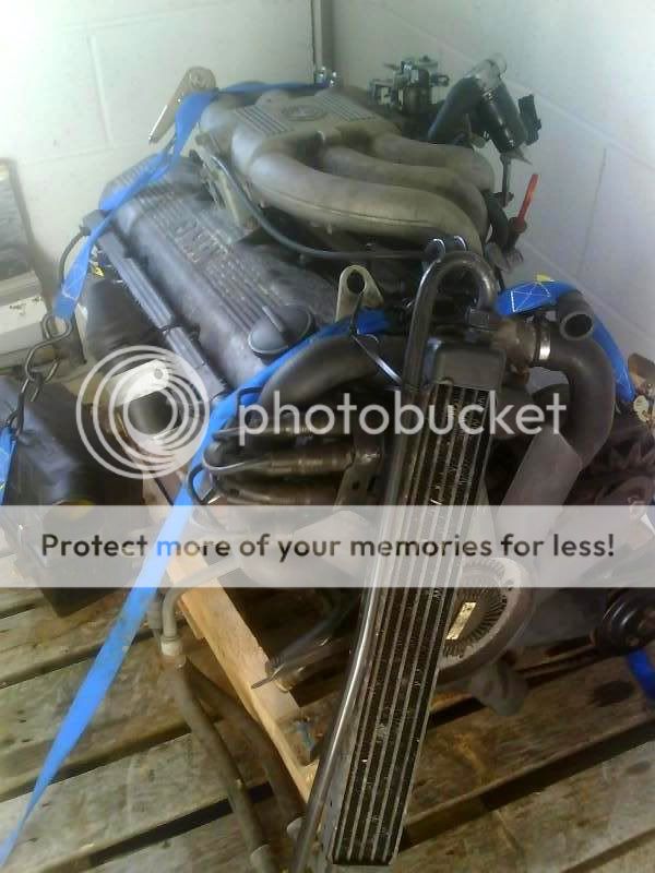

DrGonzoPOW
Posts: 990
Re: Oh No! Another 325 Conversion
Post by DrGonzoPOW »
Quick pic of the asbo
