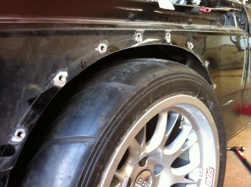

looking good jason, liking the motorsport modern style wheels, hard to pull of a 17 but done nicely

wheels and arches look the part and looks like a quality job going on . Keep spending. When you looking to be up and running with this?

where did you buy those arches?

I had the arches made but you can get cheap 2002 ones from pesch.cz
