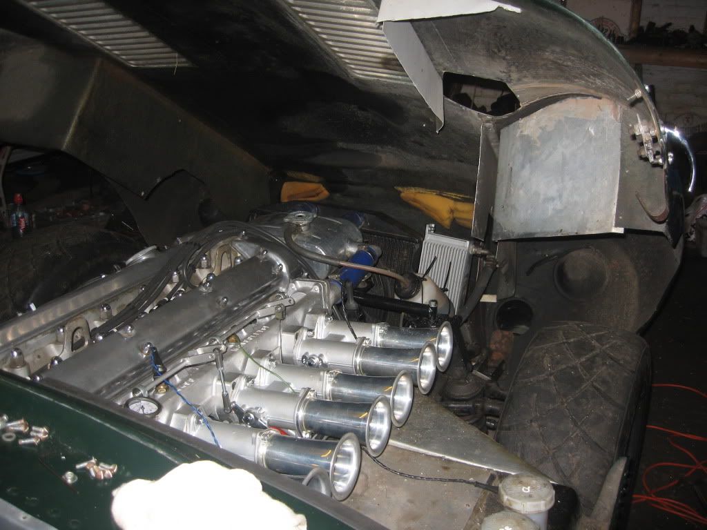

I haven't decided on the final length of my runners yet. It will be adjusted with the length of silicon tube I go for.
General rule of thumb is the shorter the runner the more power higher up the rev range. And the longer the runner the more torque in the midrange.
However that isn't always true for different engines/cams/exhaust/head/valves etc.
We tried 3 different lengths when setting up our D-Type Jag on TB's. Didn't really make that much difference to the curves on that engine. (think it was none, 60mm, 90mm, 120mm). went for the 120mm mainly to match the cars original intake length and for the looks. Its approx 350mm from the head face to the end of the trumpets. So really 60mm trumpets only decreases the overall length by 17%.
