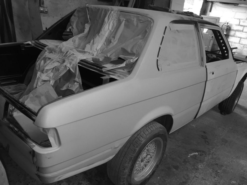

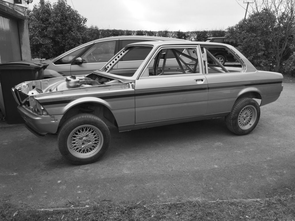

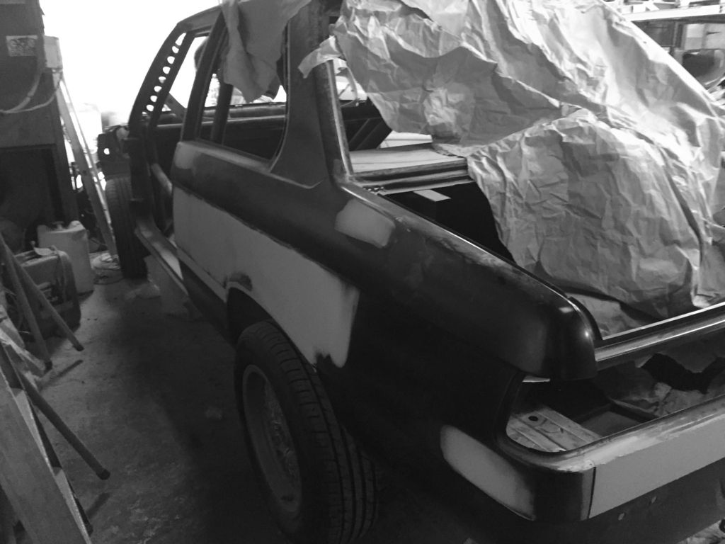

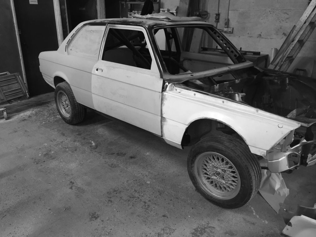

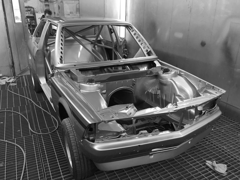

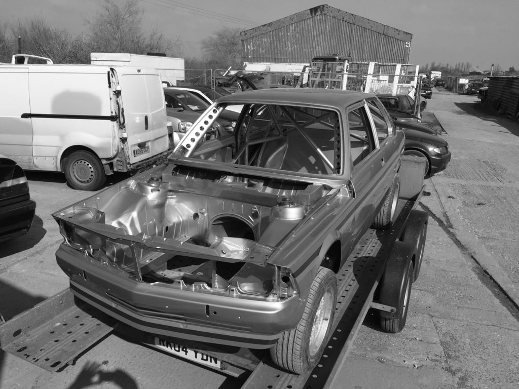

I guess its about time I updated this.
The paintshop has been taking a long time, but now we have some good progress, I'm picking the shell and doors up tomorrow and the other panels will be next week.

stripes all around?
now add some color!
now add some color!
you'll have to wait for colour, trying to keep it under wraps till May 22nd and SharknoseMihajlo wrote:stripes all around?
now add some color!
I'll add colour pics after that
Cheers
Ben

I will not go to Sharknose meeting so you can send me an e-mail in color...
my lips will be sealed!

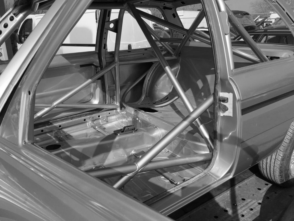

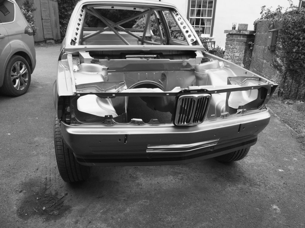

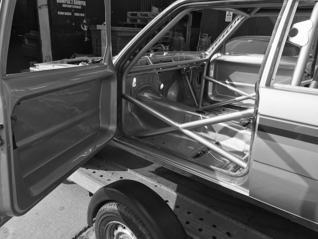

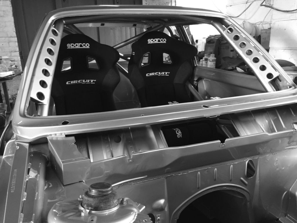

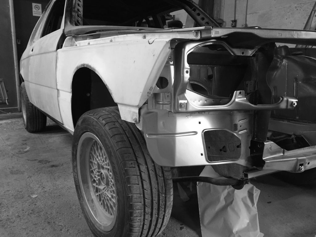

Few more pics from today:
Cheers
Ben
Cheers
Ben

Wow that looks mint. cant wait to see the colour

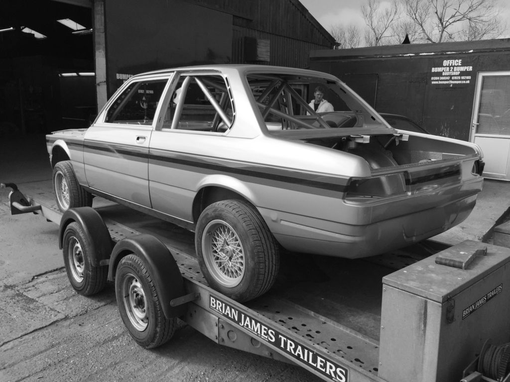

Thanks Jim, that is one of your bent front panels on there as well. Came out quite good even though it will be covered by the Zender front.

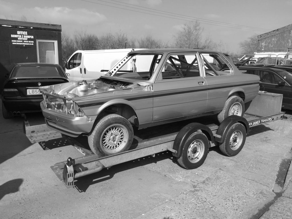

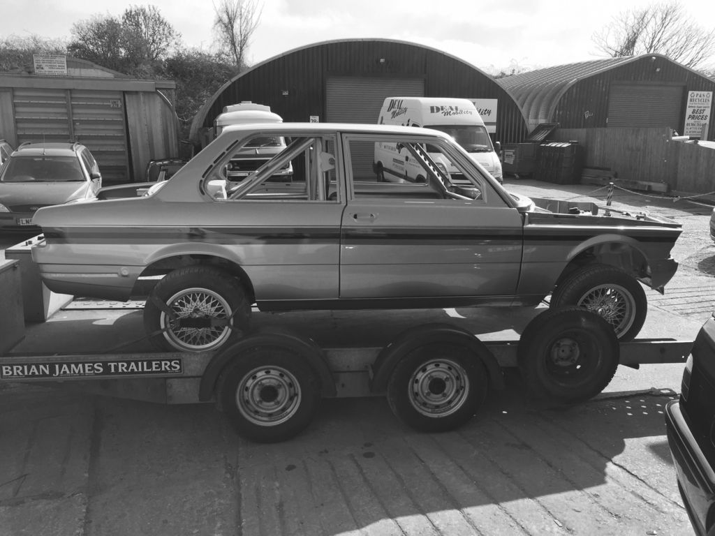

I'm still going to try and keep the colour under wraps (greys) until Sharknose, and hope it doesn't get spotted when trailering to the exhaust shop and for mapping.
I'm pleased with how it has turned out, nice a shiny with the stripes painted on under the laquer (no vinyl in sight).
Now comes the hard work of trying to piece it all back together.
Ben
Ben
