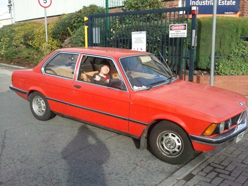

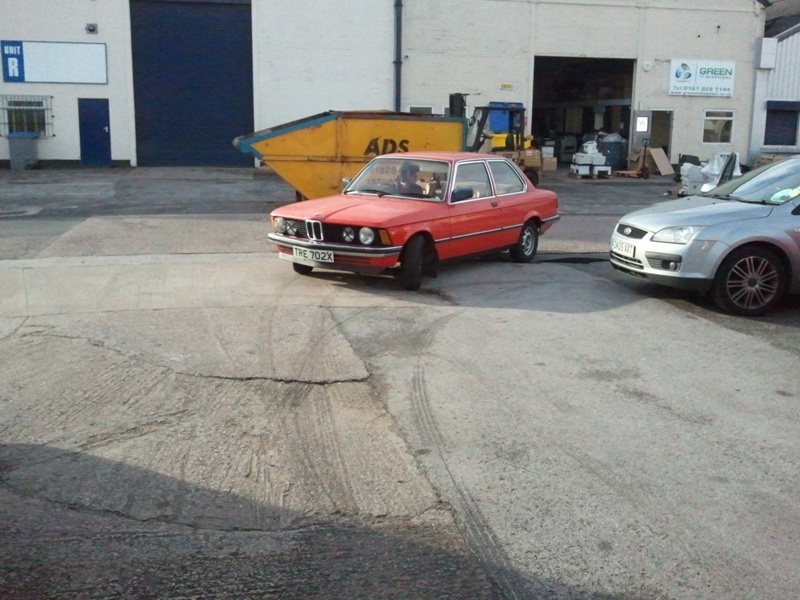

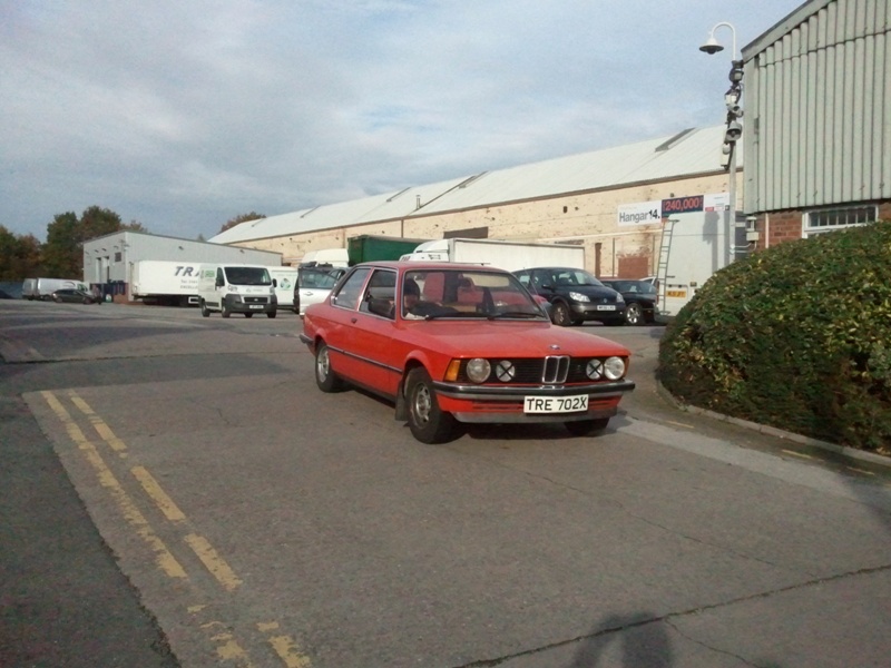

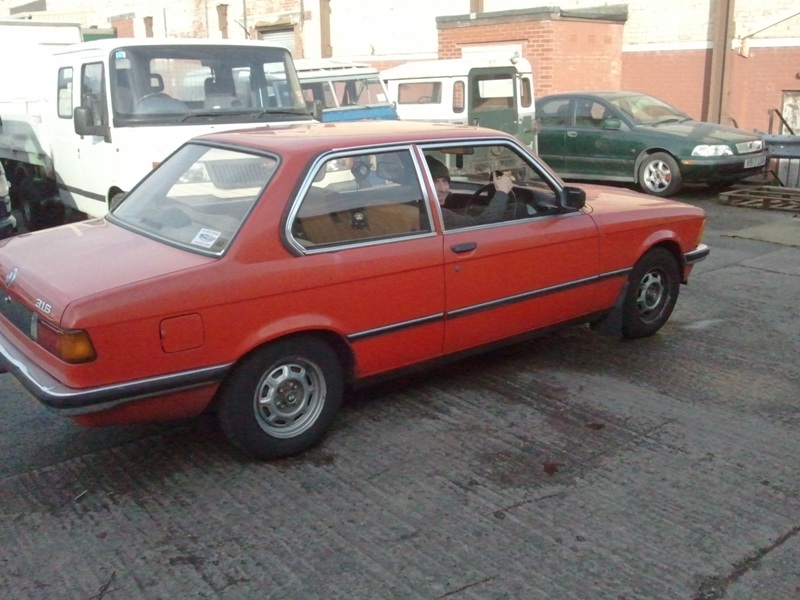

Well it works. Marks Rad got damaged by the couriers so a swift bit of fettling and epoxy puttying sorted it.
Question is did it reach Middleton safely, and how did the MOT go???

Congratulations! Good to see a bit of forum unity has paid off with another e21 back on the road!
