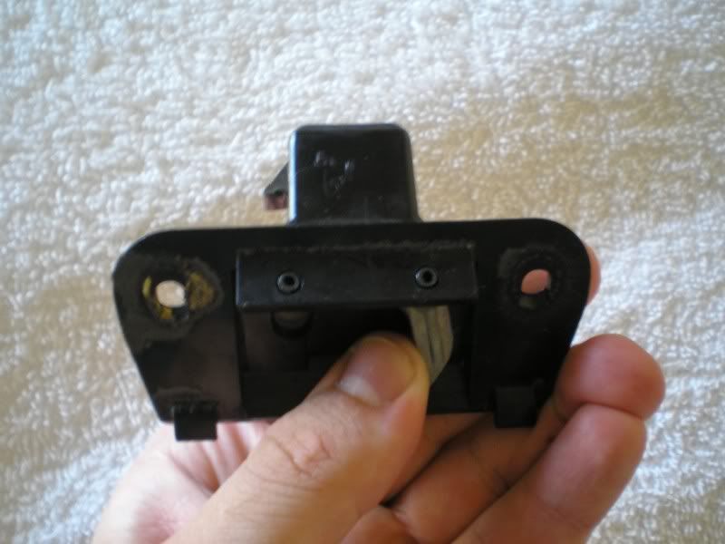

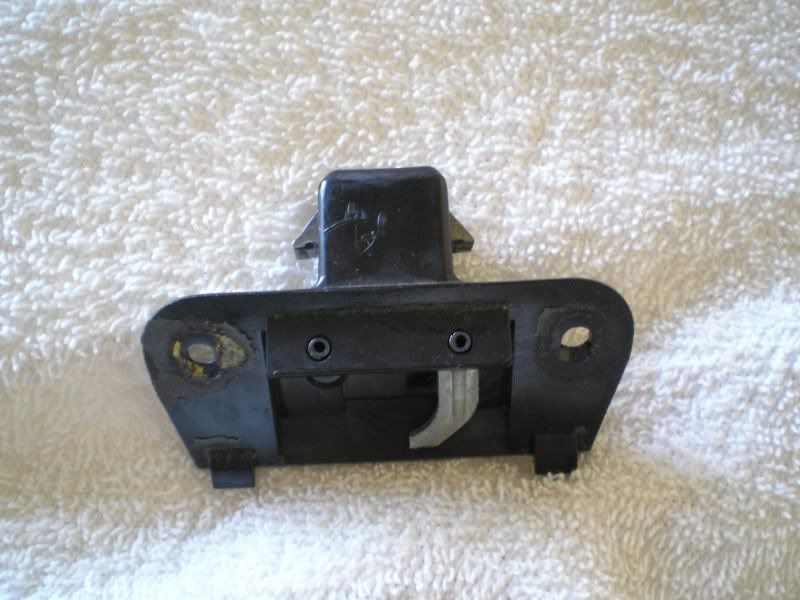

Thank you, at the end I solved the problem following your indications.
The problem was that one metal piece was broken.
I took some pictures.

My glove box is stuck closed today too, ill be heading up to the garage today and trying that unstewing option. Fingers crossed it works and thanks for saving me creating a new thread!
Posts: 29994
Re: I can't open the glove box
Yup, undo the screws at the back of the glovebox, then the box will drop enabling you to either pry it open or undo the two screws of the metal strip the lock goes into. Usually you can reach those as well. In both cases you'll be able to remove the glovebox without too much hassle, and without damage.

Only thing is you really have to get your head right in the back to get the three back bolts then the one on the swing arm. Then I reached in with a pliers to undo the lock as the little latch had snapped off the opening mechanism! These threads are a great resource! Have to search the breakers for a new one now. Will an e30 lock work? There seems to be alot more of them around Ireland than e21's
Posts: 29994
Great! That latch breaking is the cause of 99% of the failures. Good you were able to open it up again, and as an alternative I believe undoing the two phillips screws holding the metal bracket (the one the latch goes into) works as well. Haven't had a failing glovebox for ages (knocking on wood) but I believe that's how I used to open them.
