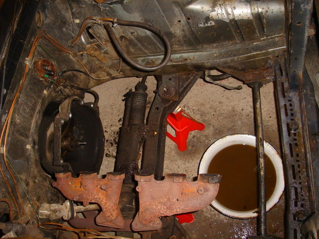

Obviously the subframes are similar, the 4cyl has the big horn mount as mentioned. The 6cyl has some slightly raised platforms instead. I've cut the horn off my 4cyl subframe to make custom engine mounts for my M42 and M50 conversions. The 6 cyl subframes are common enough to find and are easy to swap in, which would save messing around with custom mounts.
4cyl subframe
When I cut the horn off...
Mount today...
Gone tomorrow
4cyl subframe
Mount today...
Gone tomorrow

can you put a picture with what you put instead of the m10 horn, for the 6cyl engine, and how you positioned it, because i really dont trust the welding.
Re: Question for a engine upgrade
Sorry, I used that subframe to create a custom subframe for an M50 engine rather than M20. If you're fitting an M20 I really would find the right subframe and engine mounts.
