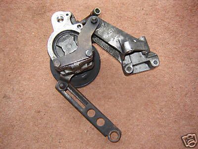

Post by mr edd »
This is what a e21/m10 power steering pump and bracket looks like ..you could use a pump and bracket off a e30 m10 but you would have to change the connection on the hose from the pump to the rack..either way you will have to fit a tripple pulley to the front of you engine in place of the single pulley normally fitted ..edd..

Post by Jazziat »
you can also use the pump of E-28 ... i think it should fit with its original brackets ... maybe some minor modifications could help .... i have done this with my E-21 when i destroyed my power steering pump ... i got an E-28 one ;)
