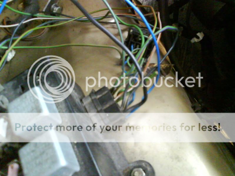

The E30 loom does'nt plug into the E21 fuse box mate.
Theres a male plug on the end of the E30 loom that connects to a female plug. If you look at the first pic with the white connector blocks on you can see it. That would normally then go to the E30 fuse box, but what you need to do is just cut it off a few inches from the plug then seperate the wires. Then its just a case of matching the colours to a guide. Murrans is the best one to use for that.
If you dont have the male and female plug ends you can just strip it before the connection if that makes sense ?
.....or do you mean you just dont have the E21 loom that plugs into the fuse box ??
